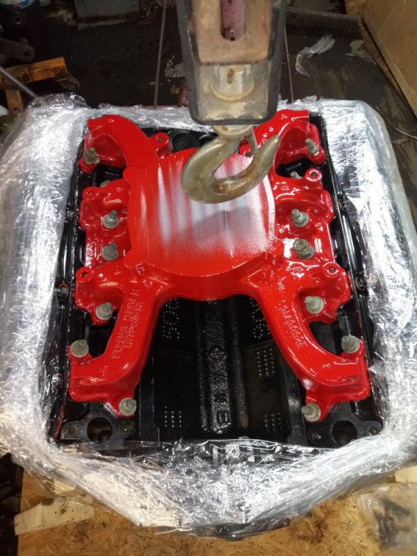

your going to have to do some modification no matter what with a centermount engine going into a truck

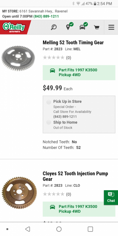

What about the melling one?
Also this engine was a center mount turbo setup am i going to be able to use my intake?
I see in pics they blocked the turbo oil holes with a plate. Did Ted's say what heads are on this engine? As long as you told them side mount pickup IMO you should have the proper heads. Test fit the manifold with a couple bolts would let you be sure.

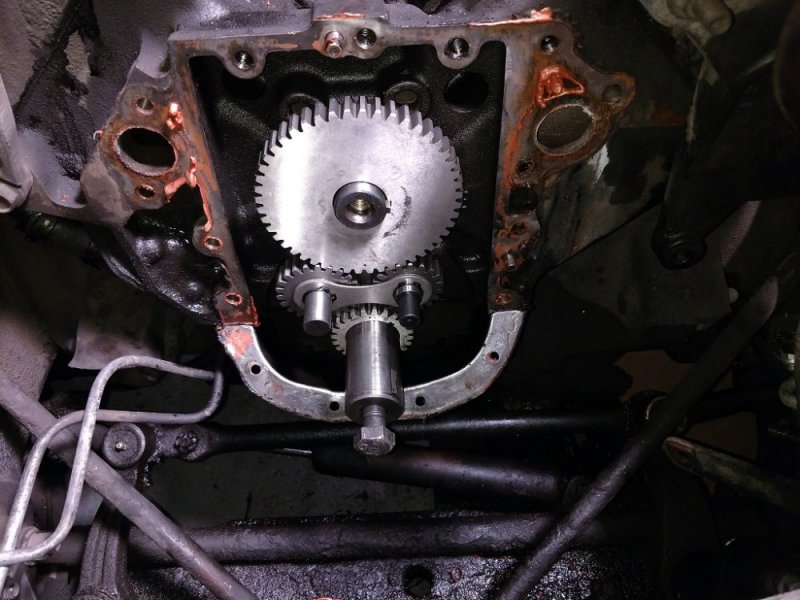

Stick with what you have or use the "best known" that is a gearset. Chains simply can not handle the shock load from the IP injection events. Any brand stretches out. Carryover from the Olds 5.7 Diesel and early 6.2 in late 70's early 80's where emissions life was 50K miles and vehicle life was expected 100K tops. Tune ups were common back then. So GM beancounters went cheap and used a chain instead of a gear set like most other diesels did - except 4 banger diesel VW Rabbits that used belts. Clearly the single roller chain didn't make it off the Olds 5.7 assembly line (testing) before failing so they had to use a more expensive double roller...

@Twisted Steel Performance lovely i have no clue how to do thatBasically truck motors have 90* intake bolt holes, center mount heads have 60* bolt holes...
You can shade tree the truck intake holes to make due....
Your golden. No worries with that intake. LOoks like they used truck heads on centermount block. All good.

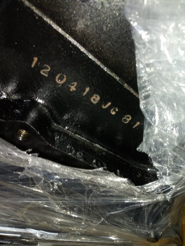

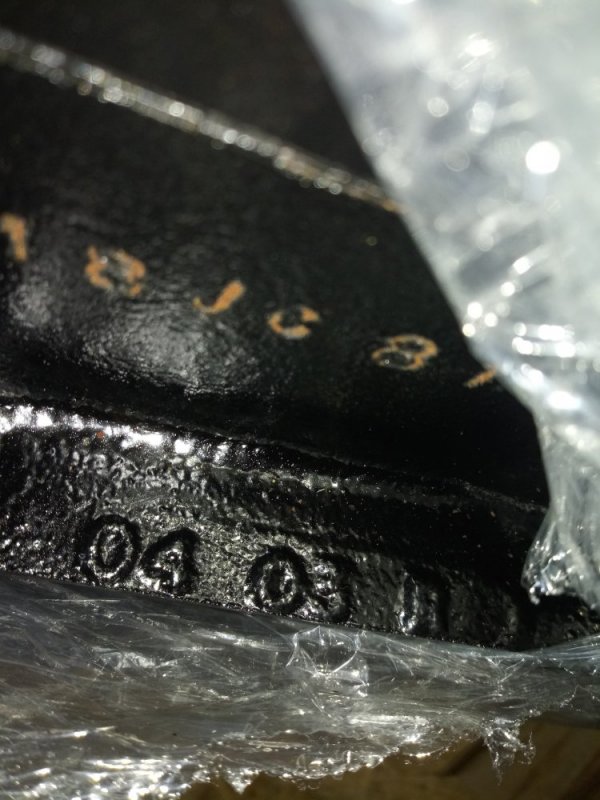

Hey- check you julian date on the block if you dont mind. March of 99 or newer is the best GM block made for the centermount.
The melling chain is good just like cloyes- both high quality. A chain is just a poor design choice for this engine. The ford idi that ran same db2 as the gm idi. Thr ford’s ip always lasted longer. The ford had 2 advantage: 3/8” fuel inlet to the ip and they have gear drive instead of a chain. So it is arguable why the ford lasted longer- but the ford never had to have the timing reset. And when the ford ip are rebuilt, the 4 different pump builders I spoke to about it say they could see the difference in wear of the 2 and the head/rotor shows up on the chain.
@wili L. i dont mean to be talking about the timing chain i was meaning the injection pump drive gear i have the cam drive gear on the engine i was wondering if i could get a cloyes or a melling drive gear for the injection pump or do i need a new set
Yea id like to use two new ones but can only find the one and heard ss diesel isnt worth itIf you are missing the gear and don't want to use the one off your old one then yes buy one. If you're a purist and don't want to use an new gear against another old gear that haven't worn together, then buy both.
Im not sure yet i just know it has 214 thousand on it lol it it looks good ill reuse the old one and get the paint off the one on the new engineThese normally do not wear esp. on a low mile military surplus take out. Save you some coin here. What did your old IP gear look like: unless it ate some debris it will be fine. You will be into the chain before the IP gear wears.
Good news on the intake! Glad you were able to solve that question today.
