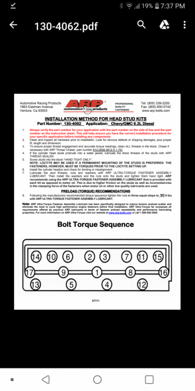

Ive never had a issue with the arp thread sealer? I dont know the torque settings on the arp studs i here its 30 60 90 but that well over 110 ft lbs? And also i dont have the extra money to replace the studs and head gaskets

I dont know i hear arp sealer is junk ive used it on race engines with no issues? I also dont know the torque settings for the studs? Nor do i want to have to replace the studs and head gaskets. I haven't ran engine yet im waiting on some parts before i install
I've heard of guys going as high as 120 but they also started distorting the block around the bolt holes. I'm planning on going to 100 and retorqueing after it's had some heat cycles when I get around to my build

The torque is always turn them on by hand. Then using proper pattern: 1/3 final torque; 2/3 final torque, final torque. For people that like to post torque, maintain the same torque, never “bump” it up.
On high compression engines like these, I have a tendency to hit max torque for the headgaskets. Now because the mains are a known weak spot, I shoot for middle of the spec.
So you should do 30 in order. Then raise wrench to 60 and tighten in order. Then 90 in order.
Right 30 60 then 90 i mis worded that last night. To be honest id be a little worried about using locktite that last 502 i build i tryed tge locktite on the head studs and failed and went back to tge arp sealer. Ive pulled the covers off granite its no fun on how the come off if youve ever pulled tge passenger side valve cover off a crown vic 4.6 without removing fender and inner femder then you'll understand lol.
