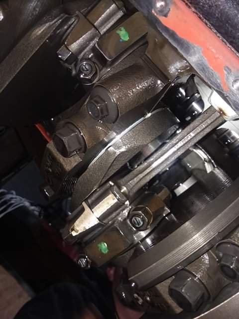

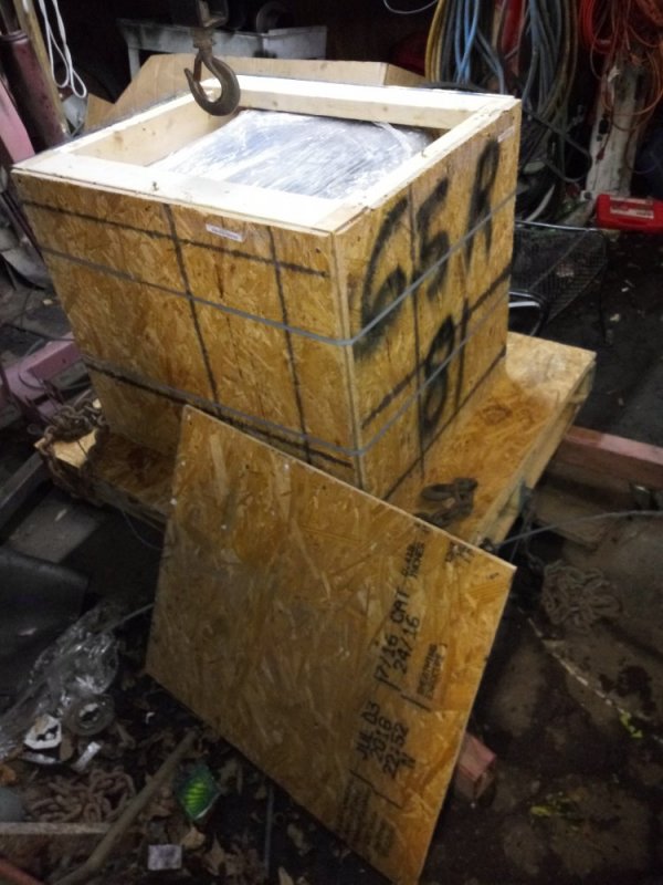

Well tore into the old engine did a leak down of all cylinders number 2 cylinder air is going into crankcase all rockers on passenger side are lose and all but 3 lifters are exploded glad i got a new motor waiting on it to come in

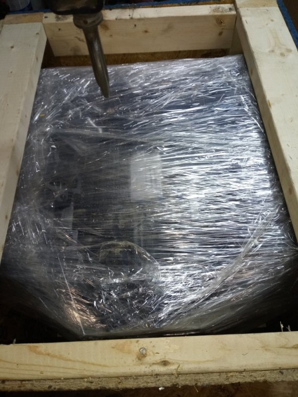

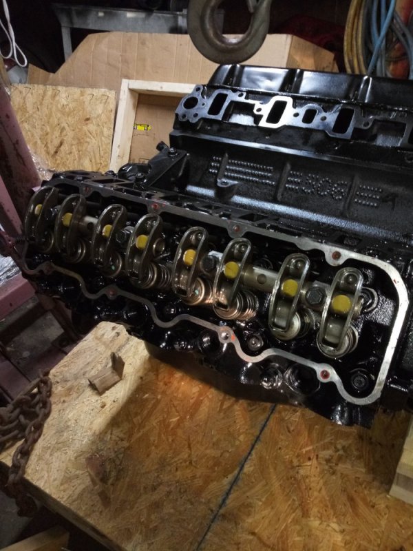

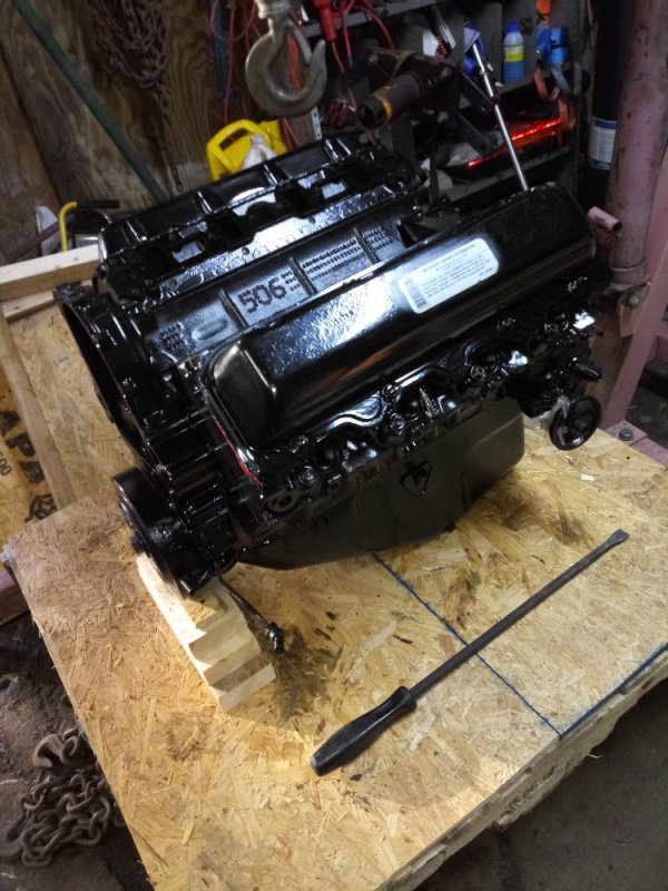

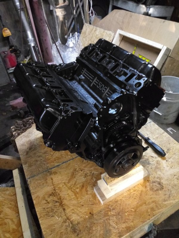

Got my teds trucks 6.5l and wow they diis a great job on it for me

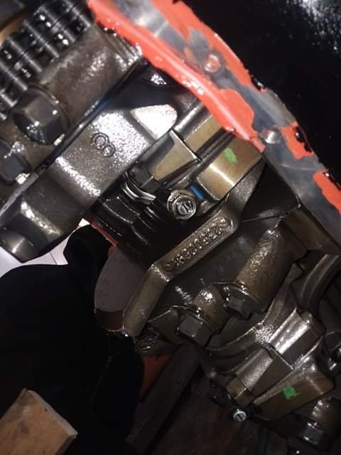

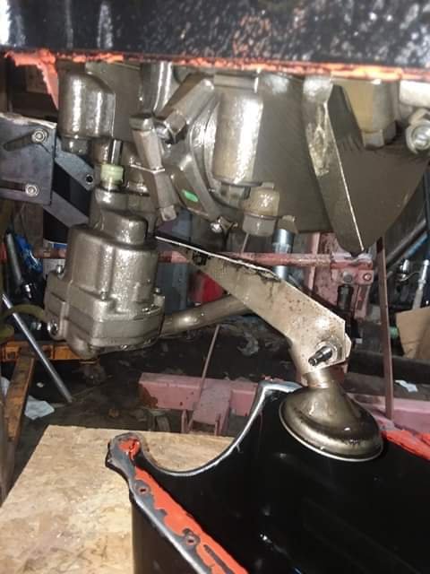

Care to elaborate on all the stuff they did for you? I know they didn't just ship you an engine... :woot:
I had them install head studs seals and gaskets. I was thinking about pulling the heads and checking cylinders for rust but idk cause it turns so smooth and from the bottom it still has the cross hatchs it also has 50 psi and idle for oil psi and 535 on cylinder compression and 2 cylinders are at 530 as you can tell it looks like this motor hasnt ever really been ran?
