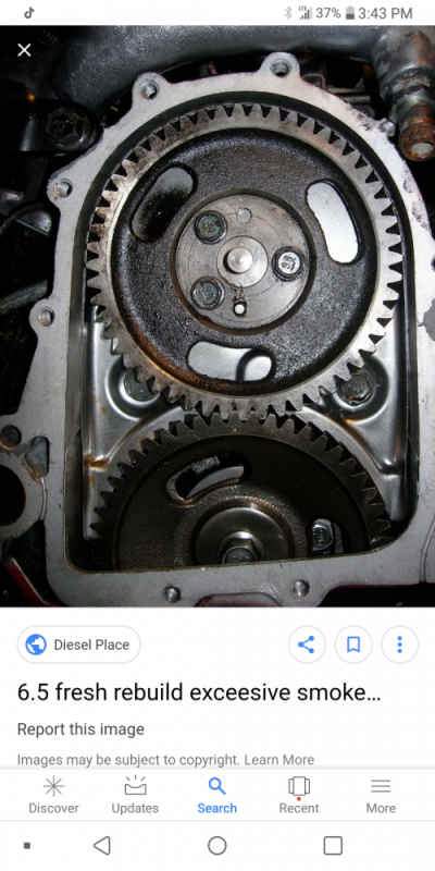

Fellas i need some help when i installed the ip drive gear the gear on the cam i had the dot at 12 o clock and when i put the ip drive gear on that dot was at 6 o clock now when i put it on the 2 dots lined up perfectly with bottom drive gear at 12 and ip gear at 6 is this correct?
Line up dots on timing chain then FORGET ABOUT IT! Line up dots on IP Gear to Cam Drive gear.
I recall the timing chain dots do not line up when the cam gear to IP does, thus time one set of marks at a time. (Pun intended.)
I didntdo thechain just the top ip drive gear and my dots lined up like this i read and heard tbis is corret
