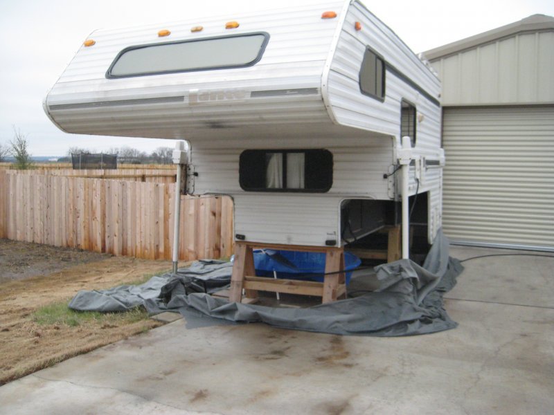

The cover finally decided to give up. The wind storm we had yesterday finally finished it off. It lasted well over 1 year. Too me, not bad since it was under construction the entire time. If I have time I might do some work to her. She is still not done. I have just not had any time or money.

Here is how the cover ended it's life. It split down the top. It is now in the trash. I will start looking for a new cover.
Those covers don't last long. Seems like I go through one every two years or so.
I wanted 1 year. I got 1 year and 3 months or so. I paid $128 for the cover. It cost me $8.50 a month to use it. Not to bad. I might try something different. I am still hunting down a good deal. I would like to pay less than $100 for my next one. If it last a year, I will be happy.
