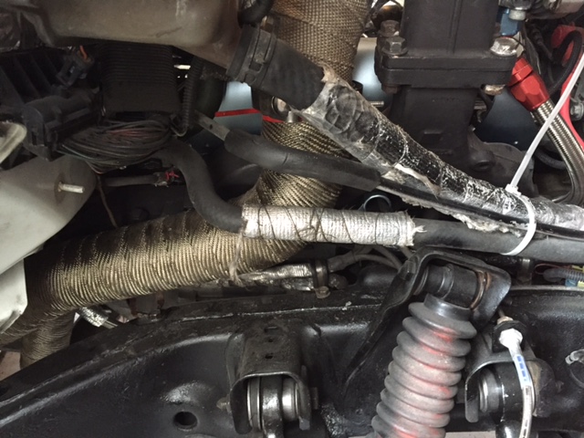

Oil pressure popped right up, dust and stuff settled, no real smoke white or otherwise, engine rattled away happily, checked the new connections for leaks:
- Slight weep at the AN to 3/8 Rubber fuel inlet so I'll open it up, add an extension, run the pump and drain the old fuel, swap in new filters and water seperator, add new and what not.
- Slight weep at the transmission Auxiliary cooler output. Tighten up the fittings, clean, no issues.
- No other weeping noted at the Turbo oil inlet or outlet or block. I'll check the block fitting another time as I failed to do that.

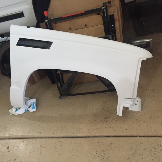

So, bolt down the cab (removed the Nerf step bars but didn't tighten everything back up).
Find the hinge for the hood...replace hood.
Reinstall the old grill for now.
Bumper on with minimal bolts.
Put the front wheels on and back it out.
Get it in the daylight, reassess the work needed vs. wanted done and get to it.
