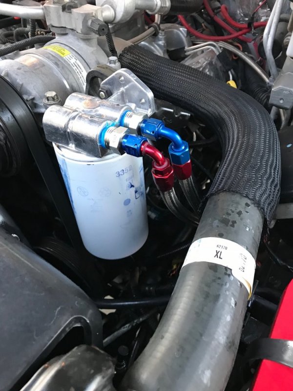

So, I R confused. Are you running the stock ffm for the 30 micron and then running a separate 2 micron after? Or just doing FTB on the backup unit that will sit on the shelf?
Just doing the FTB on the backup unit that will sit on the shelf. Me being bored...again. I didn't know if I could source all the stuff for the other filter set up locally. Moot point since I ran out of daylight running other errands. No worries, someone will need the FFM and now it is FTB ready. Who knows, I could put it on the Suburban...hmmm

Got the remote filter temporarily installed where I want it for now and the lines routed.
I figured out a better mounting bracket while I was getting it cleaned up from not having all the connections tight in order to drive out the air in the lines (yeah, if you believe that, I got a rust free Suburban to sell you).
Truck started fine. Heath HD Lift Pump puts out 10 PSI at Idle. I'll drive it tomorrow and see how it holds up under full throttle.
I talked to Pure Flow/Air Dog Tech CJ today and they're sending me a new motor and geardrive for a low low price. Seeing as how I'm not the purchaser. He said, that's a first Generation unit, we don't see many Five Digit Serial Numbers. Turns out this one was sent to Bill to run on the Land Speed Racer. One of his fired employees must have sold it to Ted when he was building having the motor build. He gave it to me as part of the deal when I bought the motor (in pieces) from him and had the thing rebuilt. Anyways, at least the Air Dog can always an option. At least it is ready to plumb into place with the fuel and electrical lines already done up.
Yes, "air bleeding". On another note, are the fittings different colors for Send and Return, or that's what you scrounged up out of the miscellaneous parts and stuff bin under the work bench?
Observed that a small puddle had formed under the LP. Both input and output sides had diesel drips formed. Pulled the pump, redid 6AN connectors on the output side, added an eight inch extension to the hose to get the pump all the way back to the mounting bracket because I had used the last of a role of braided line on the output side and it was a few inches short. When the other Fuel Filter finally gets here, it will go on the firewall instead of the AC bracket so the hose will be just right w/o the extension. I used different worm clamps on the input side (rubber for now). Filter and fittings up front was all clean and dry. Ran it for a few minutes and checked back later and no drips. Just might have got it this time.
