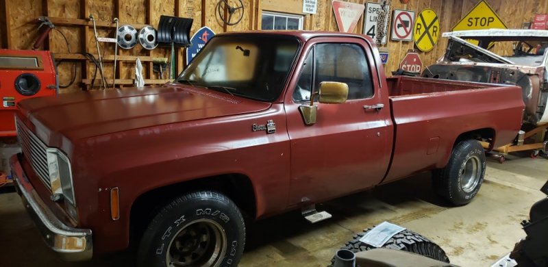

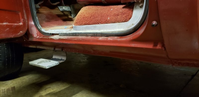

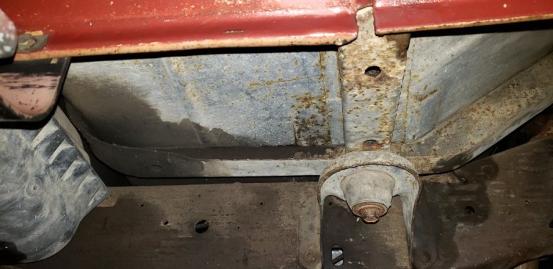

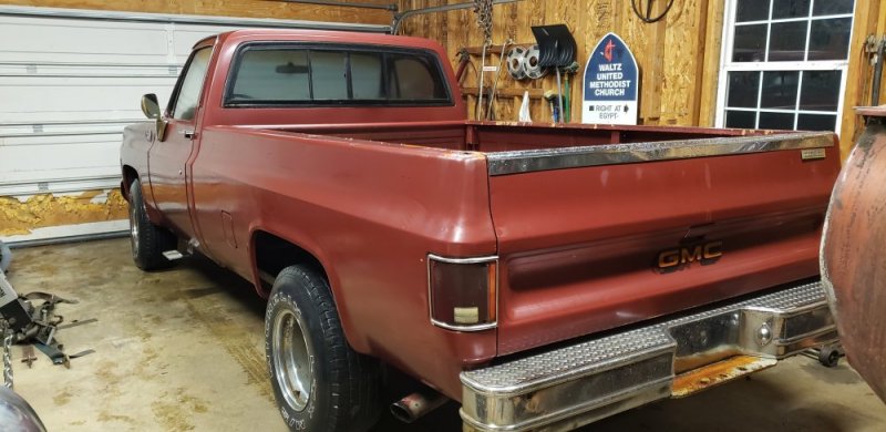

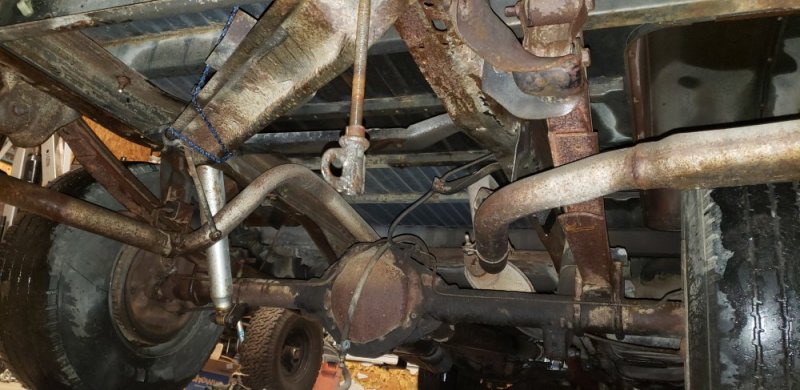

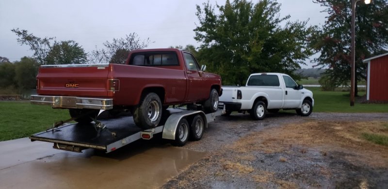

Well guys, I made a big decision and have been itching to share it with you all. I wanted to wait till I dragged it home though. I had some time to think it over and after looking at the numbers I came to a decision on the body for my truck. The cab was going to take ALOT of work to make it right and live up to the standards I have for this build. EWC offered me a free crew cab I could cut the door opening out of. Which was very awesome of him by the way. And they do make all the patch panels for the cab. But even after I fix that I need doors, fenders, inner fenders, core support, bed sides...ect. I refuse to use aftermarket body panels because of they never fit right. And the fenders and doors I have are already aftermarket so no point in patching them. I called around to a few places that have clean body panels for these trucks to get an idea what I was looking at. The time and money I would have into fixing this cab and gettin the rest of the panels I needed was not worth it. I could buy a complete clean truck for the same price and do a fraction on the body work to make it right.... so thats what I did!

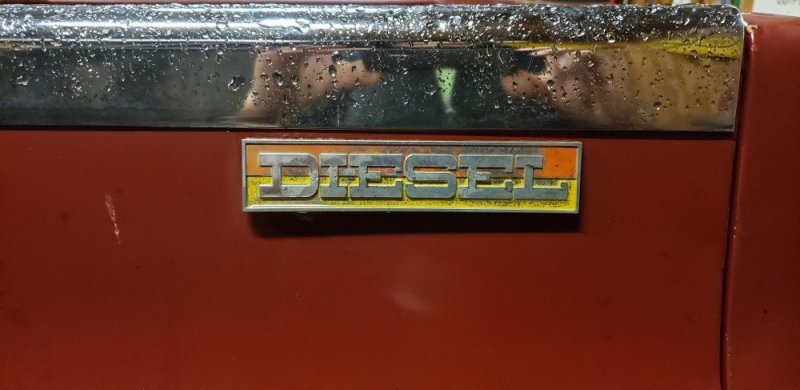

I picked up a CLEAN 1980 c15 long bed 2wd automatic truck that came from California. Its an original 5.7 diesel truck, that unfortunately was swapped out for a SBC. Both the engine and trans are bad so I got it for a killer price! It was repainted once, but I found no bondo, serious dents, or most importantly rust. This will be a perfect body to swap onto my chassis. Plus its going good save me SOOO much time. I'm really pleased with my decision.

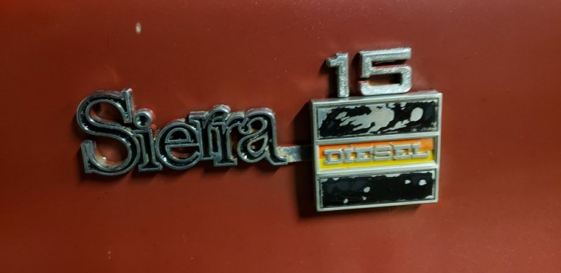

I love those old style Diesel emblems. Nice and square to fit the truck. Back when the only round things were tires and headlights!
