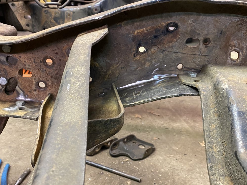

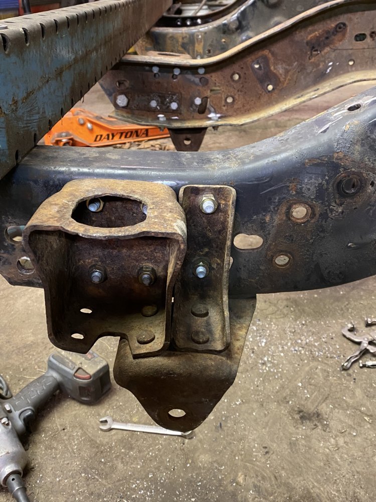

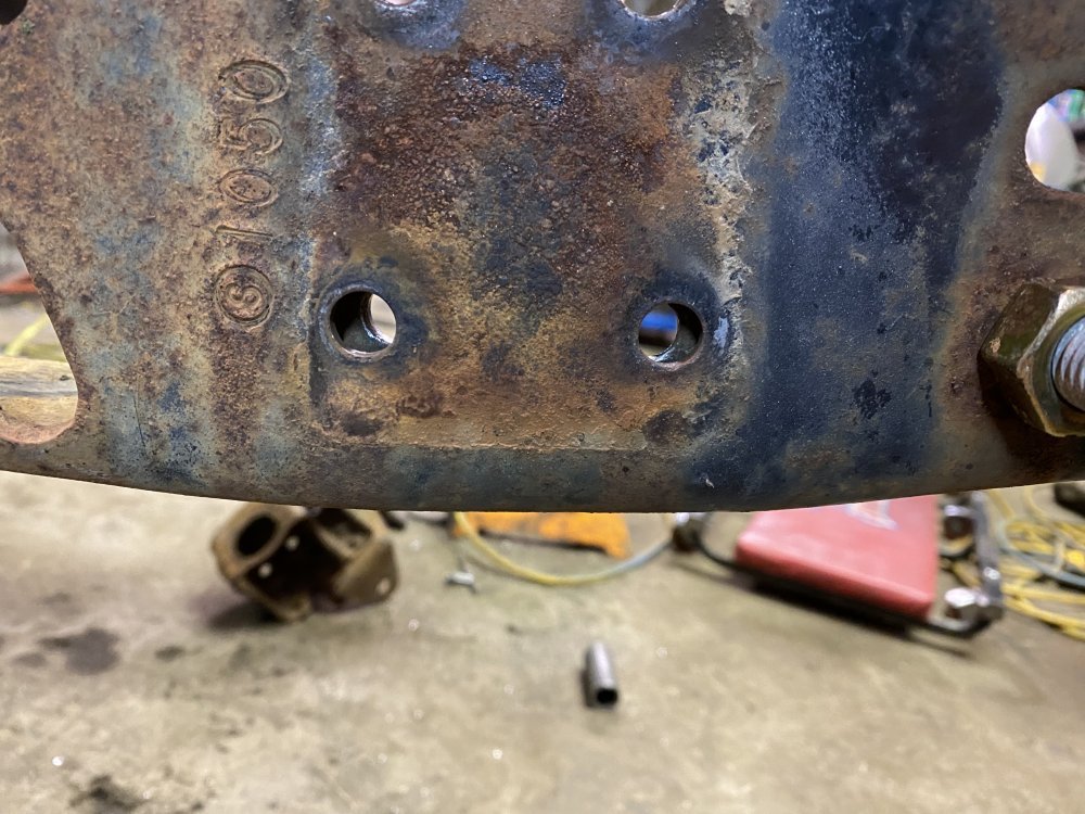

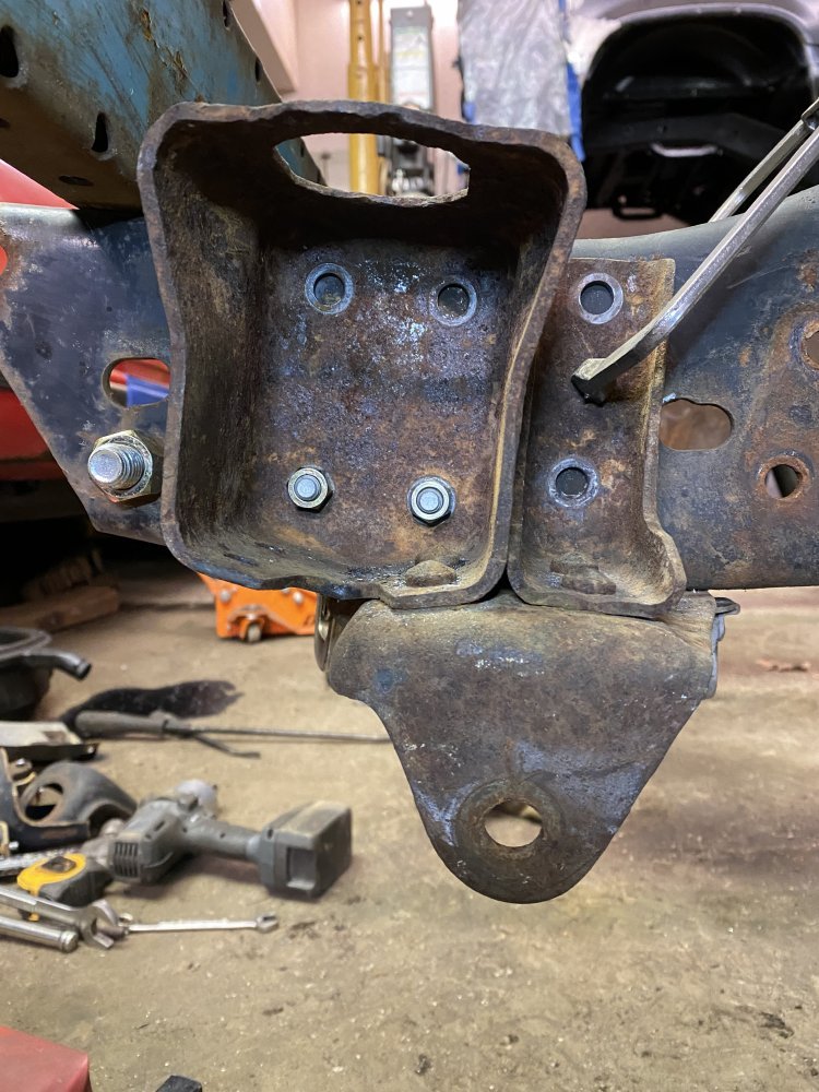

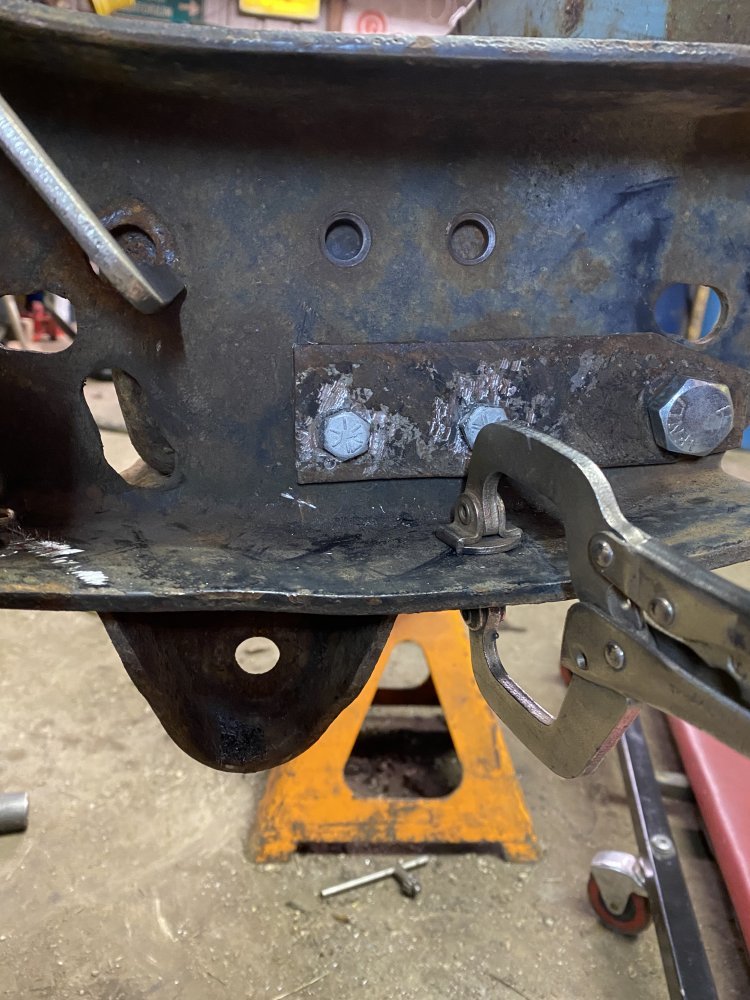

I got the radiator support/front spring hangers installed first. Those were easy to locate because I found a common hole at the front of the frame horn on both frames, and that hole lined up with the support strap on the inside of the rail. I lined that up and then opened up the existing holes in the rails with a die grinder.
Once that was done I could bolt the bracket to the frame and use transfer punches to locate the other holes. Pretty straightforward.

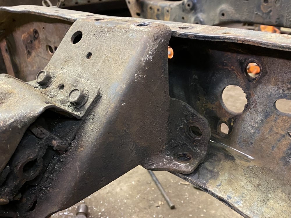

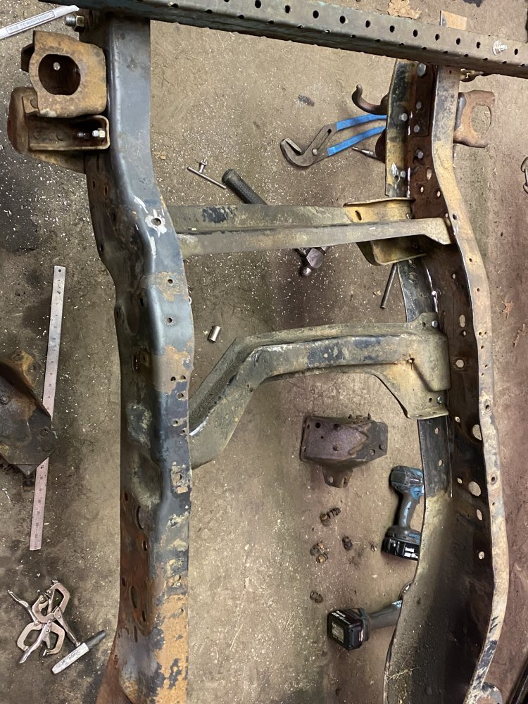

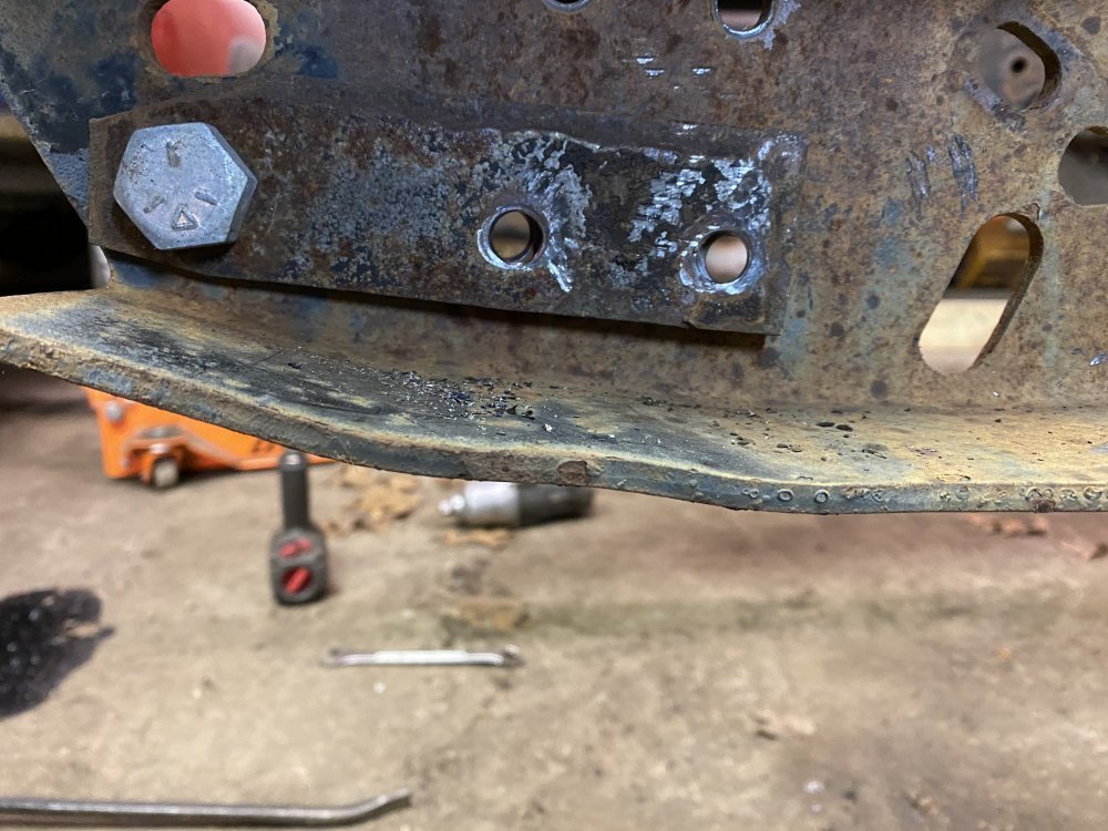

Once those holes were in place, I could use those to find the hole locations for the first two crossmembers. The first crossmember needed some trimming to fit because the 2wd frame bumps in at that location and the 4wd frame does not. I got it all in place on the bottom, but I need to make some 1/2” spacers for the top so it can attach up there…..however, I’m going to wait to do any of that until I get the frame mods for the motor mounts figured out.
View attachment 79114View attachment 79115
View attachment 79116View attachment 79117View attachment 79119View attachment 79118
View attachment 79121View attachment 79120

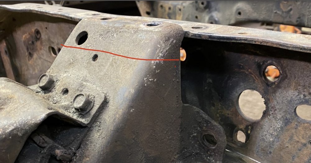

What about cutting down the top of the mount bracket. Then just weld a piece of flat steel across the new top height. If you have 1/4” plate steel, cut out 3/4” in height. Weld it on, then it will fit. Basically cut where I drew the red line.
Wouldn't that DROP the height of the top of the motor mount bracket and thus also drop the height of the motor ½" and then cause turbo down tube to frame clearance issues, as well as probably engine to front differential/steering linkage clearance issues, too?
That would be easier, but my concern from the start has been having the frame rails close to the correct places so when I make the turbo system, what I come up with will work for anyone else's 4wd squarebody. Maybe 1/2" is a bit too anal and the reward I get is offset by slicing and dicing the frame rail...... Hmm, maybe...... The other C30 frame that I bought already converted, that was their solution - they whacked off the top of the brackets so they would fit, only they didn't then add a flange to the top of the brackets so they weren't bolted to the top of the rails.
The bottom rail is what sets the height of the engine in the frame, so modifying the bracket won't change how high the engine is sitting. What it will do though is move the top of the frame rail further from the manifold, which will falsely give me more room than I would normally have. Of course, since I'm building this truck, I will know that I have that extra 1/2" and so I just need to keep than in mind while building the turbo system.

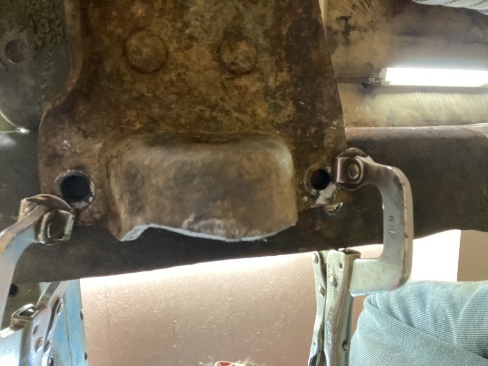

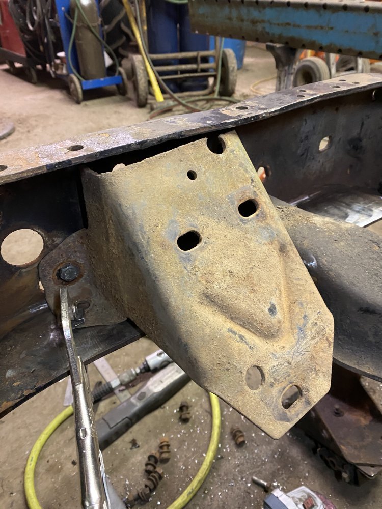

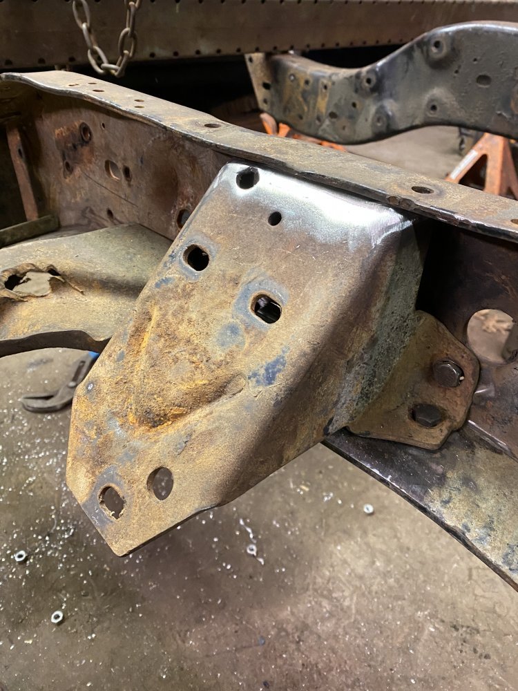

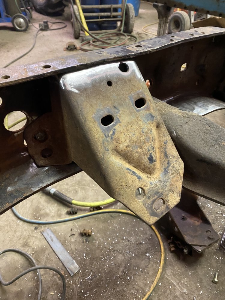

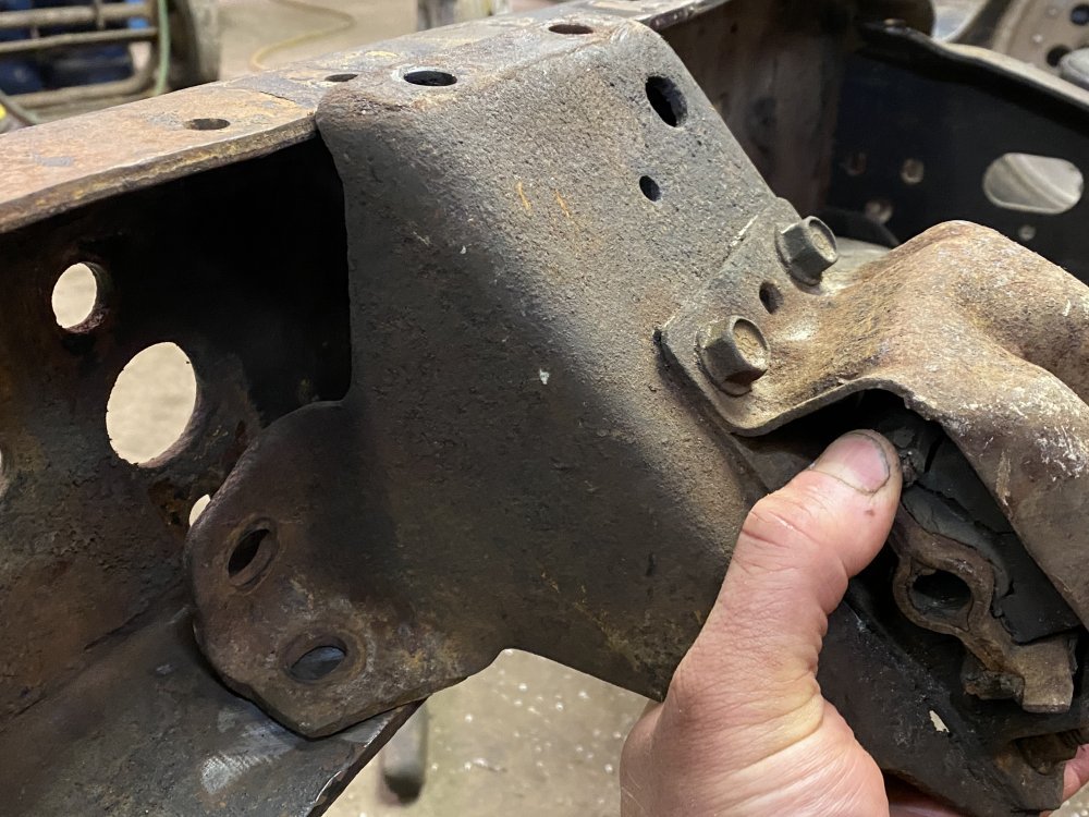

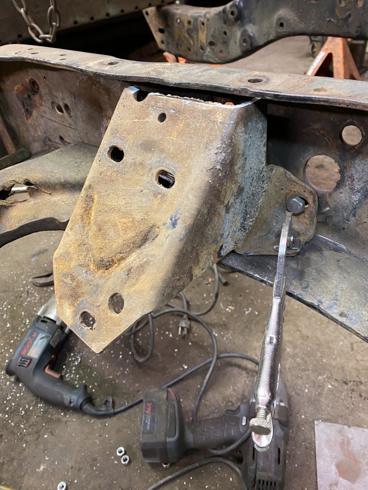

I decided to take the path of least resistance and modify the motor mount brackets rather than the frame rails. Actually, I grabbed the already cut ones from the other C30 rather than cut up the intact ones. They were cut crudely with a torch. Here I had already started grinding on one of them before I remembered to snap some pics.
I cut some 3/16” plate and welded it to the top of each mount. All that’s left to do is drill holes in the top through both the rails and brackets, but I ran out of time tonight.
