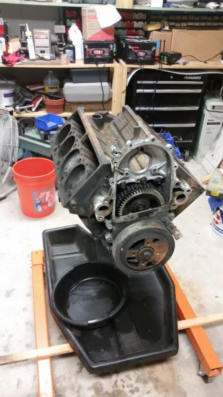

20171018_195049.jpg 20171018_195104.jpg So bringing this back up. After several weeks of crazy work hours and fixing little stuff around the house from the storm. I'm finally able to get back to work on the truck. And in the passing of all that time this happened.
Picked up a 599 6.5 short block. I really only needed the block but for 150 bucks for the whole thing, so why not. Now to get it machined and my good parts pulled from the bad block. It will be a little more money this way but I can spread the cost out to make it affordable.

I was under the impression that the 599 block was a better gm one to get? Miles are unknown on this block but when I pulled the pistons there wasnt any crazy wear on the rod bearings. I checked all the cylinders for size and all but 3 are within .003 of spec. The others were about .006. I'll confirm once I'm home from work but it doesn't have any main cracks.
Other then machinin cost, quoted $35 per cylinder, and bearings. The plan would be to reuse as many parts that I have on hand that I can. Good idea? Bad?

The last time I had machine work done, about 5 years ago, it cost 450 to bore out .020, hone, hot tank it and install the cam bearings. So I didn't think 35 per hole was too bad. This block would get the same treatment.
I'm not opposed to reringing it, but I'm definitely using the forged crank that's currently in the truck. I'll have to check the stock size pistons to see what shape they're in.
I would most definitely re-ring it. If money allows, go with gapless rings. If not, do the standard rings. The reason I say re-ring it is because if it’s ever been close to 220 or higher then the rings don’t have much temper left and you’ll have blowby. I know this from experience.
I really would seriously consider re-ringing it while you are this far into it and have the pistons out of the block in front of you.
