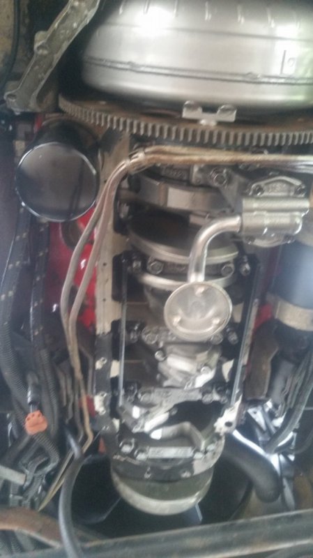

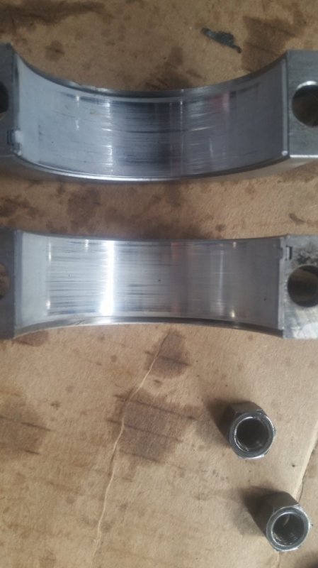

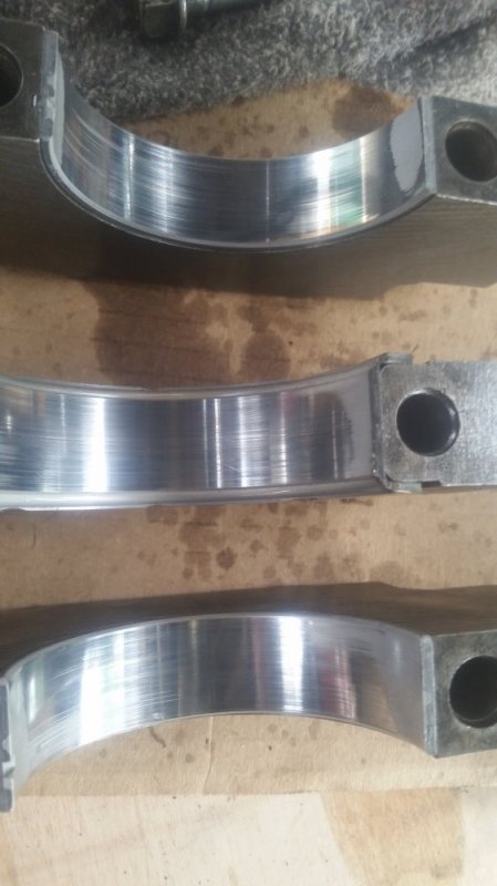

With the amount of fuel that has dripped out when I pulled mains 2, 3, 4. It's likely that cylinders 1 and 3 did just get washed down and may come back.20170903_122831.jpg 20170903_131149.jpg
They don't look to bad considering so I'm going to pull a couple of the rods to check them.
If You push a fingernail across the rod and main journals, does the finger nail catch on the scores ?
I would say that with some fine emory cloth that the crankshaft could be polished in frame and new bearings installed.
Biggest thing would be getting the sandings removed from the oil riflings in the crank shaft.
The only one with something that could be felt is #3 main. I don't feel anything on the others. So I'm thinking rod and main bearings, new high volume oil pump, rebuild the ip and run her as is.
Shouldn't be to hard to clean any shavings. If you wet the Emory cloth with oil it'll catch most of the shavings.
