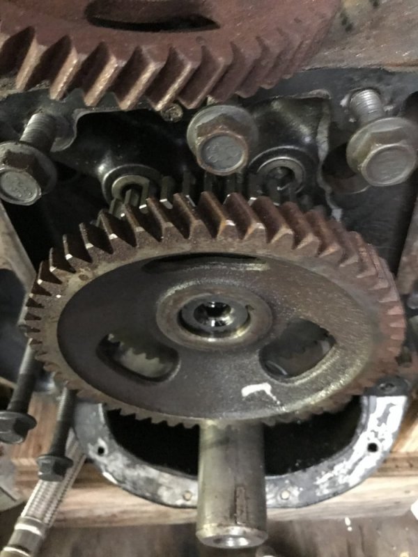

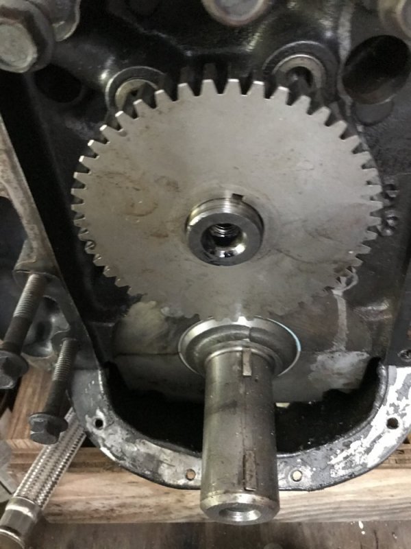

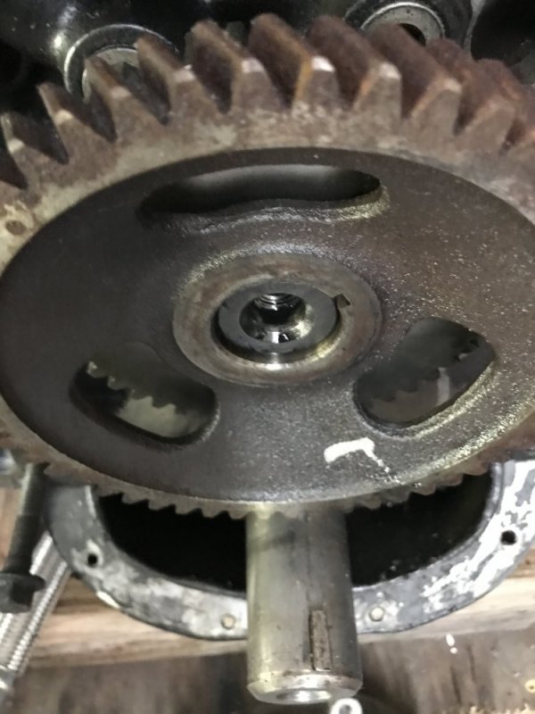

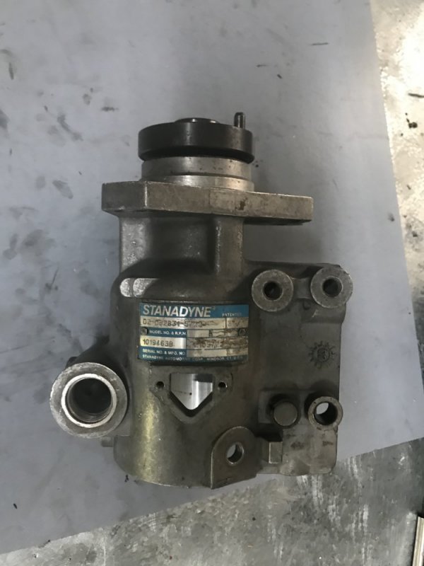

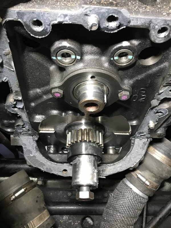

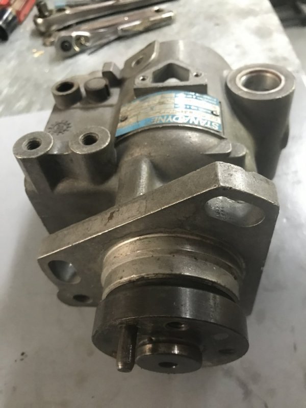

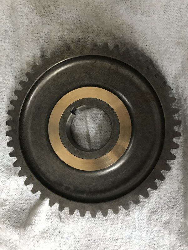

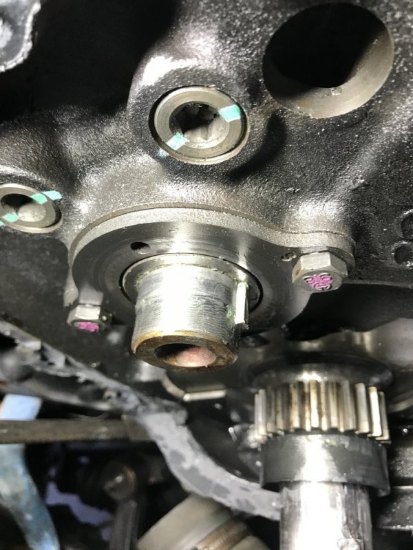

But remember the first Conestoga pump was installed with stock P400 timing chain and gear set, only after that i just went ahead and put the gear drive in.I suspect something else is going on other than a head & rotor, might need to dig a bit deeper in the drive gears...

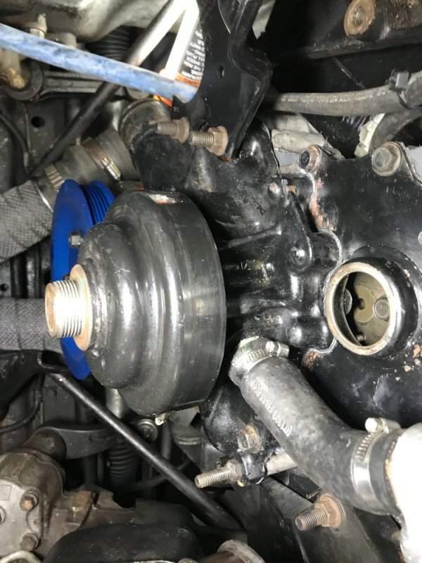

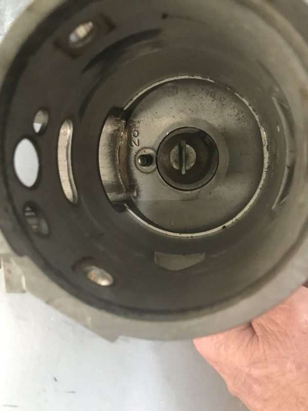

That is just the pump housing with a shaft in it just to keep the gear in place while turning the engine over, do you understand this?I just noticed in one of the pics the front cover is still installed, where is the pin that pushes in the center of the pump, shouldn't it be resting on the tab on the front cover?
Here is the video of the motor running just before removing the Conestoga pump to install Chris's test pump.
