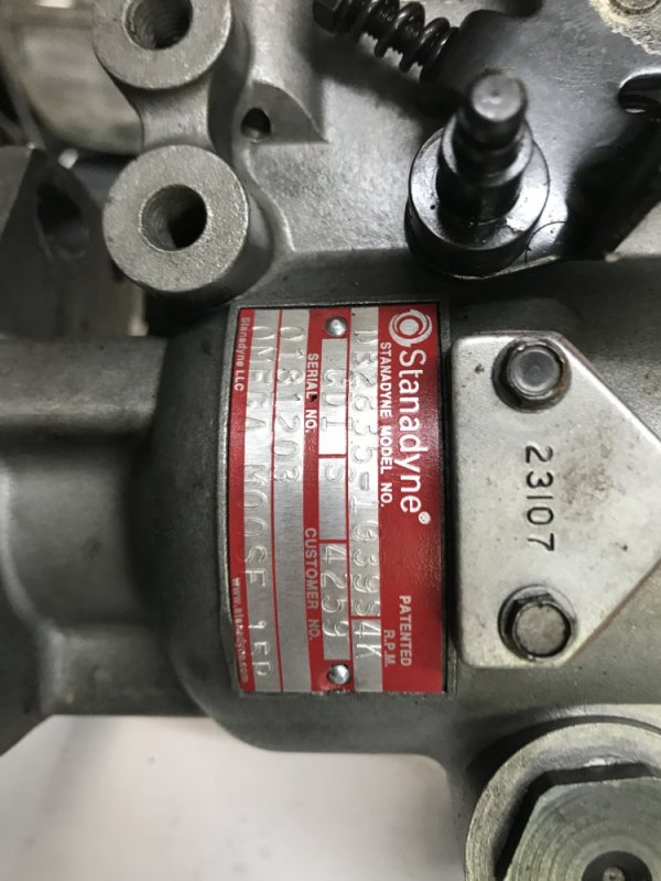

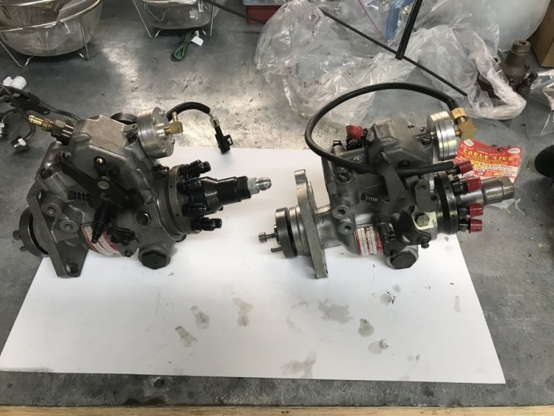

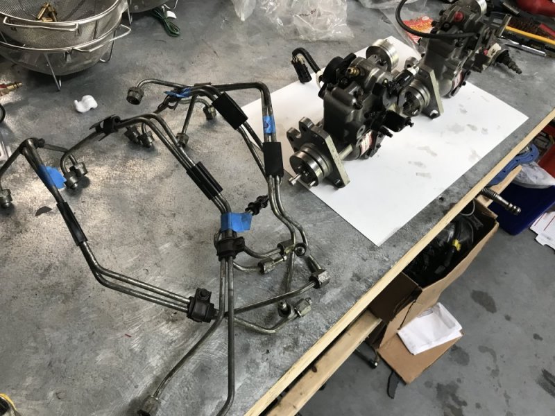

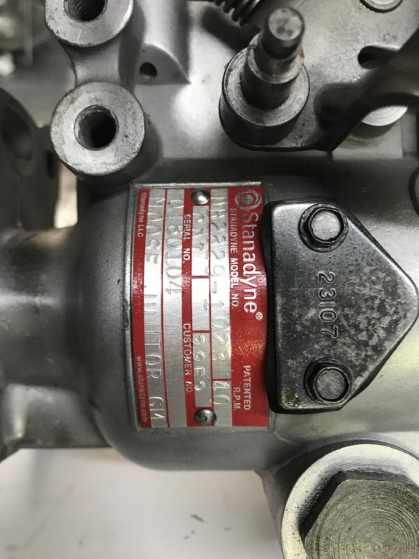

Thanks to Chris with Twisted Steel Performance I've got my trouble shooting pump today and I got my Conestoga DB2833 Omega Moose Pump off along with the lines which will be cleaned with a brake clean and air pressure before I install Chris's pump with the injectors rebuilt by Conestoga. I like to completely remove the lines when replacing a IP so as to not bend any lines. We'll see what happens when I fire it. I got a handful of cash that says it should run on all 8 if Chris says the pump is good. With any luck I'll get this installed and fired tomorrow. Note the tag on the Omega Moose is stamped DB235 which is incorrect as far as I'm concerned.
