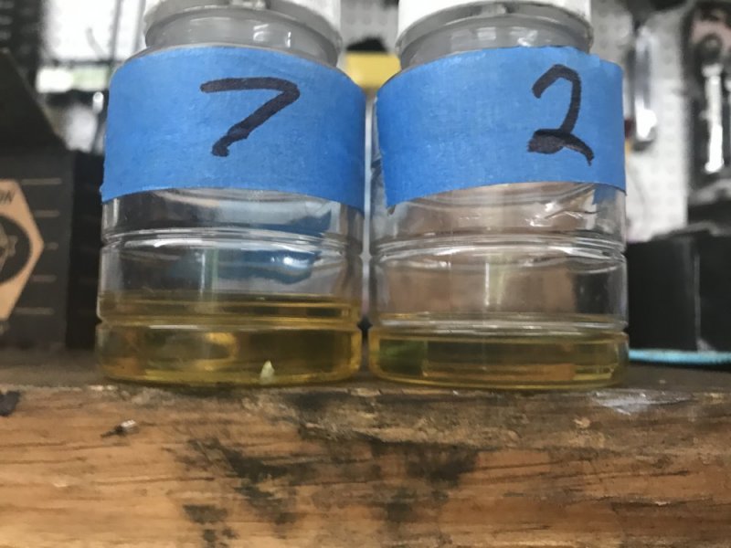

Hey guys, here is a copy of the email I sent Conestoga regarding my latest test....
Good morning Mel, so I had time to do a couple of tests yesterday afternoon so here is what I did... First I removed the lines from the back of the pump on the two dead cylinders 2 & 7 and I ran clear tubing into the clear plastic bottles in the attached photo. I then fired the engine and let it run for about a minute, as you can see in the photo the # 2 put out about 33% or more less than cylinder 7. note this test was done with no spillage. I also put my finger in the top of the two disconnected injectors to check for cylinder pressure coming back through the injectors and there was no pressure whatsoever. I then installed 2 good used injectors that I had checked and pop tested and they pop at 2000 psi. Engine still ran on 6 cylinders with the same two dead cylinders.

Compression test if you are bored and just want to know while the truck is down for a ip replacement.
Well, I suppose you could ensure the injection lines are not plugged, kinked, etc. I severely doubt with your knowledge you kinked a line but that’s about the only thing left that isn’t fault of pump builder.
maybe remove all 8 lines which have to come off anyways. Then put some clear pvc tubing from hardware store over the fittings into 8 different bottles. (Or just use the injection lines if already proven no line damage) Remove glowplugs for compression test and so engine spins easy. Hook up battery charger and crank away until bottles are full.
After the results you got from them, might be a good test to show what you ARE GOING TO DO to the new pump when he sends it. That way he takes the time to do it right. That is a basic yet CRUCIAL part of what they are supposed to do in testing when setting up a pump.
I mean- that is how they are supposed to get the measurements of what the ACTUAL OUTPUT really is.
If 2 cylinders are off from the other 6, that is huge loss in cc3.
Post him a link to this thread just so he knows there is a crap ton of very interested potential customers here. Me included. After mine is back together and broke in a few thousand miles, I want to feed a big boy turbo with a proper ip. We all understand mistakes happen. How he handles it is what counts. Please keep us posted.
I guess I forgot to share with you guys that when I removed the last pump to send back to him, I installed a pump housing with a shaft still in so I could crank the engine without damaging the pump gear or jumping teeth. I then did a compression test and pulled the valve covers and removed the rockers and did leak down test and everything was just about perfect, like I don't think I had a 2 lb difference on any of the cylinders.
