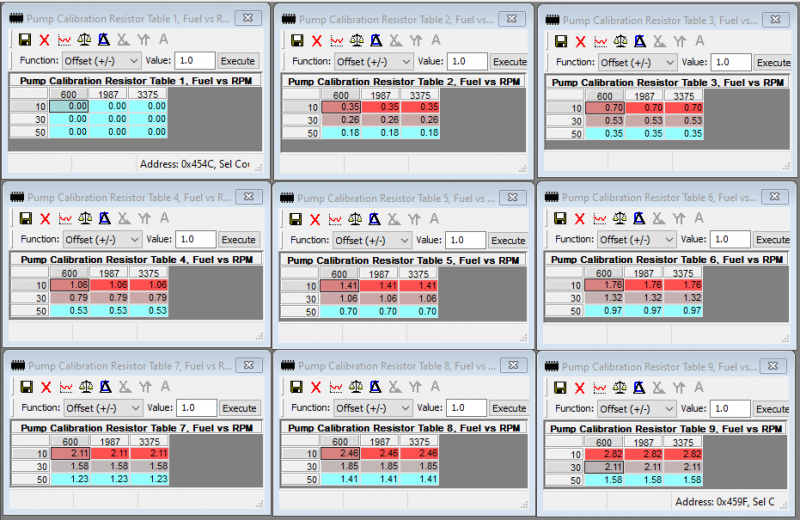

So, if I install the no.9 resistore then do the relearn procedure the IP/PMD will recognize the new resistor ?
I know on mine (95 obd1) I had changed the PMD and resistor not knowing what the original resistor value was. mine didn't read it until I recently, couple months or so ago did a relearn with the laptop. when I put it in, I had used a #5. when I was finally able to get the old PMD off the IP I discovered it was a #4.
Ill open up that bin file I have and see what the table values show per each resistor and maybe post a screen shot of them. maybe it'll be helpful info for us.
Here are the tables for each resistor, their numbered 1-9. this is from a BPAA prom id bin file I found online that appears to be stock. I am still trying to learn this stuff so I'm not sure which other table these apply to nor what the left side of the table numbers referr to ( the 10,30,and 50 numbers) if anyone wants to help me on this, learning for me is much graciously appreciated :)

IIRC, the difference between running a pump that normally had a #4 resistor and doing a relearn to run it with a #9 resistor only equates out to like a 9HP increase - not really worth the time and $ to do it.

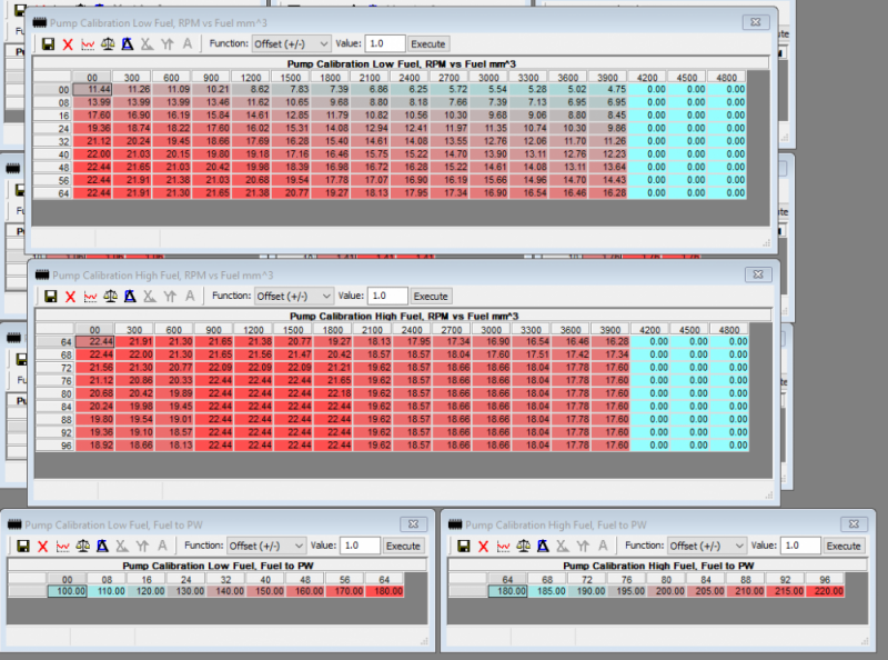

Maybe with these tables and figuring them out, we can change or tweak one of them, say for the #9 resistor and make it worth while to use that resistor. just a thought lol I have read other threads on the rumor that there were other resistors beyond the #9 but I know that wasn't so much true, but making the PCM push more fuel with that resistor might be helpful for some.
of course getting the right A/F ratios is the key to complete combustion and max economy and performance. OBD1 doesn't have any sensors for us to read what A/F is where I think OBD2 does. we would need some sort of way to see what our current ratios are to determine if more or less fuel is needed on our current setups with stock turbos, ATT's and others.
I don't know how most guys here are for the expense of a upgraded turbo, but if like me where funding is holding us back but if we could take what we currently have in stock form and get the most or the best of both worlds economy and performance out of it with slight PCM tweaks, that would be awesome. plus like for my truck, it needs a little more glow time to start up in the mornings, adding a custom tweak for the glow times in the PCM rather than to deal with an ad-on manual switch to extend them, I would like.
