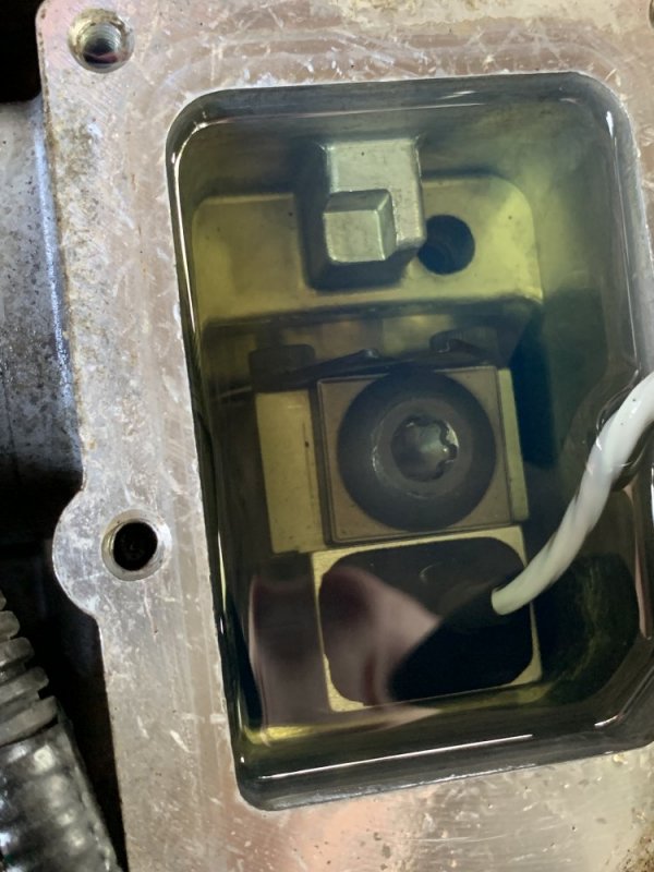

Well today I decided to un-do the optical bump and set the timing properly. My goal was to get as close as possible to a -1.45 or so like @MrMarty51 has. Well got the top off the IP and loosened the t-40 bolt to move it back. That’s were the problem started. I can loosen it and move it back to my scribe mark but as I slowly tighten the screw it moves back where it was !!! I tried several times even with holding it into place with another screwdriver while tightening up but it jumps back as it snugs up as if something under there is like notches lining up. What’s further interesting is if it hold it over further that where I scribed it just to hope it with settle down at the mark. The screw won’t tighten just turn roundy round!!!
I’m kinda questioning if I even moved it before when I did the bump. I had scribed two marks one on both sides of the top saddle thingy for the OS The mark on the other side is lined up with the top saddle thingy!
I sucked the fuel out of the hole and tried again. Still the same. It must be notched under there! But in doing so I noticed I can easily move the entire OS side to side with it being tight using a flat screwdriver. The “v” notch thingy moves with it too. I hope that’s normal
I moved it straight up center as it looked to be when I pulled the top. Going back together with it and if all is good I’ll do the timing
