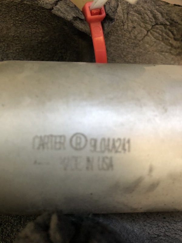

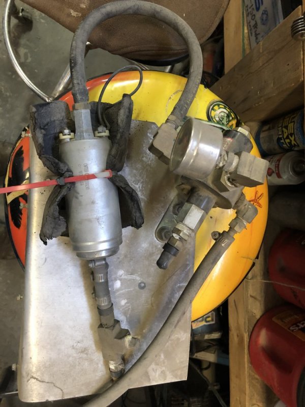

I have that system setting on the shelf.I like this idea
