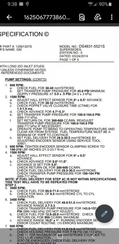

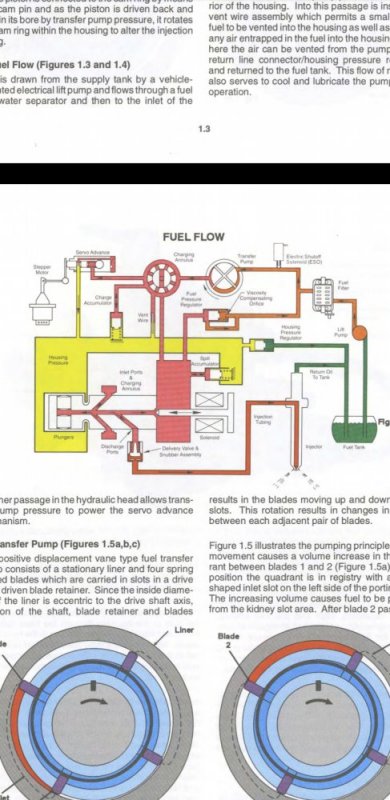

I also wanted to post an update to how things are going. so far I have noticed easier starting and haven't seen any more air in the clear return line. Ive also noticed that now it has positive pressure on the IP from the LP, it's easy to press the pedal and hold 1k rpm. not sure if that's just a coincidence, but it feels and drives a lot better.
back to mentioning about the wastegate system, I do need to replace the vacuum solenoid still because it doesn't cut back on boost and sets a code, but I haven't done that yet only because I don't really drive it hard enough to get into an over boost situation under normal circumstances. at least I have boost now where as before when I bought the truck, there were so many boost leaks and exhaust leaks I think when I first got the gauge installed, the most I saw was 5lb. Now everything is all sealed up![]()
I think now that I have a LP that actually is working, I may go ahead and replace the boost solenoid and then run through a tank of fuel to see how my mileage is before I do any more tinkering like trying to adjust the TDC-offset closer to -1.25 to -1.54, not to mention remove the optical bump at the same time ( or should I? )
