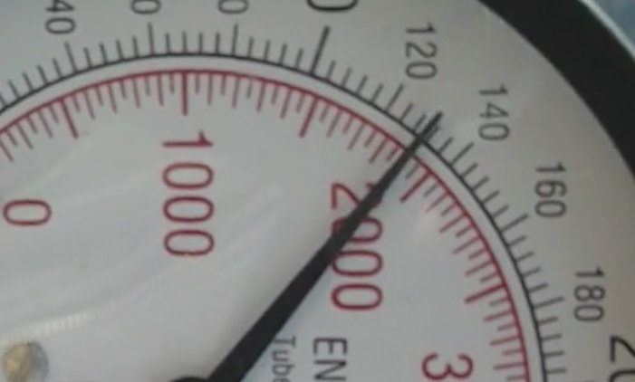

Also something to note. where did you purchase the tester from? if it's china made (many are sold on ebay and amazon) the gauge might not be accurate. you might look into replacing the gauge with a known accurate one from a hydraulic shop or at least have yours tested to see if it's accurate. But the trouble you might run into if it's china made is the threads on the gauge and fittings might be metric or British standard thread, both are very different than normal SAE thread.
