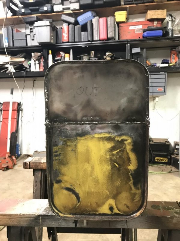

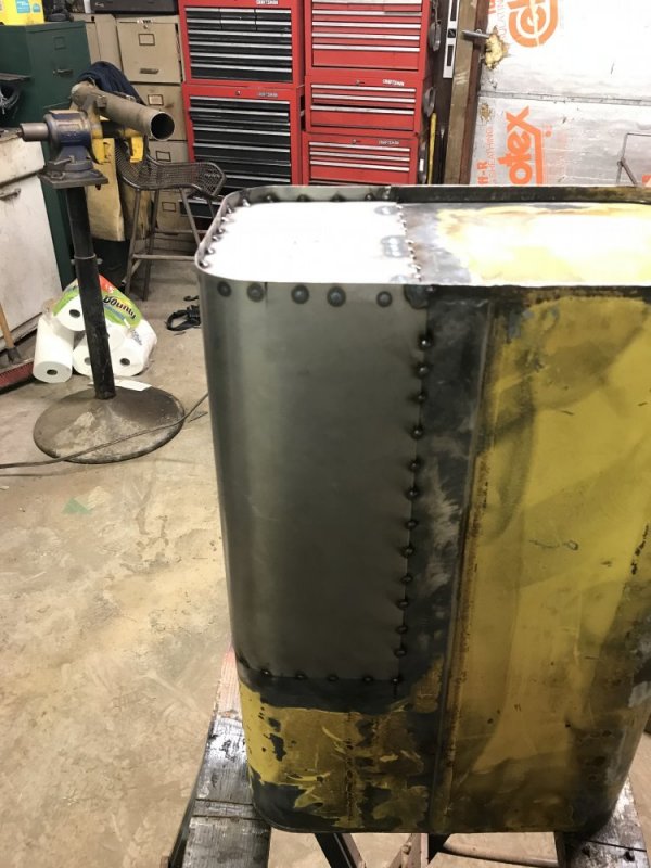

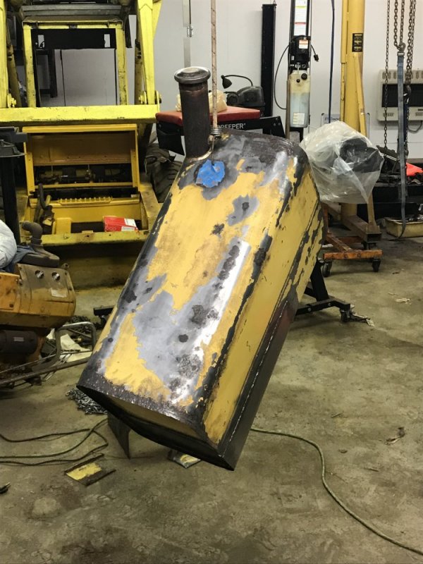

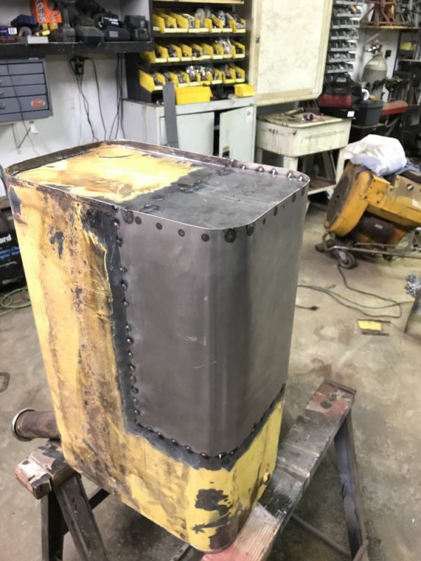

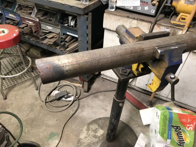

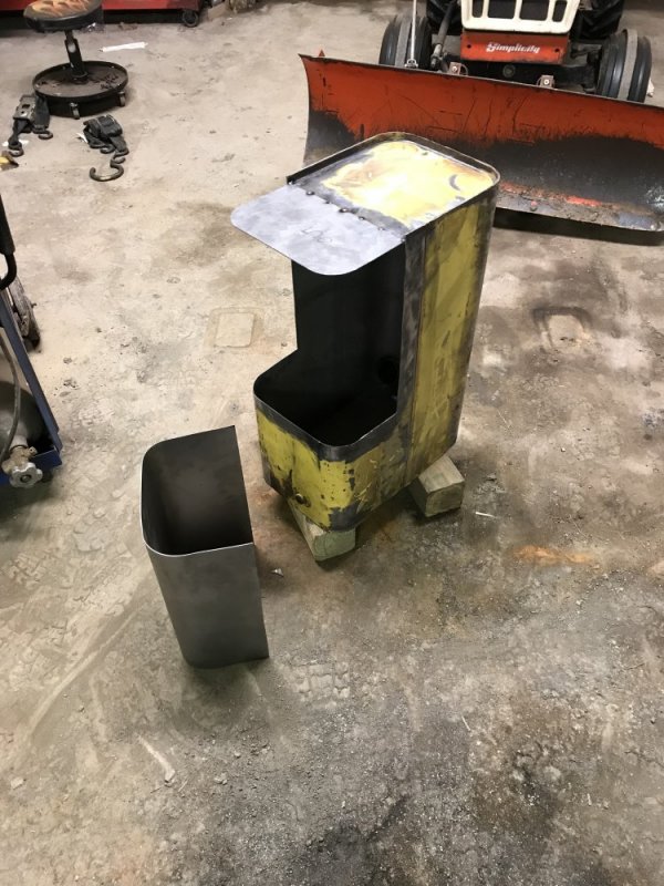

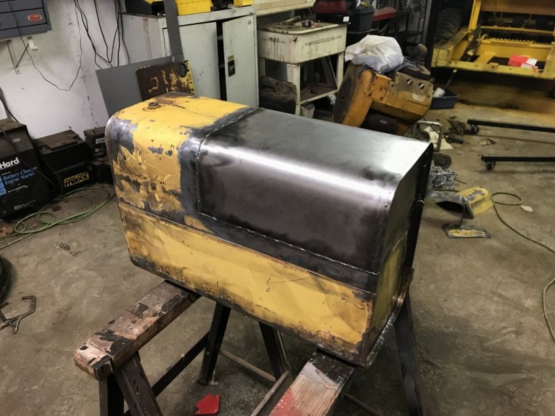

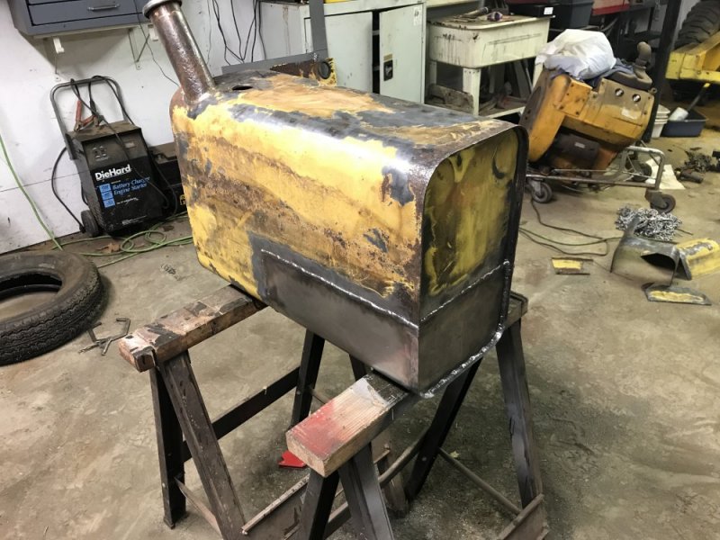

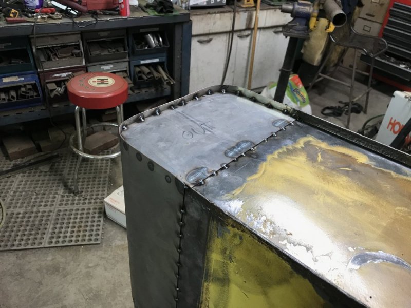

I got the patch panels made and tacked in tonight. I got a drop of 18 gauge carbon sheet to make the patches from. I used a piece of 3” exhaust pipe as my forming buck for the main panel. Overall it went pretty well, now I just need to stitch it all together. 241D1665-3A6D-4BC6-8376-C4F2BBB61782.jpeg1639465C-6765-49C6-937C-CB46C101ABEE.jpeg1C4829E7-EEB9-451F-A475-AA33CB20519C.jpeg8DBBDED9-3EC0-41D9-9C25-39FDB5C63D67.jpeg

What did you do for leak testing?
Just visual inspection. All the welds looked tied in really well - nothing that worried me, but this is the first time I’ve ever welded a tank.....now you have me worried. What do you suggest?
When I weld grease duct for kitchen hoods the inspector drops a light down the duct and looks for holes.
I don’t know if the fuel fill hole is big enough but might be able to come up with somehow to get a light on the inside and look for it to shine through on the outside.
When building tanks the max pressure allowed is 5 psi, we usually used 2-2 1/2 as Les said with soapy water. Do test it now as it is clean, if it leaks it will need to be steamed out or an inert gas purge to re weld.
I filled the tank with water before I left for work this morning. I will check it for leaks when I get home. I filled it to the top, which is 18 gallons - that should be enough head pressure to tell me if it's going to leak, shouldn't it?
Yes those guys got you in the right direction. Very important to leak test tanks/vessels prior to final restoration, sometimes those pinholes are hard to spot.
Any info on the neat looking simplicity in the upper pics? How does it plow with those front tires?
