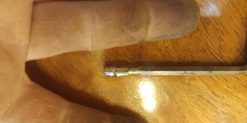

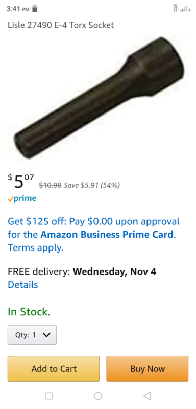

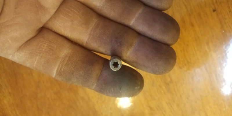

So I changed out my ignition switch today. Should have been an easy job but..... The 2 screws that actually hold the switch on were E4 torx, which of course I didn't have but the biggest issue was there isn't room to get a quarter inch drive socket in there. Needs to be in like a nut driver type screwdriver or a socket with a really long snout. I did manage to find a socket and this is the modification I had to do to get it to work. The socket had an internal round hole so I ground down a Allen wrench until it almost went in, then I heated the socket up and hammered the Allen in and then ground it small enough to fit. What a pain. I did order the correct socket on Amazon for $5 the description said it was specifically for gm ignition switches.IMG_20201024_152630.jpgIMG_20201024_152637.jpg
