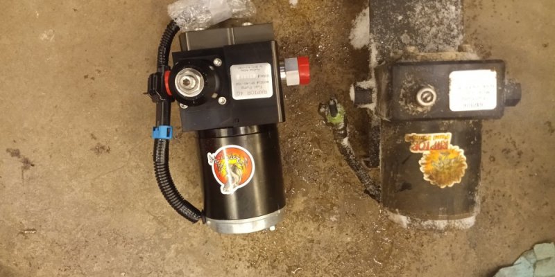

Well it looks like my raptor pump has died. I've had to replace the fuse 3-4 times and just now driving home the pump quit. Changed the fuse but nothing, acts like instead of being shorted it has an open. My brother is on his way with some cardboard to lay on, a DMM, and another fuse. I have my stock LP on board.

Installed it in 2017, on my 96 I went thru a pump a year for 3 years before I finally got one that lasted. Plus I was looking ahead towards more performance in the future. At this rate the after market pump cost me about the same as a lift pump per year. On a side note I discovered that my fluctuating fuel pressure readings weren't totally the raptors fault, getting some weird readings with the stock on too. Only getting about 3 psi running down the road.
I was just thinking that if you're having problems getting good pressure out of 2 different pumps then there must be a problem outside of the pumps, like a partial blockage before or after the pump. And maybe that is what killed the Raptor since it was working extra hard?
