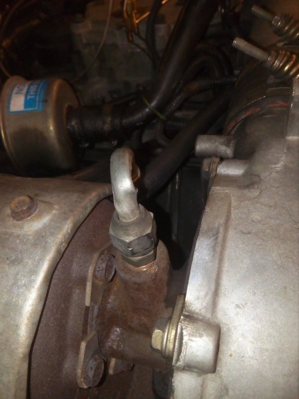

I have had similar happen, By pulling on the tube and bending it back to originl position, it might be okay.
Unless it cracked.
