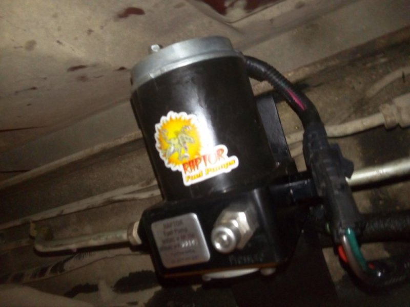

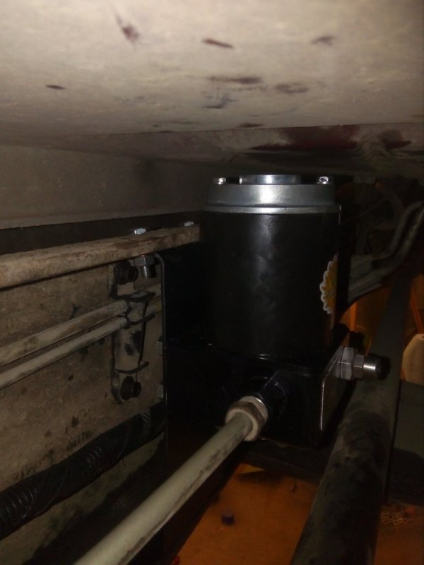

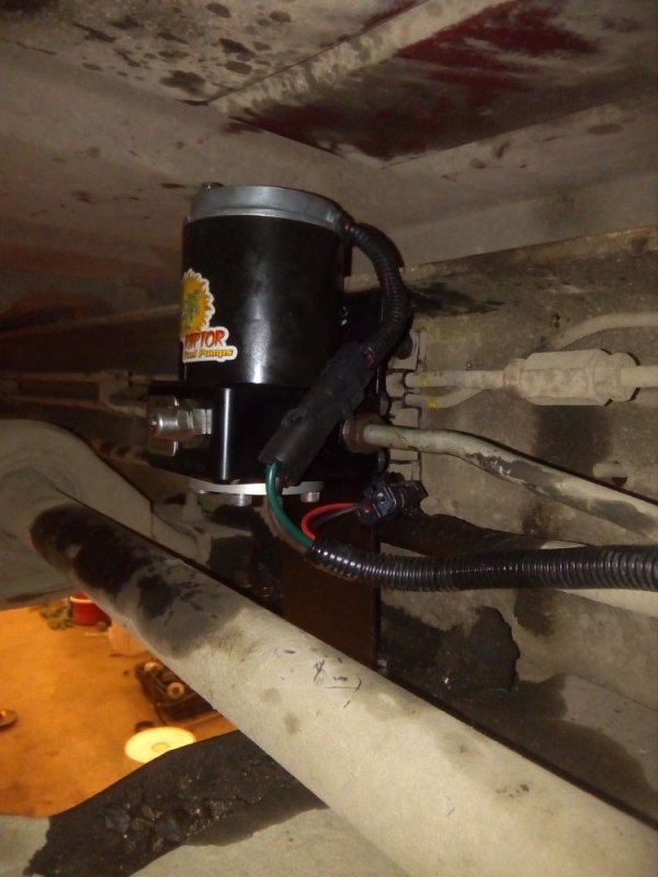

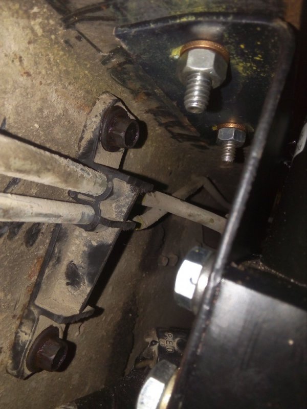

Raptor install basically done. Still have to bleed it. Should be easy to go back to a stock pump if needed. Trimmed the old pump holder down so it would still act as a line holder. For anyone else trying this the fittings that screw into the LP are 8an male x 16mmx1.5 female. Bought them from summit.IMG_20171018_204042.jpg IMG_20171018_204112.jpg IMG_20171018_204023.jpg IMG_20171018_204429.jpg

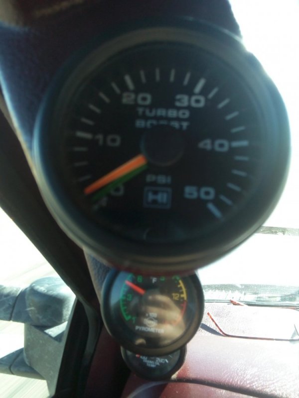

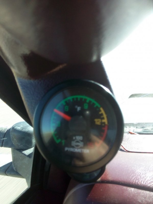

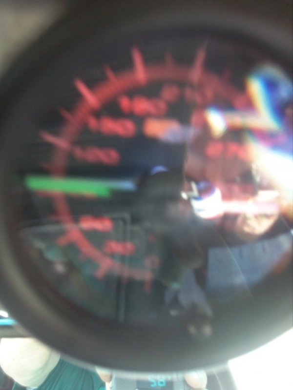

All I can say is wow! Drove my truck to my jobsite today and was playing around seeing how much boost I could get,this was before the LP, and with an empty truck if I downshifted out of overdrive as I came to a hill I could see 16. Coming back with somewhere between 800-1000 LBS in the back and doing the same thing I could see 18. Took it out to adjust my lights and was shocked to see 20 without even trying very hard. Truck really came alive kinda felt like a gasser after a cam swap.
I'm glad I ended up putting the LP in last just so I could see that as the only change. It's set at around 12-14 psi.

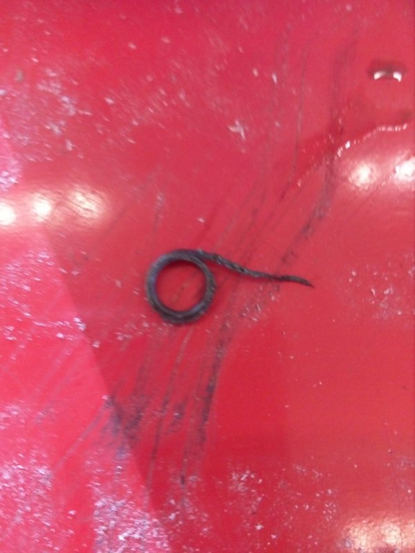

So went out to start my truck this morning and it started and then died looked at my FP gauge and no fuel pressure. So I drug it into the shop and discovered I had lost prime. Long story short I found a bad oring on the suction side of the pump. Also discovered I have an exhaust leak so I'm not even getting full drive pressure to my turbo.IMG_20171020_133502.jpg
Did it look like it had been leaking fuel at the bad o ring ?
