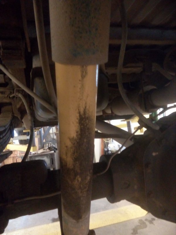

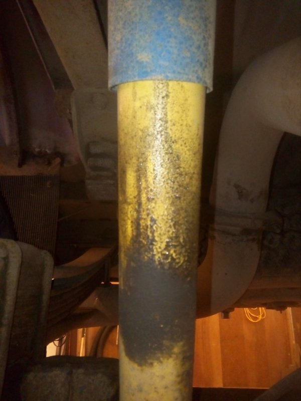

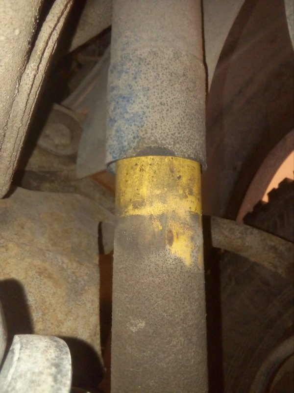

I thought Bilstein was the way to go, I have never used them myself.
Hmmm.. Me too. I've had mine on for a couple years and they've been great.
Bad batch?
Do you know the part numbers ak? If I can dig them up, I'd like to compare them to mine.
I thought they were too proud of them and opted for good off road Gabriels. They work just fine. But the GMT800 may be a different breed than 400s for suspension
The only shock I have actually seen fail as it happened was on a vehicle that was overloaded and hit a bump hard and it was too much for the shock to absorb and blew out the seal. It was an air shock and it puked the oil with a burst action.
I wonder if the cold has any worsening effect on oil flow in the shock that most wouldn't see. I wonder if you would do better with an offroad shock meant to absorb big impacts. I haven't seen any bleeding on my shocks.
