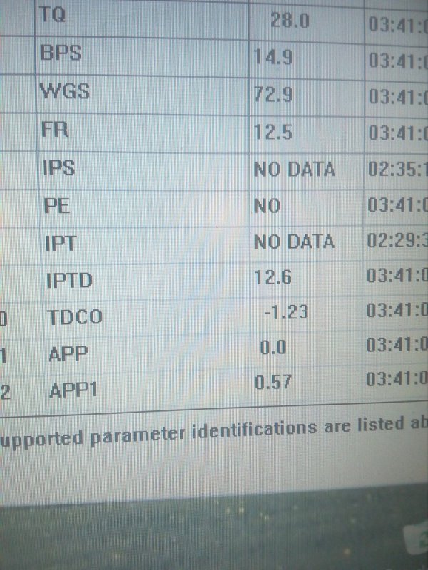

So I got a different pump installed and when I go to set TDCO it dies. This is with car code anyone have any ideas? I'm tempted to try my other PCM.
I've always felt that something hasn't been right as my TDCO has changed by itself several times. So if I change out this PCM I'll have to do security relearn, I'm assuming.
So got the PCM changed but still died when I tried to set TDCO. Turns out it was out of range. You know I've timed quite a few of these 6.5s but never had this issue before. Also seemed like it was super sensitive to any movement at all. I went all the way from +2.46- -2.56 in just what seemed like a couple of MMs. All done now and Leroy will be proud I finally put the pmd in the bumper. Never had one there before.:)

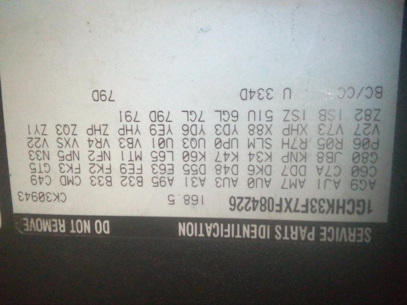

I'm actually not sure you could buy a K3500 dually with anything but the 4.10 gears.
