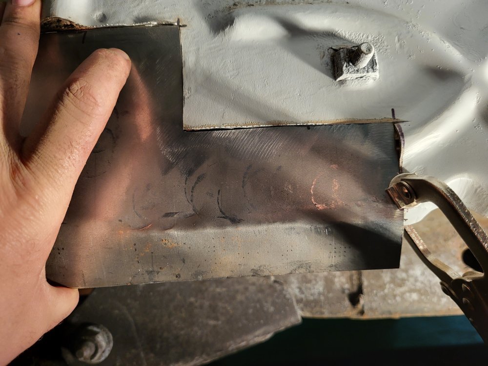

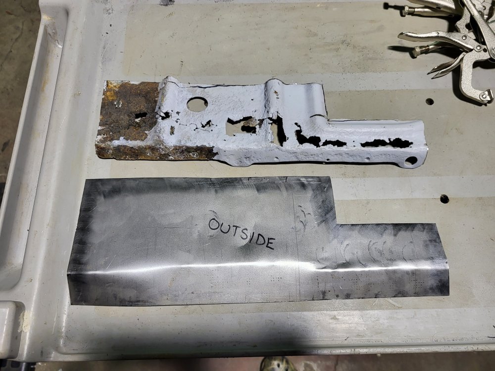

Found out today 16ga is a bit tough to bend! Some idiot dimples from me but oh well, it's inside the cavity. Working the patch piece slowly but surely.
It'll go slow clamped well and using a couple pair of vice grip flat blades/ seamers.
You have to go a tiny little at a time and back and forth.
Set the grips so they don't quite lock and it saves time.
By set tight, I mean tight enough that they don't lock, but almost. Saves popping them open a bunch of times.
Unless you have enough pairs to go all the way across.. then lockem if you gottem
