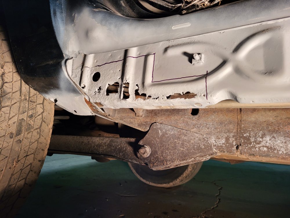

Hmm, never used one of these. Wonder how "clean" it cuts? I will try to get some better pics tomorrow of the area. The stupid rear HVAC stuff is what makes this so rough in terms of access.
I thing you on the right track, I need the smallest angle grinder I can get. Another tool I am thinking is one of those small air saws. Basically a mini reciprocating saw. Might be easier to get that in there.

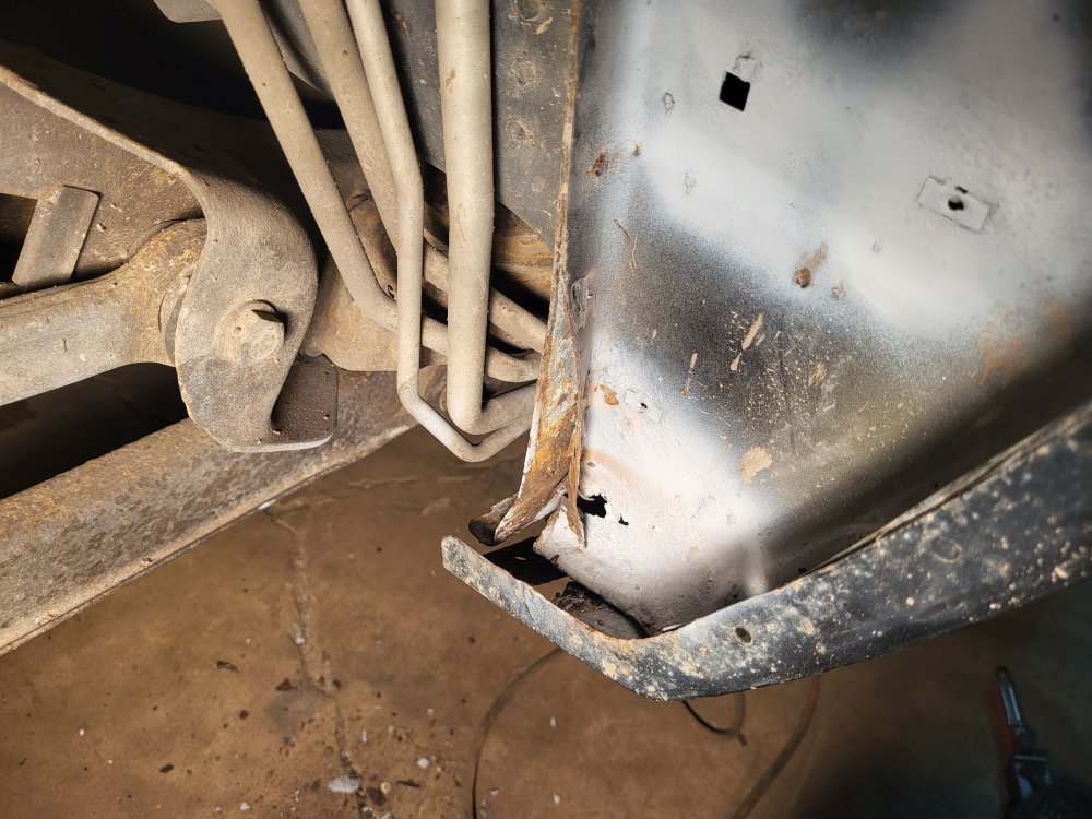

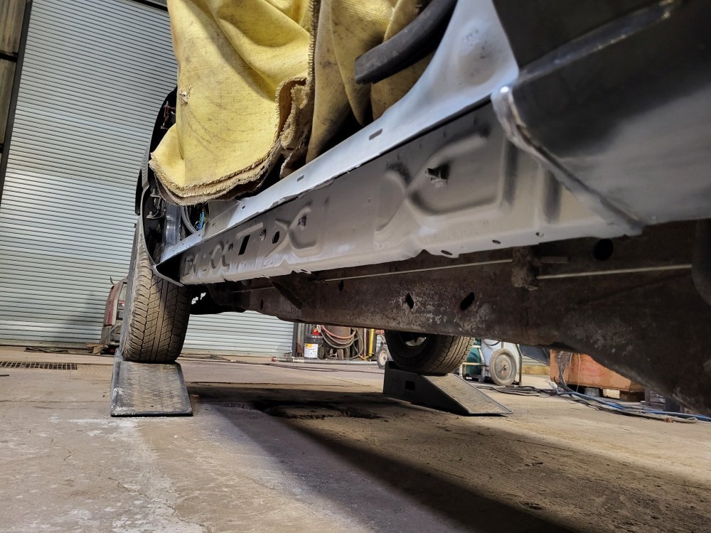

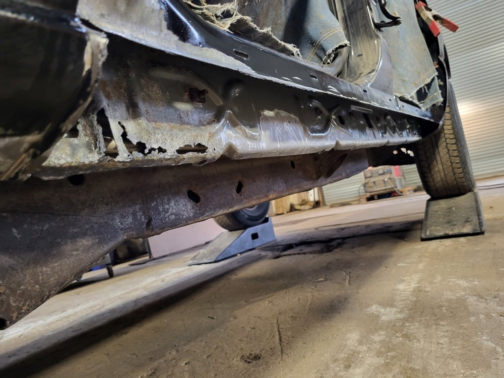

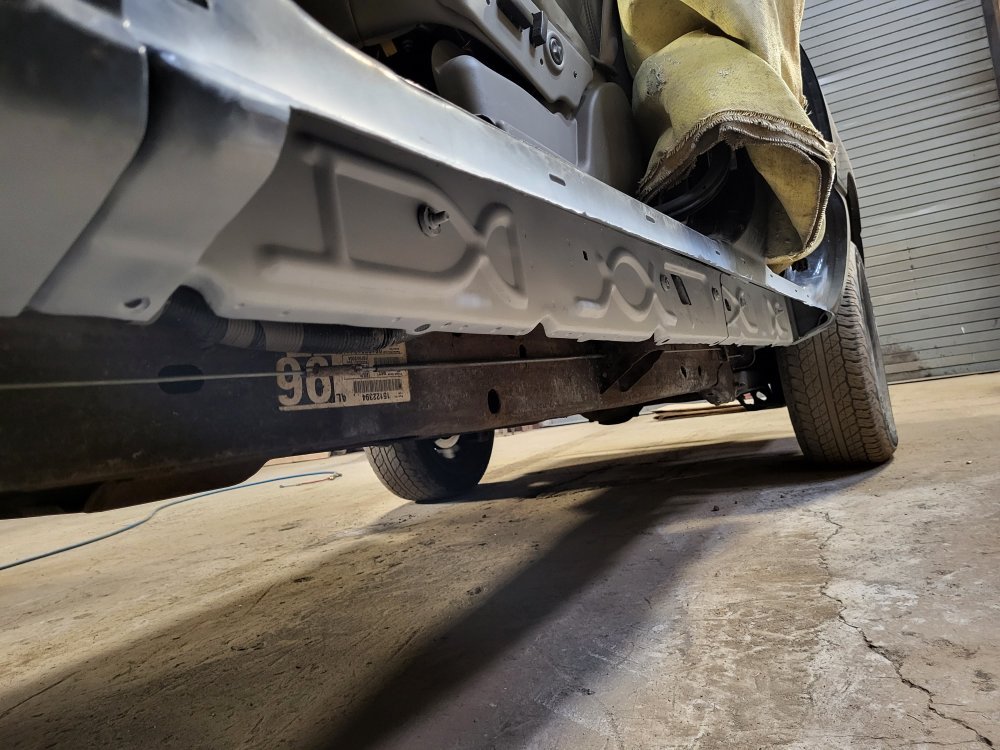

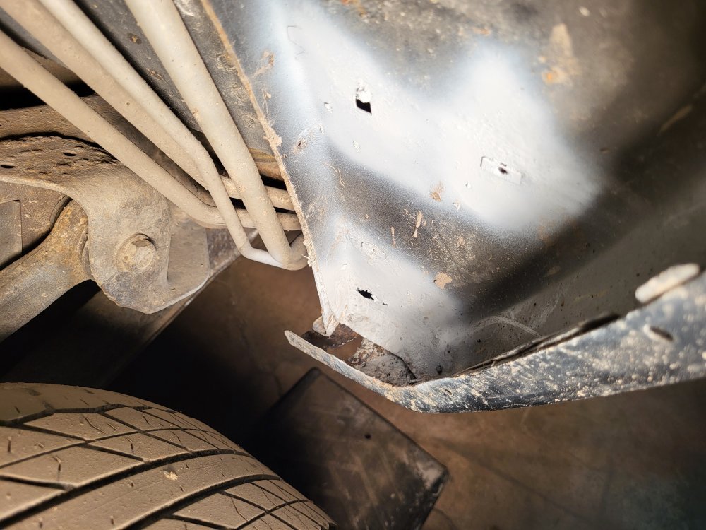

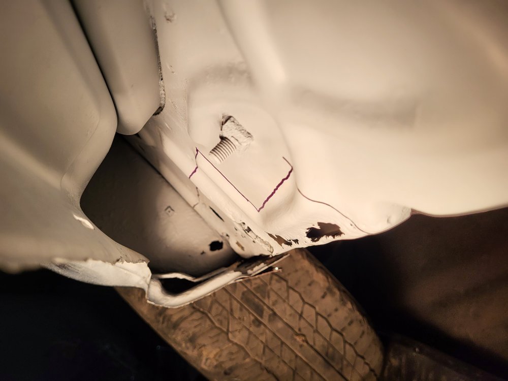

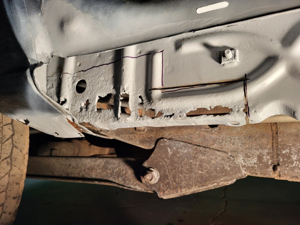

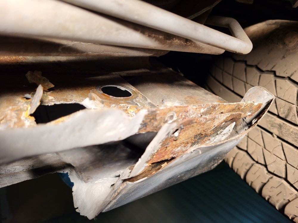

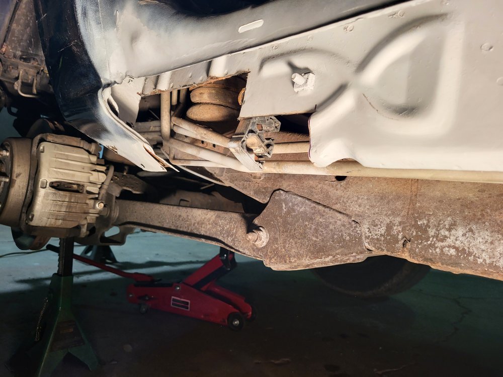

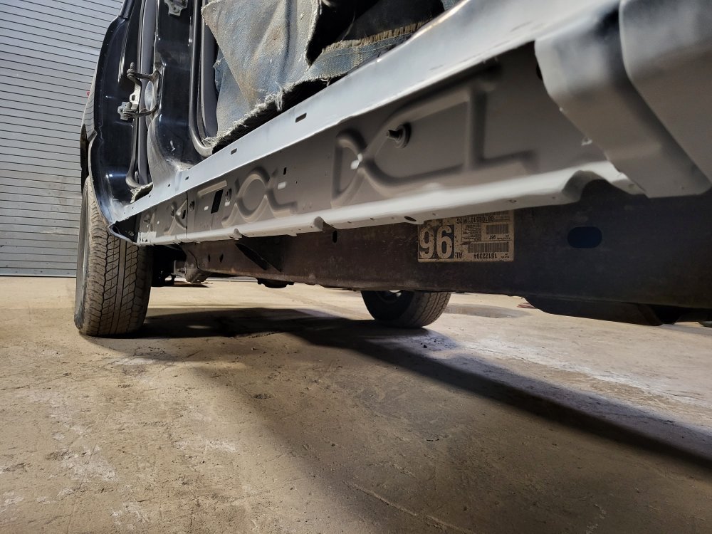

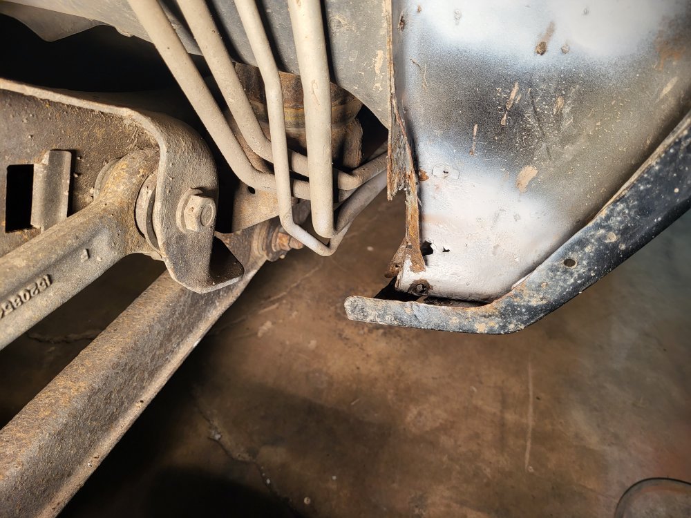

Unclamped the rear HVAC lines from the backside of the inner rocker to create some "space". Drilled some more spot welds, contemplating on doing the front lower quarter on the passenger side as I created a hole digging for more rust. This will help me access the wheel well which also has a small quarter sized hole in it. The drivers side is in much better shape. I am now at the point where I need the small angle cutter as discussed earlier or a long reach grinder. Might just go pick up both at HF, wish they came in corded mode instead of pneumatic.... I don't have air in the back of the shop where the Yukon sits. Its a PITA to move it up front, I just don't have that time on my lunch breaks.20230103_122833.jpg20230103_123628.jpg20230103_123645.jpg20230103_124831.jpg20230103_125308.jpg

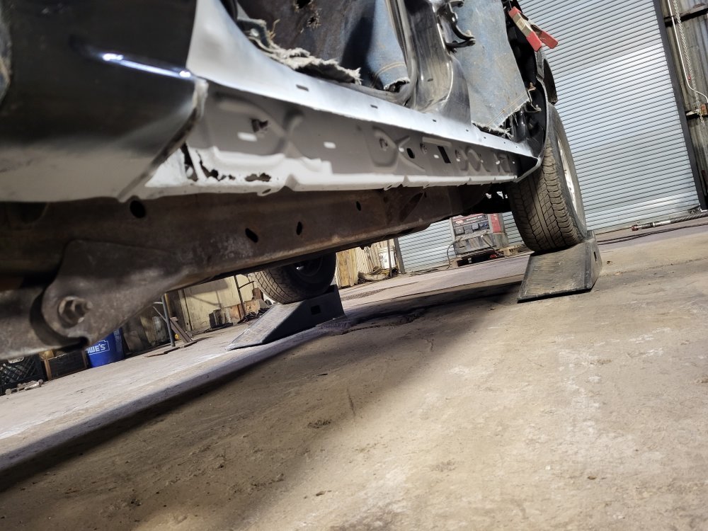

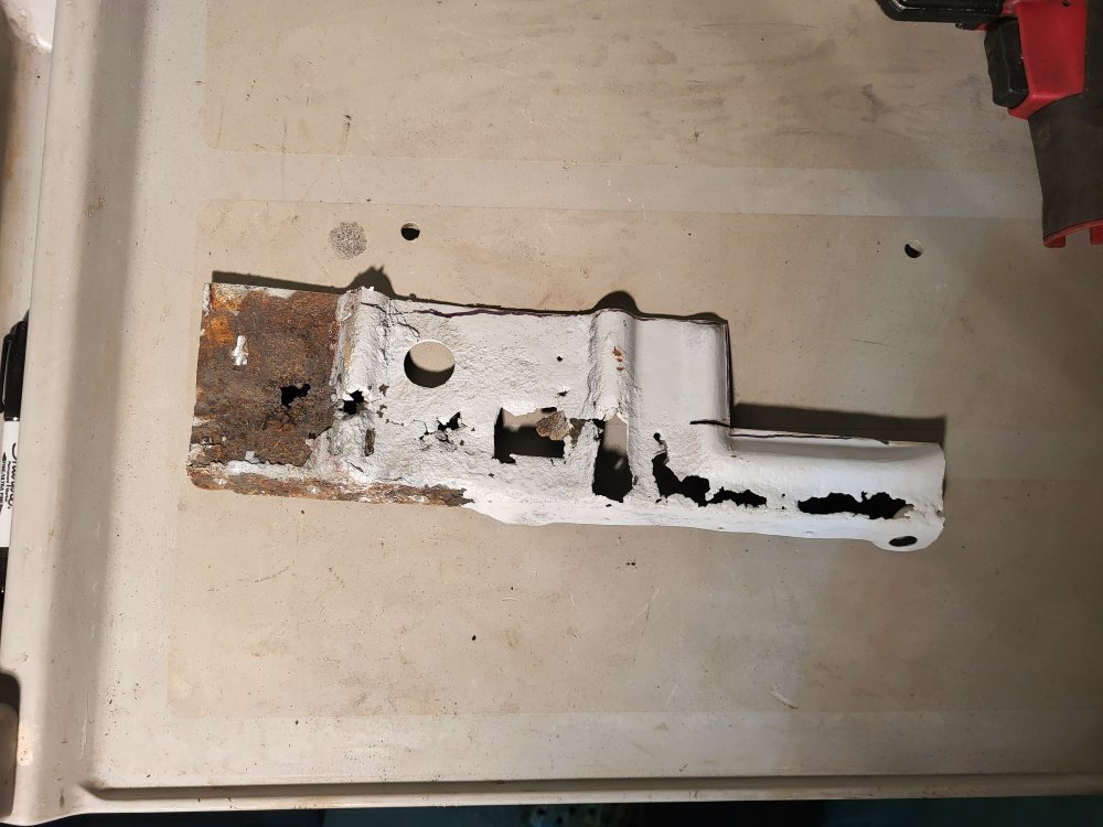

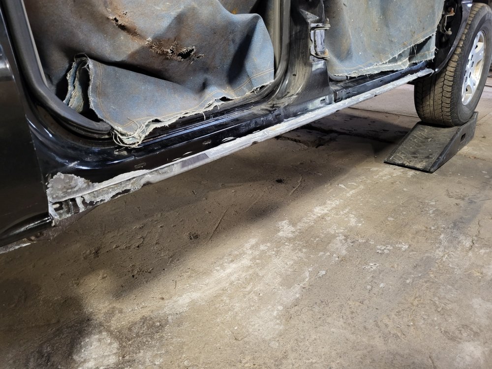

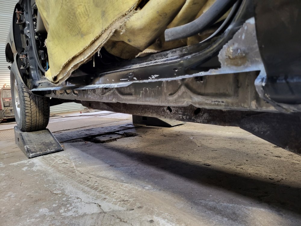

Got the inner rocker cut out. I actually mounted my die grinder cut off wheel to a drill and cut a good 1/3rd of it. The last 1/3rd I used a sawzall to go in from the wheel well towards the front. Id say the piece came out nicely:
