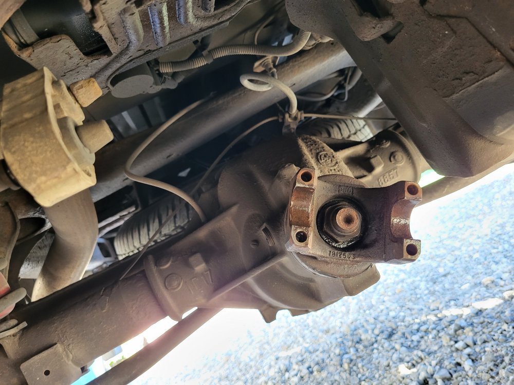

First off i started noticing a driveline vibration on the way down at 75 to 80-MPH. Never had felt this before, but rarely get to 75-MPH locally to home.
I did get the notorious u-joint squeak starting faint while coasting, then becoming more pronounced during acceleration while we were down in TN. Checked the joints, no play noted. We did check for play prior to leaving too, but this is something you just can't identify!

We will be pulling the rear for new joints. May be pulling the front as well for piece of mind.

Usually you can find that bad ujoint by temperature. Be careful though they can get quite hot without having noticeable slop
I had that thought going through my mind on the way home. How hot that sucker could get.

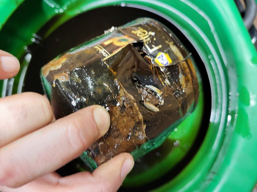

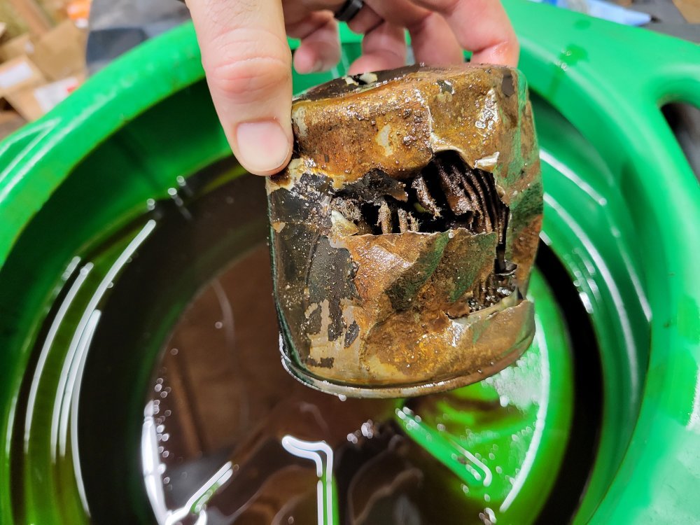

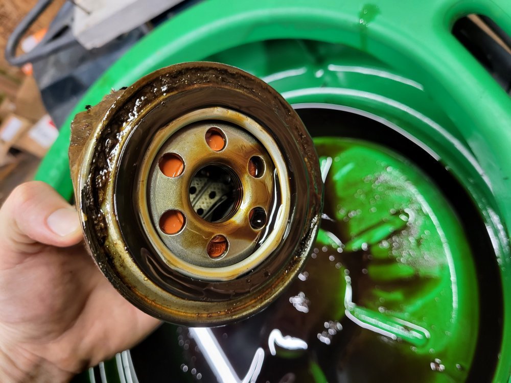

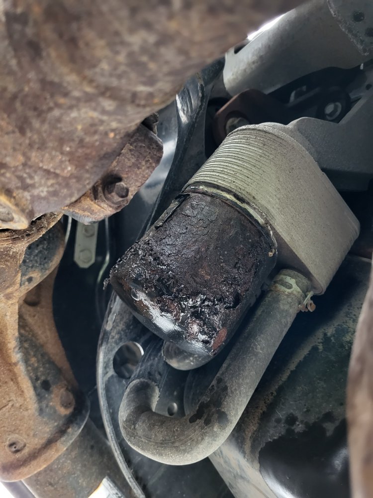

Welp, plans changed again. Found an oil leak on my 21 F250 (with 46K-miles) work truck after noticing a smell, drips on the ground and then finally smoke. I don't know what to make of this as the Company pays a guy to do the oil changes. I need to go back to the truck file and see when my last change was, but I haven't missed one yet with the dash minder.
It was a fight to get it off.......

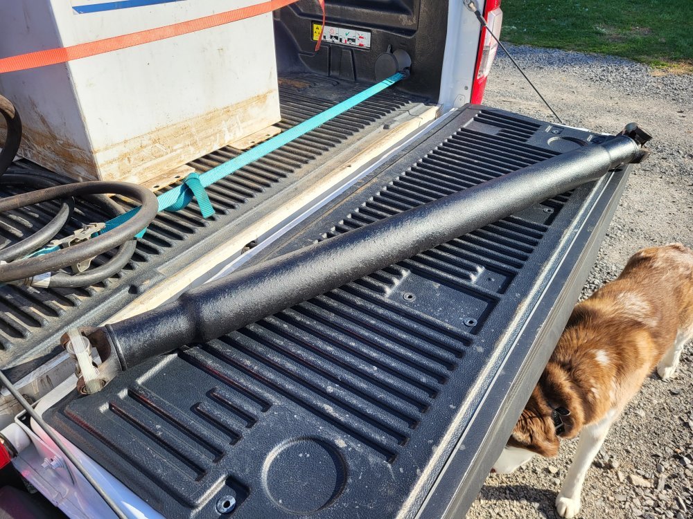

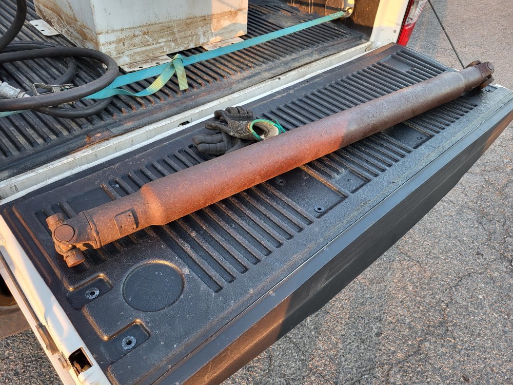

The above meant I needed to drive my Yukon to work. Leaving me no time for driveshaft reconditioning. I only pulled the rear to get a quick day turn. The u-joint at the rear diff is nearly seized.
Shaft has new HD non-serviceables and a balance.
Noticed a leak originating from the pinion nut. Grabbed the nut and it was loose! Torqued it to an ugga dugga by hand for now. Will need to keep an eye if it comes loose again. I should have put some blue locktite on it now that I think about it. Wonder if the driveline vibes loosened it up over the trip....
How does that affect the depth of your pinion gear to ring gear meshing and the crush washer for pinion bearing preload, or is none of that a concern with that style/year of rear differential?
To be honest I think it is a concern. I believe there is a crush sleeve in there, I just tried to tighten it up and not crush it down anymore. But no real way to know at this point. Really needs to be checked with a dial indicator on the ring gear along with pattern.
I would like to milk this set out until I swap to 4.10s.
I slightly crushed one down once. Took a pinion shim and stacked onto the crush sleeve then readjusted crush and called it good.
