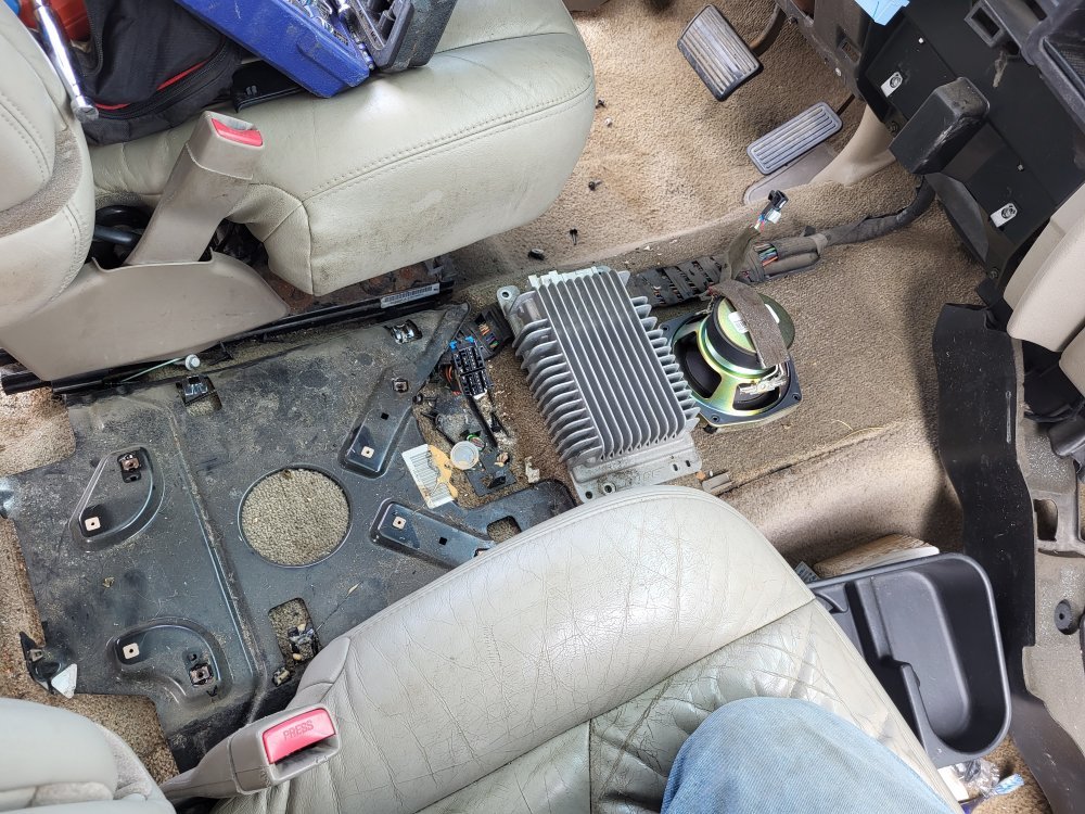

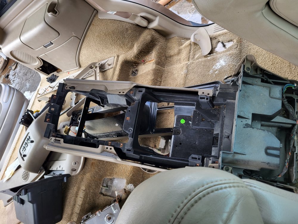

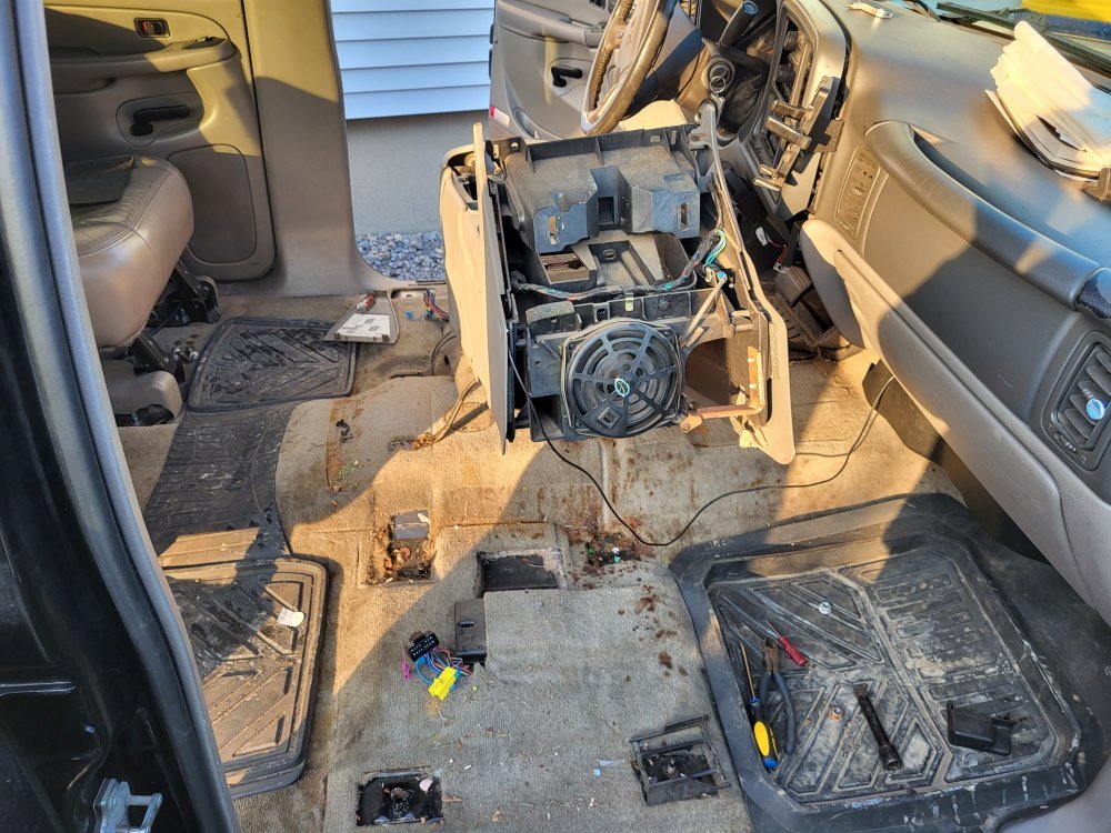

Anyone have a good knowledge of the OEM bose system on 03-06 trucks? I have no function out of the OEM console subwoofer even with the selection on the radio maxed. Tried a junkyard subwoofer, and then a premium "dumb" amp. No changes from my current ones. All door speakers work fine. So my issue seems to be somewhere else.
Is there a separate fuse somewhere I am missing for the amp/sub?
No knowledge of those. Just basic sound man's experience. Start at your speaker, make sure it works. Check connections from speaker to amp. Disconnect plug to amp, with key on Acc, make sure there's power to amp. Check signal path from head unit's output plug to amp's input plug for continuity. Check if the head unit is putting out a signal to the sub amp. Check head unit's settings to make sure there isn't a separate function that controls the sub's power/volume separate from the master volume. There could very well be a seperate fuse for the factory sub amp.
The more I sit and stew on this, I feel I am looking way to deep into it. Feels just like a blow fuse to me. Visually components looked good, I didn't have my multimeter to ohn out speaker. Will come up with a game plan to diagnose further.
there should be an amp wire at the back of the stereo (blue iirc) that sends a 12v signal out to the amp to tell it to power on, then there should be a 12v power wire to the amp that should have constant power from the fuse box and to the battery. or at least that is how I remember most factory units are wired up.
not sure if I have one in my collection but there should be a schematic posted here somewhere that should show how it's all ran. I would test all those connections and verify powers and grounds, then verify sound is being sent. the easiest way I would know how to do this is have a small dumb amp that you can manually connect to the sound inputs and power direct to a battery to test for the boom booms to flow.
