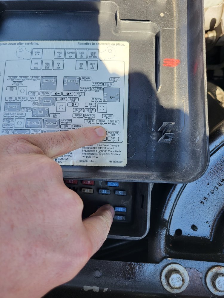

just out of curiosity, did your yukon have an amp in there from factory? only reason I ask is because normally the harnesses will be there even if ti didn't have one installed off the assembly line, but the radio head unit it's self might not have the option on it which would lead to the amp signal wire (blue 12v) behind it to have no connection to the head unit.
It has the UQ7 option code and is an SLT so I assume it came with the premium. It doesn't have Y91 code so no lux version.
I need to do more chasing with the multimeter.
I don't know what all the RPO codes mean but it might be worth a visit to your local Chevy house to ask if they mean it's got that option. of course, that is if it's still got the factory stereo head unit installed. could be time to invest into a fancy aftermarket head unit too!
I have by eye on one listed on the jungle site. watched a few independent review videos on youtube and they seem to be really decent. has the wireless or wired andorid auto / iphone carplay which I like to use for the GPS and whatnot.
here is the link to it... even now shows a $30 coupon 🤔 I might just take the plunge. I've been growing tired of the old Kenwood unit I have because of the bluetooth connection is a PIA to re-connect if I walk too far away from the truck with it still connected.

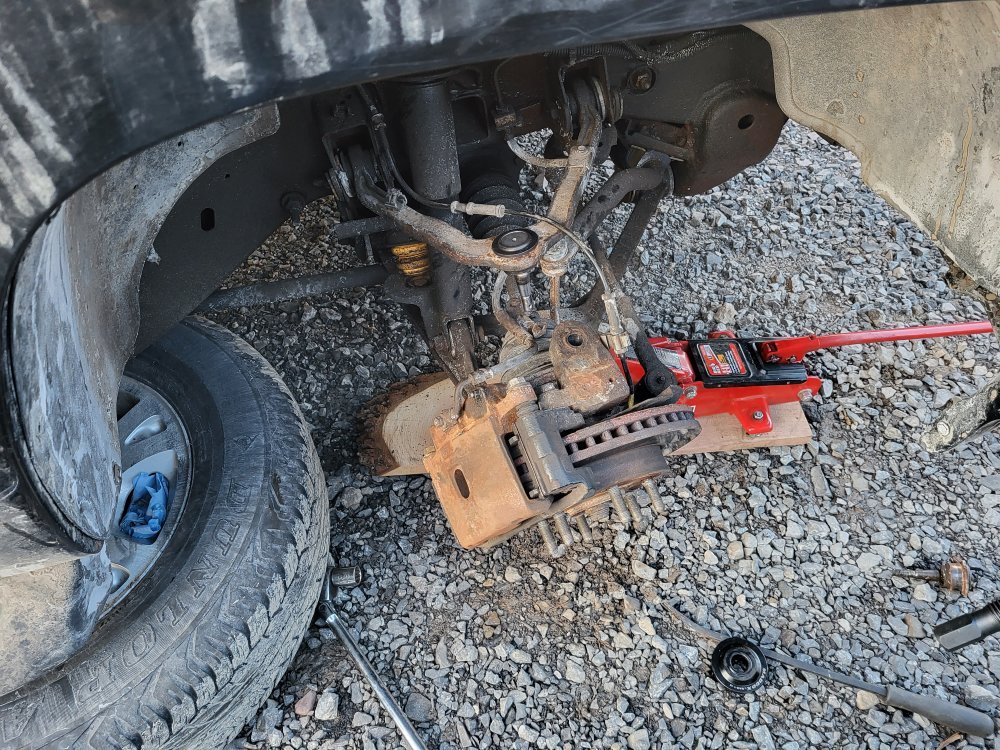

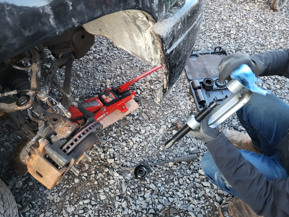

I bought mine back about 2012 from Harbor Freight on sale and with a coupon, set me back about $50, to do the uppers and lowers on my Burb. Have used it since to do my ex-wife's uppers and lowers on her old '05 Trailblazer, my mom's old '95 Contour, my '94 P/U's uppers and lowers, my neighbors' vehicles. It's even great for retracting brake caliper pistons, too! It's "paid for itself" several times over!
Never had a lick of problem with my HF unit. I do keep it maintained and always put a dab of grease on the threads and run the screw back and forth through the frame to spread it before using it and another small dab on before beginning tightening.
Yep. My cheapo held up well until I overdid it. I don't think you're supposed to put a breaker bar on them
I've used my ½" drive, 575 lb/ft air impact on mine (not at the full 5 setting, just the 3, which I'm guessing is up around 300-350 lb/ft of torque) which is definitely NOT recommended, but it was a matter of expediency and working room to get a rather reluctant ball joint to finally "pop"and push out of the control arm it had been in for an eternity, after using the box wrench and my ½" drive rachet and socket didn't get it to budge!

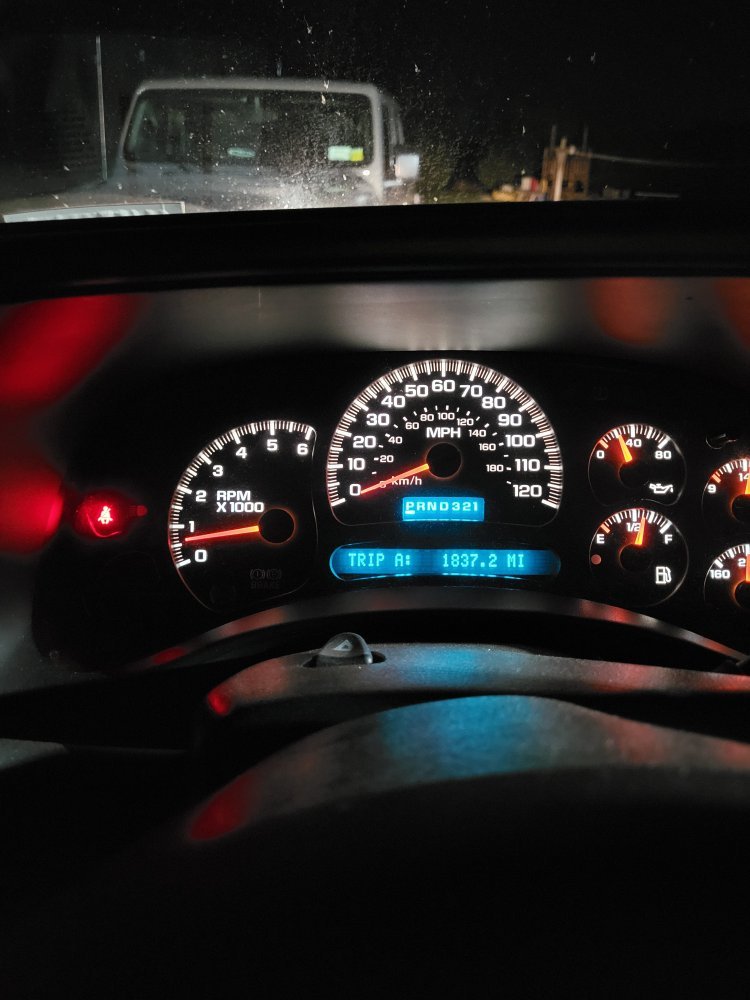

First off i started noticing a driveline vibration on the way down at 75 to 80-MPH. Never had felt this before, but rarely get to 75-MPH locally to home.
I did get the notorious u-joint squeak starting faint while coasting, then becoming more pronounced during acceleration while we were down in TN. Checked the joints, no play noted. We did check for play prior to leaving too, but this is something you just can't identify!
Total trip:
We will be pulling the rear for new joints. May be pulling the front as well for piece of mind.
