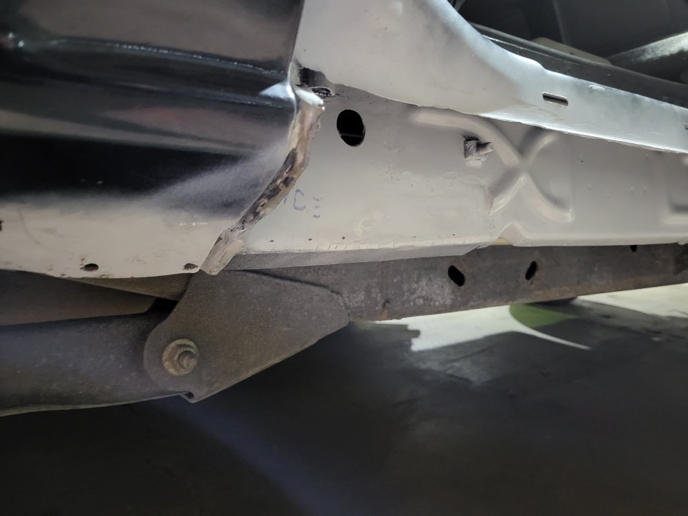

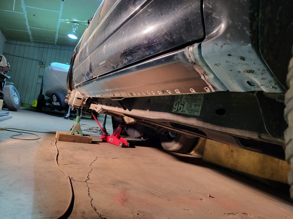

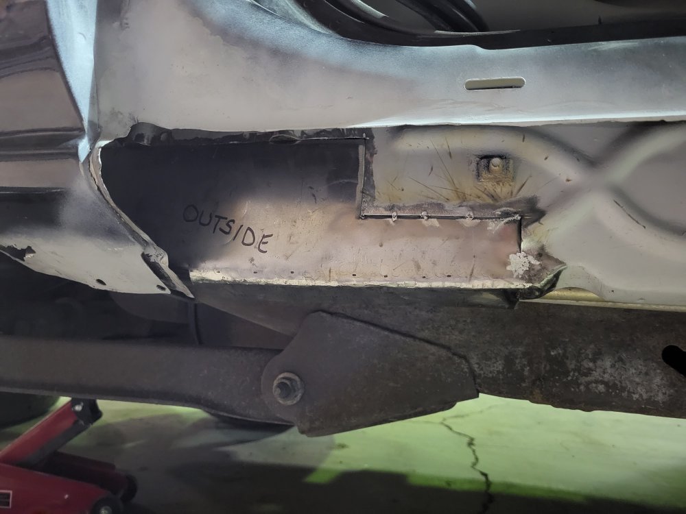

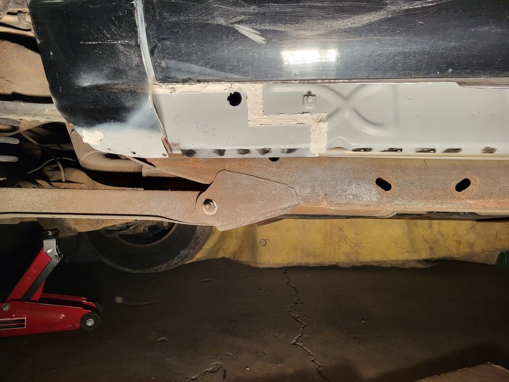

I have gone through another small sheet of material from Tractor Supply to practice on. The bead is getting better looking, but still ugly as expected with my novice ability. I dialed the setting back to .5v, 101A. This seems to be better for the consistent bead. One thing I am seeing is that the "old" metal is better matched with 18ga., I have been working with 22ga, and 16ga as it is readily available locally. I cut some scrap off the "best looking" part of the rocker and threw some tacks to it, and blew through. Settings will need to be lower for butting up those pieces for sure.
I've been messing around with outer rocker fitments for now, grinding, cutting, fitting, etc. Our trip for TN the first week of April has been booked. I need to get moving to get this unit done for the trip. This year we were planning on not going, but the entire family wanted too. Kinda has me in a time crunch.

Easy to blow through rusted part that you will keep is what make me think you need to practice actually welding short beads first.
If you blow through the original metal- the easiest technique is start the weld on the new metal and roll into the old stuff when welding them together. If you are running so hot that you can only bump the trigger- you can’t do that.

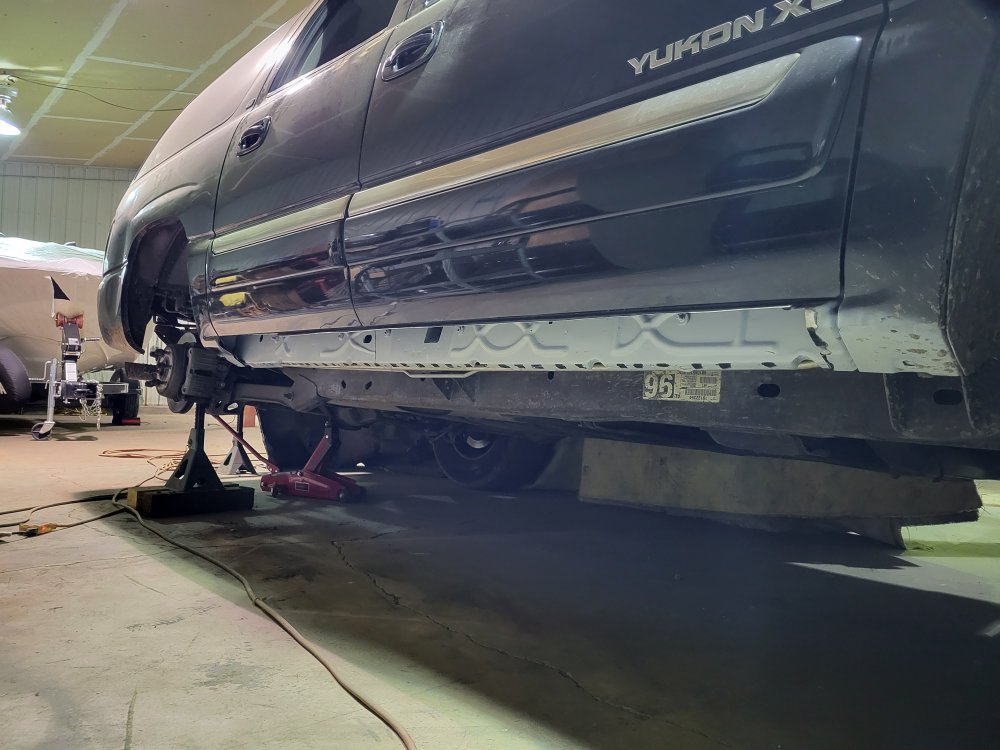

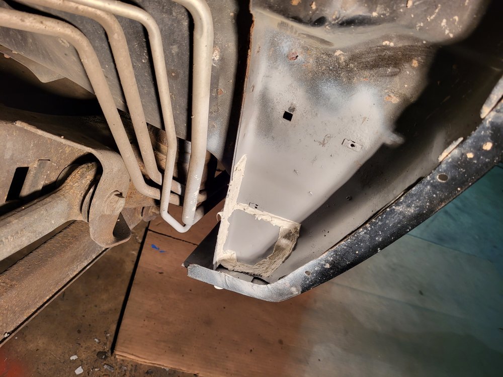

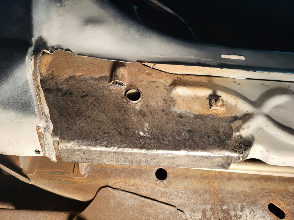

Been messing with the welder here, and there over the last few weeks. Getting better throwing down a straight line. At the point where I am going to give it the send on the Yukon. Been spending most of my time prepping the outer rocker, cutting, fitting, trimming, pondering, trimming, and finally wondering what I am going to do in the passenger rear corner of the outer as the rusty metal extended past my new rocker boundary.

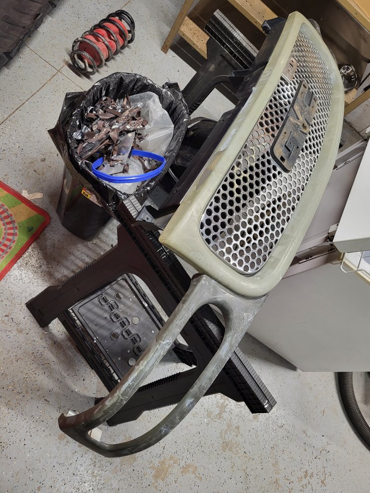

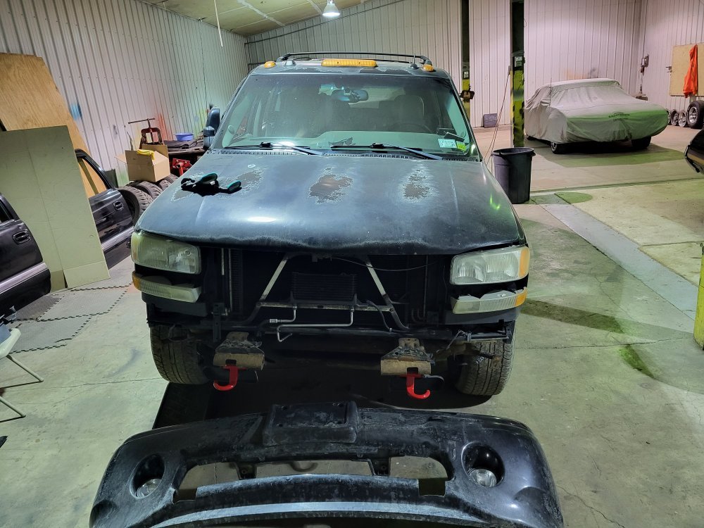

Made a trek about 1.5-hours south to a different junkyard. Ended up finding many things that came home with me:
  • Black front denali bumper with fogs.
  • Black denali rear bumper.
  • Denali license plate bracket.
  • Drivers headlight bracketry to core support.
  • Airlift 1000 coil bags.
  • OEM 2500hd cab lights.
  • OEM GM cab light wiring harness.
Bumpers have cosmetic issues, but solid. Rear does have heavy scale on the framework but will keep eyes out for eventual replacements. Looks like denali conversion it is.....

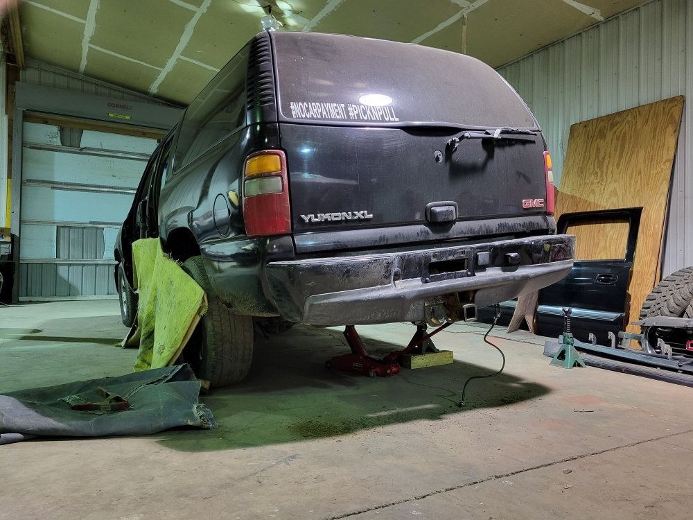

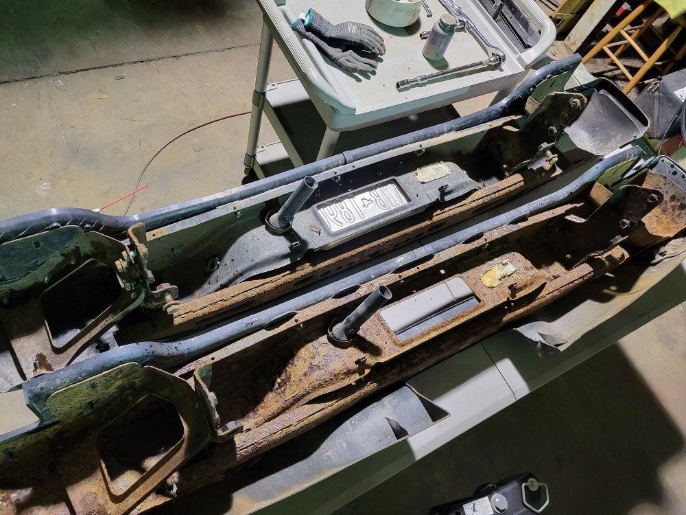

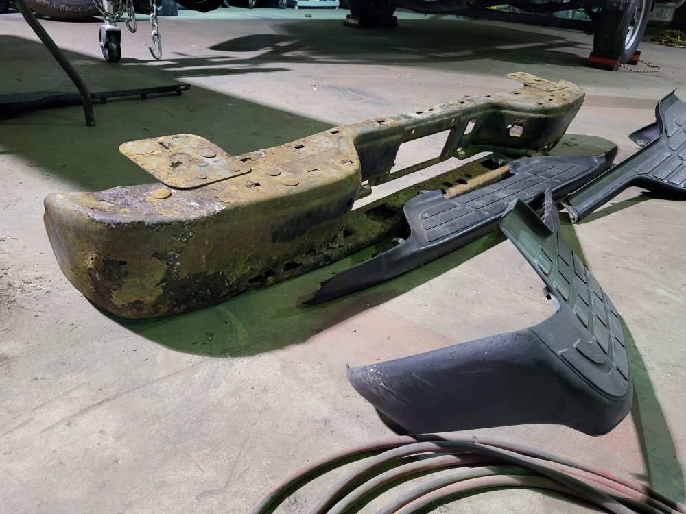

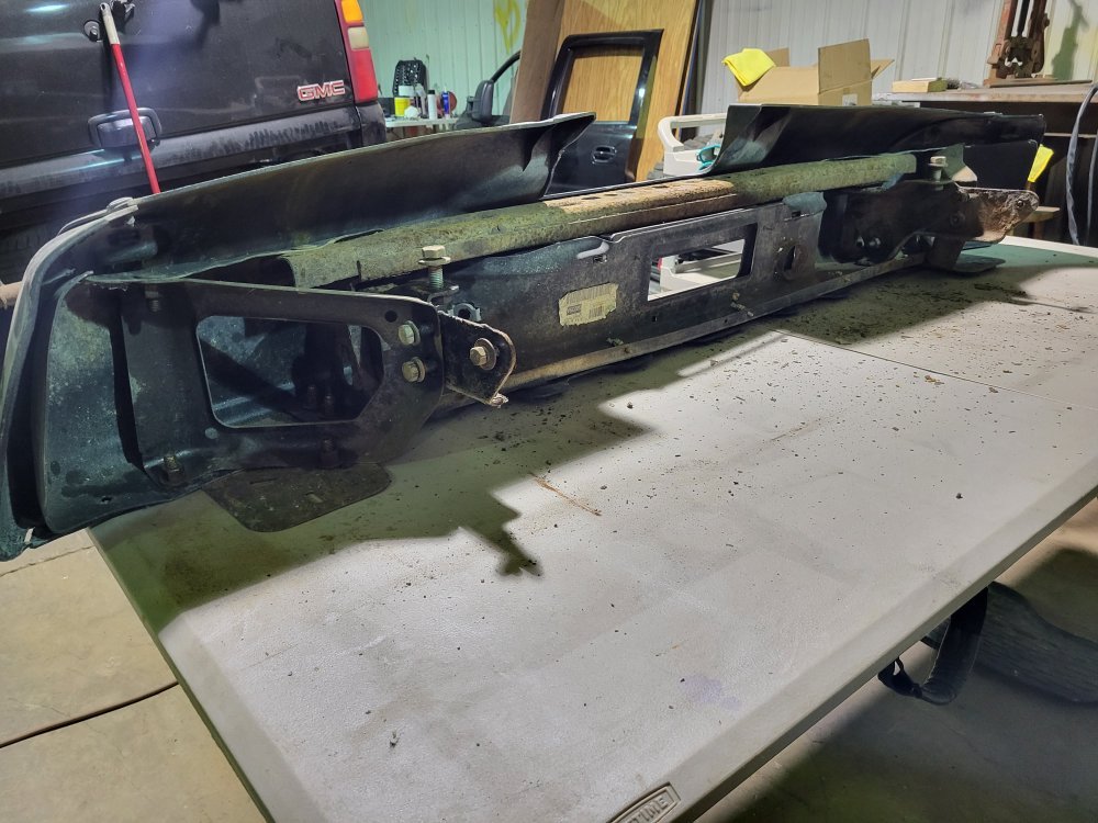

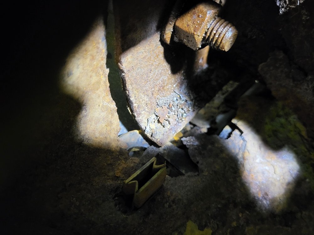

Learned a lot today about rear bumpers. Specifically interchangeability of the SUV bumpers. I am very disappointed with the rear denali bumper I bought off a FB marketplace sale. Its my fault, I should have inspected it more closely, but 0-degree temps I gave it a rough look, and loaded it into my truck. The inner supports were severely rotted.
Went back to LMC trying to locate the inner pieces. After further research I found out the bottom hitch/step support is identical on all bumpers. But the issue is the inner shell was the rotted off part. Inspecting my bumper closer I couldn't help but realize how similar they were.
I proceeded to remove the denail bumper cover and exposed what seemed to be a GM Z71 package painted steel bumper.20230208_162417.jpg
I removed the pastic trim pieces from my chrome dented up bumper and slid that into the denali cover, amazingly everything lines up!!!
This saves me from needing the $130 steel bumper to insert.

My original plan was to sandblast the internal parts, paint, and install into the denali cover. Upon further inspection my chrome one is actually in decent shape just all dented up from jack-knifed trailers. Worst part is the hitch reinforcement piece. I'm quickly realizing I need to get moving faster on this project. It needs to be ready for our family trip to TN first week of April.
