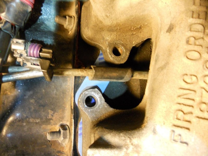

So take care of a couple things. First time I had a fuel leak at the IP lines. So bad it dropped a cylinder out. Used an extension and 4 hands to get to it with the intake still on. Yes threaded extension and crows foot under intake. Then adjust the TPS.

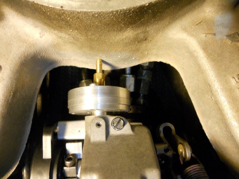

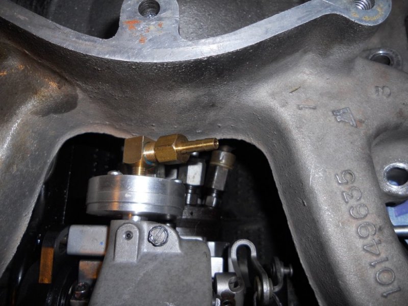

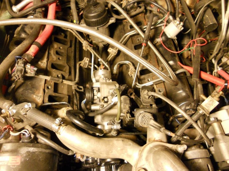

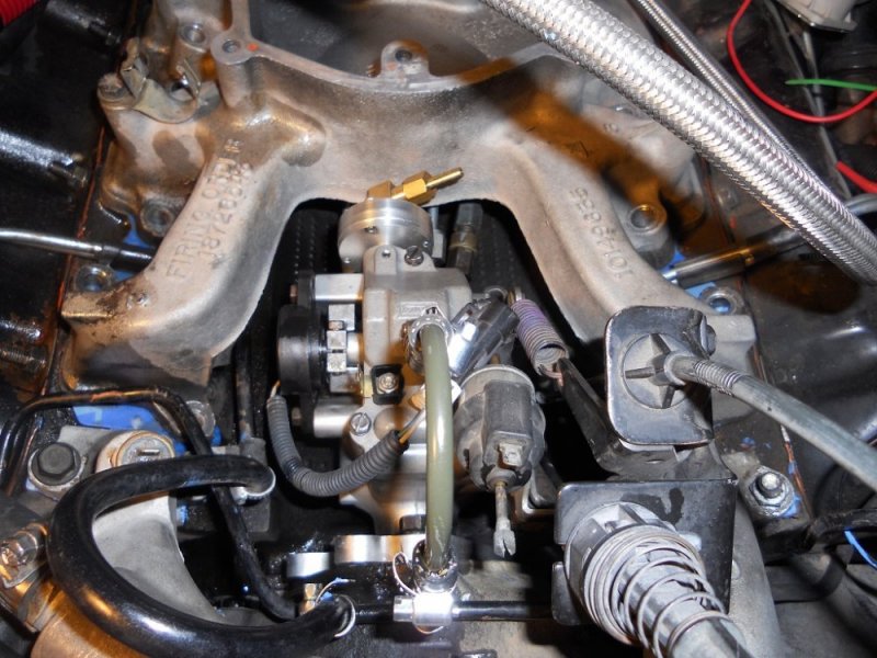

Had to re-invent the fitting on the smoke puff limiter as it hit the intake. Pics later.

I wonder why you had clearance issues with your aneroid and I didn’t? Mine was close, but doable. Hmm.
