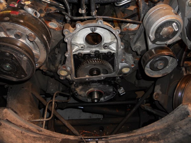

How do the bolts look that go through the backing plate into the pump- any wear on those?
Ip mounting bolt length?
No wear on water pump bolts. No witness marks on the sides of the gear indicating anything rubbing. Best I can guess is it's from having several pumps swapped out. The last useless pump had a lot of trouble going in as it wouldn't get the gear on properly at first. It wanted to wag/wiggle the pump locking the engine up when I tightened the pump bolts up. This cockeyed engagement of the gear could have caused the cover scratches and picked up material, or even chipped the gears from misalignment, to run through the gear set. Several tries of installing it and test fitting the spare IP gear I had laying around finally got it installed.
Oil change, due anyway from coolant contamination, may indicate other debris.

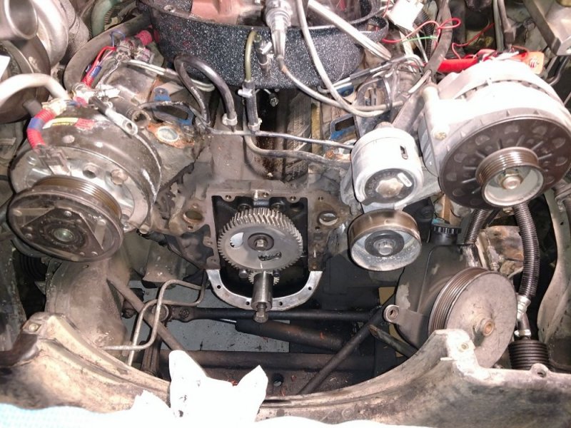

The timing set looks small vs. the IP gear set (and chain sprocket.) Checked clearance to the cover by carefully bolting it on without a gasket and reaching in and feeling both gear drive axles still move. You don't want to trap them between the block and cover. I have a spare cover if there wasn't clearance and "crack"...

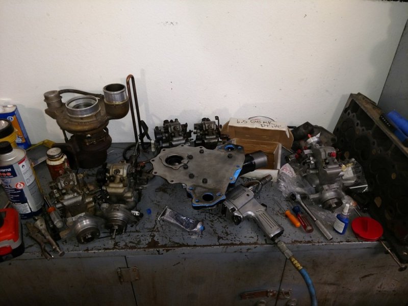

5 IP's, paperweight 5.9 turbo, and a spare head... WP mounted. The water pump backing plate still has the WP shaft outline in it from the Elk encounter where it got "hammered". Yeah that locked that water pump up...
