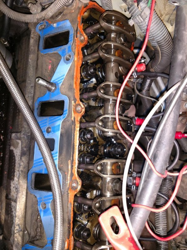

 but if engine was cold was thinking you might need to warm up a little, if its doing it hot it shoots that theory down.

Actually, Toombs was paraphrasing Will Rogers who said that about Oklahoma, renting it out and living in Hell.No smoking gun under rocker cover.

So did you ever get resolution on this? If so, what was the problem?
I started a new thread. The old pump destroyed the engine is another carnage thread entry. The Zombie engine still ran and "new" Moose IP/Injectors didn't help much on a blown engine.
I started the Moose call with: "After poor Patch has been sitting for months with officially failed emissions..." Hindsight being 20/20: It should have failed at the governor test, that is done before the snap test measurements, that ran up to 4200+ RPM on the old pump before I got the Moose pump. As the engine still ran I had no idea 4200RPM bent all the valves, broke a valve spring and possibly wiped the cam. 3600 RPM is redline. It had run fine up to the emissions test and I thought it would pass. It accelerated slowly after the governor test blowing white for the measured SNAP smoke test. The replacement Moose pump only passed because I showed them max required repairs of $500 and got a waver. Specifically a Moose Pump receipt for like $1200.
A compression test showed the cylinder with the broke valve spring having the min 320 and the rest 200-260 psi.
