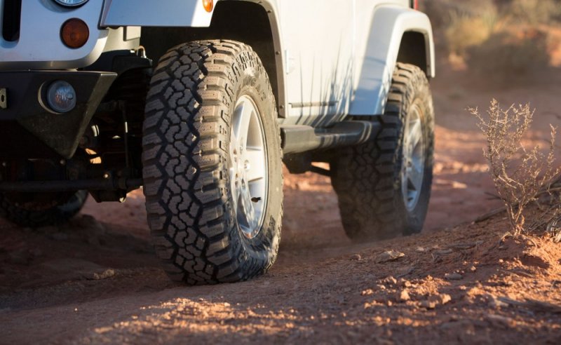

These are the tires we got for the JK, supposed to mimic the Duratracs that were $300 more. Wanted a tire for the Fiance that was good in the winter. Supposed to be here tomorrow. 35'' flavor.
Got the tires installed mid last week. So far I am happy with them. Last week it snowed about 2'', then last night it snowed another 4''. The tires did ok in the slush, ice and snow. The truck definitely needs weight in the back, as the rear brakes sometimes lock and the butt end comes around. The tires were capable of pulling the truck out of the driveway which is uphill through the plow berm left at the end with minimal spinning.
