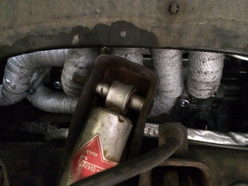

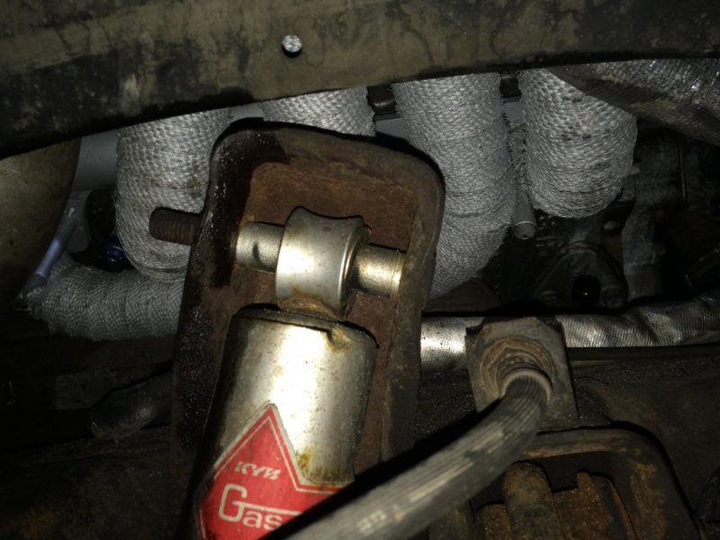

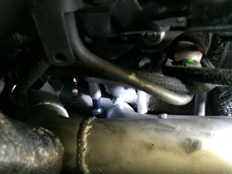

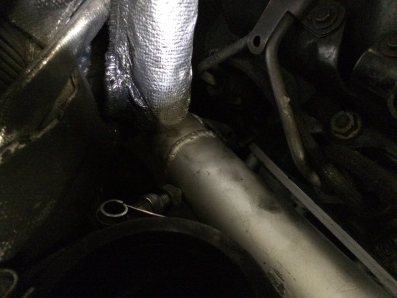

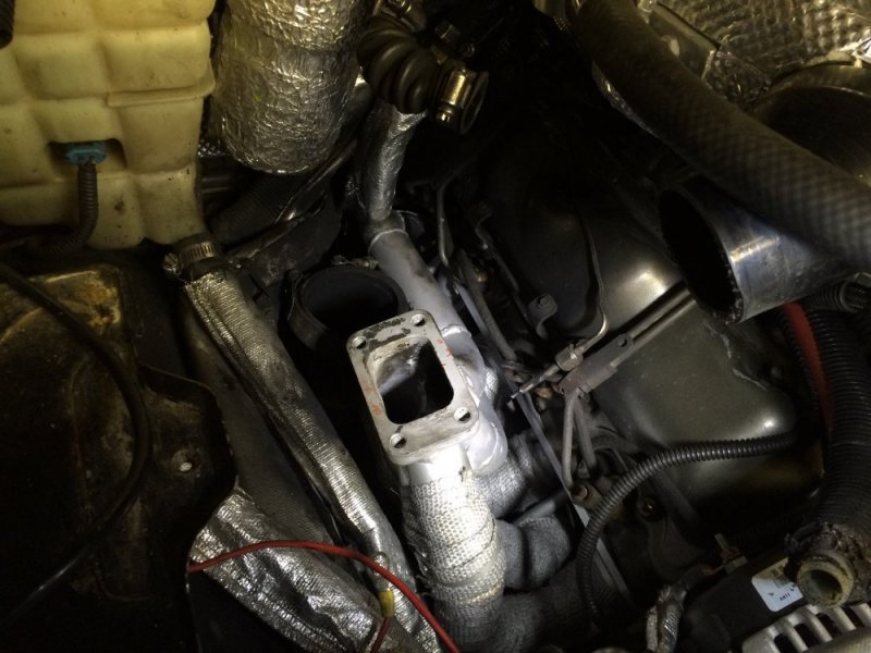

It fits!!! Well mostly. It's touching the heater hose now, but I can see how to make a slight adjustment to the header so it will clear that and still have room for everything else. I'm stopping for tonight but will pick up tomorrow with the header mod. I'm almost there!!
Oh and I think I will have to mod the drain tube a bit but will know more once the turbo is mounted. That shouldn't be a huge hurdle to overcome.

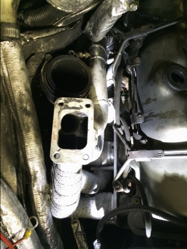

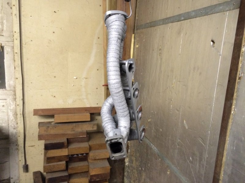

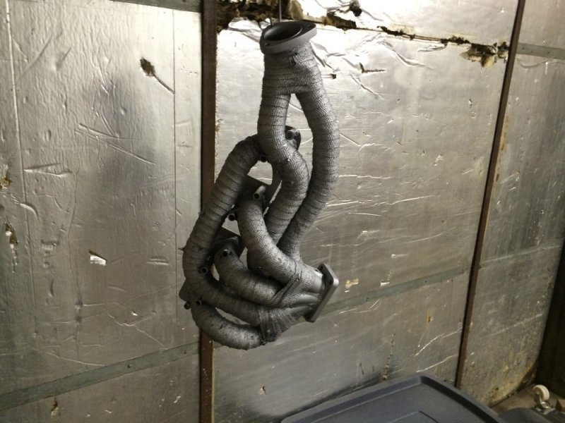

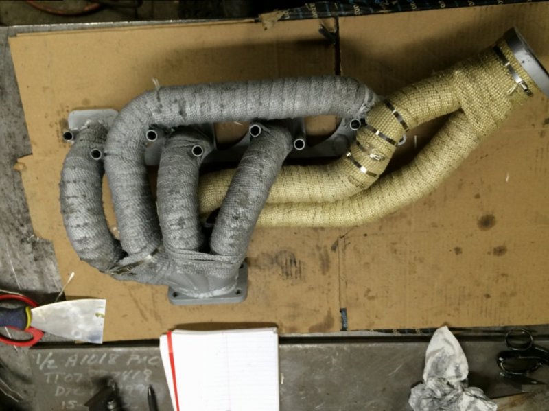

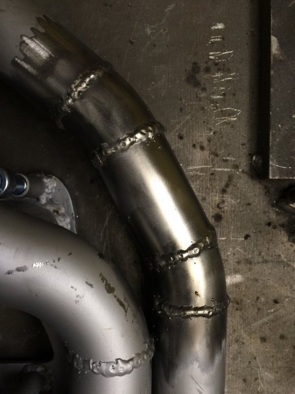

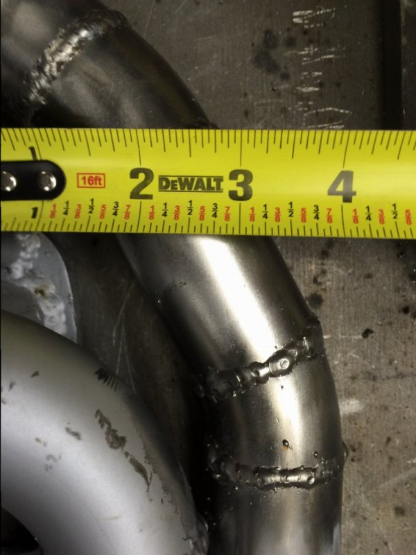

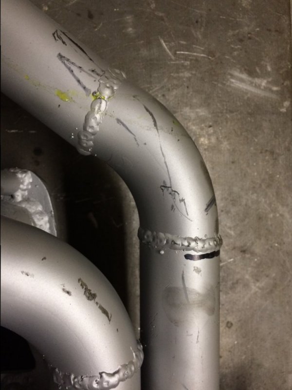

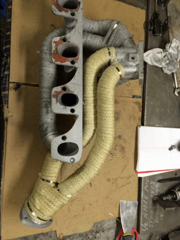

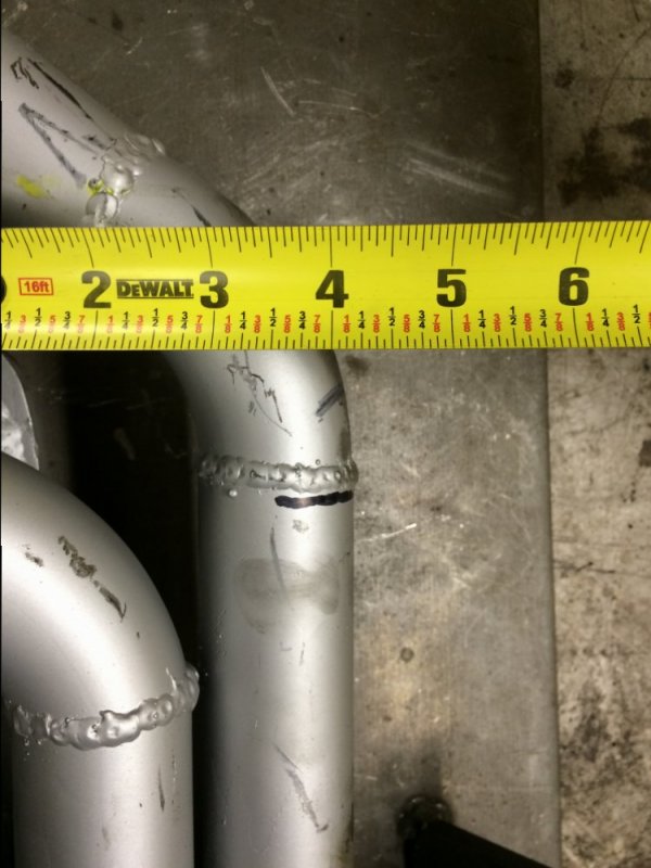

Success!! By cutting out the existing bend and breaking it into two bends I was able to gain about 3/4" of clearance right where I needed it. So tonight the fab work is truly done and I got a coat of paint on it. Tomorrow night I will wrap it and put final paint on it. Then Saturday should be installation and oil drain rework.

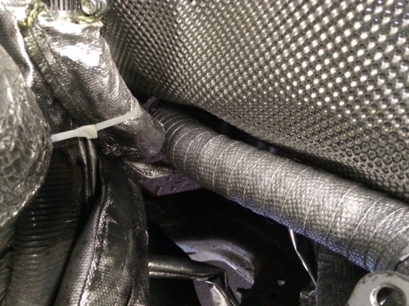

Yes it's still kind of close to the heater hose so to handle that I'm going to put an extra layer (or maybe even two) of heatshield on the hose. Plus with the wrap on the header I should be ok.
More tomorrow!

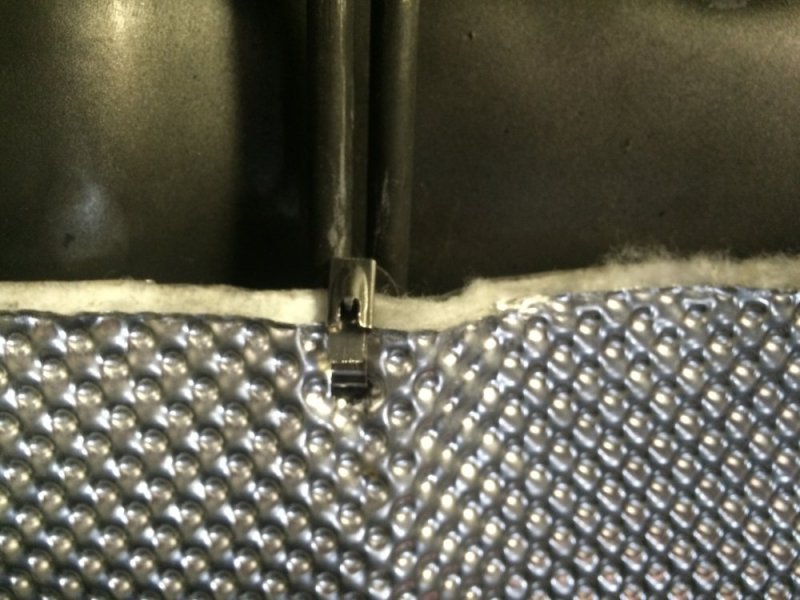

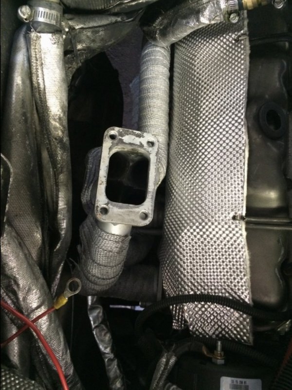

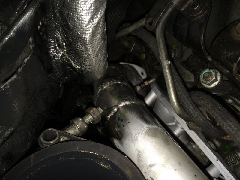

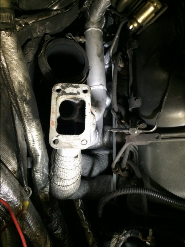

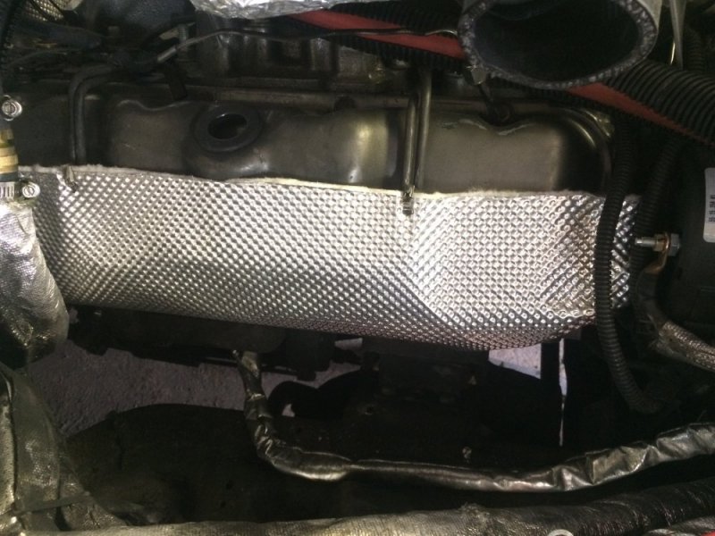

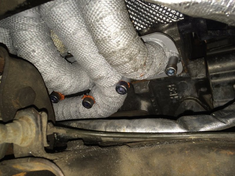

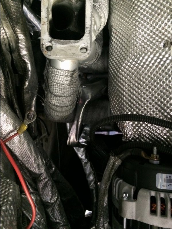

Here is today's progress so far. Since the original heat shield no longer fit I made a heat shield out of Tunnel Shield to keep heat off the fuel system. The header is installed. It's a bit tougher to do the bolts now but hopefully I don't have to mess with them too often. And then I had to extend the front and back glow plug wires. The rear was extended about 10" and the front about 14". The wires will be tied up so they aren't touching the header once everything is in place. I'm stopping for lunch now but soon I will be installing the down pipe and turbo.
