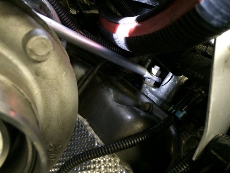

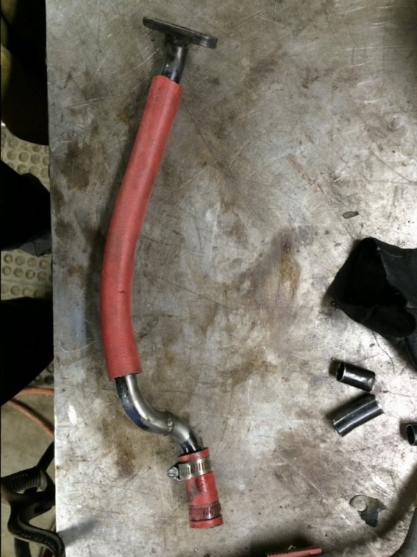

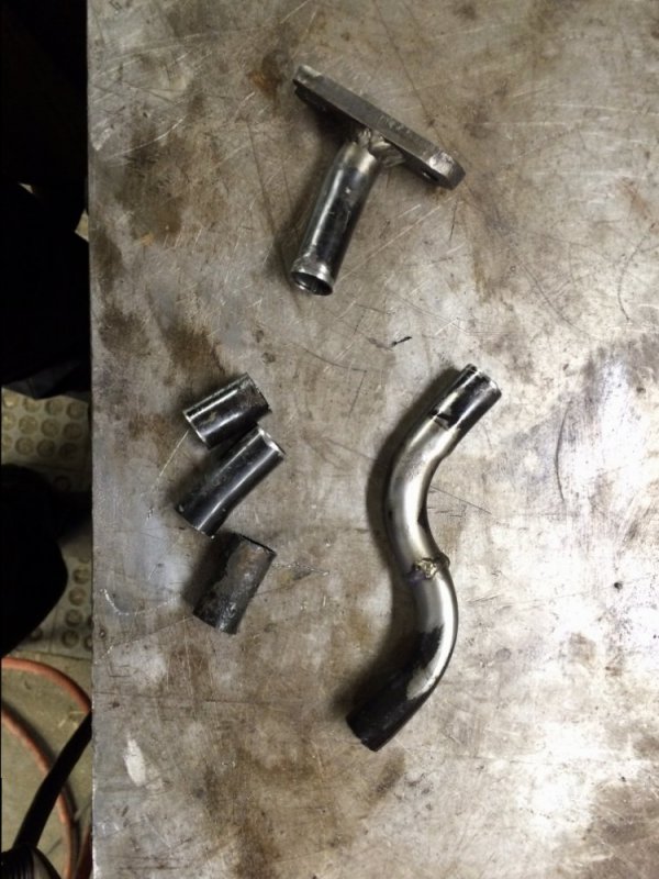

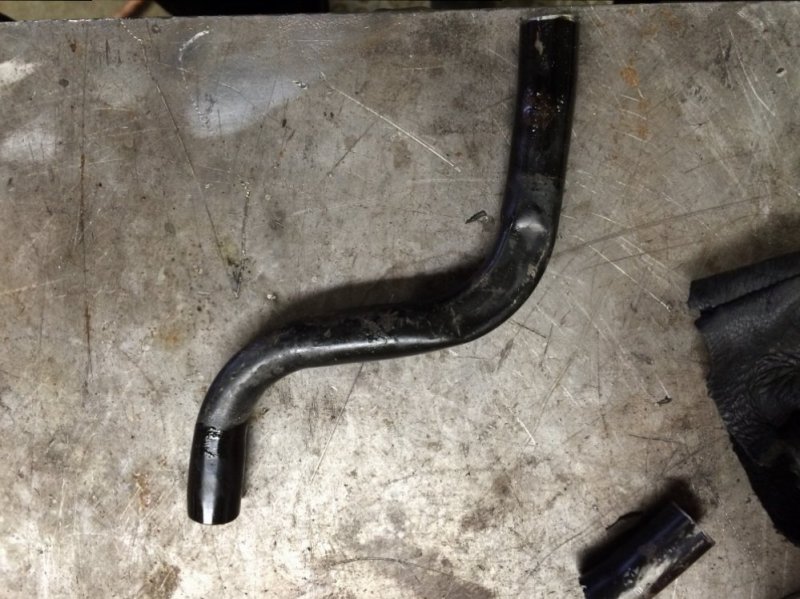

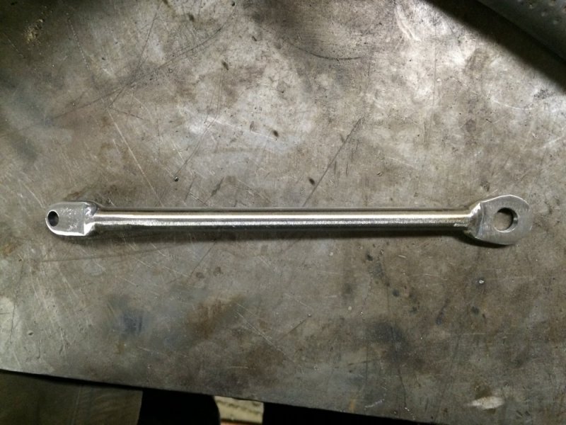

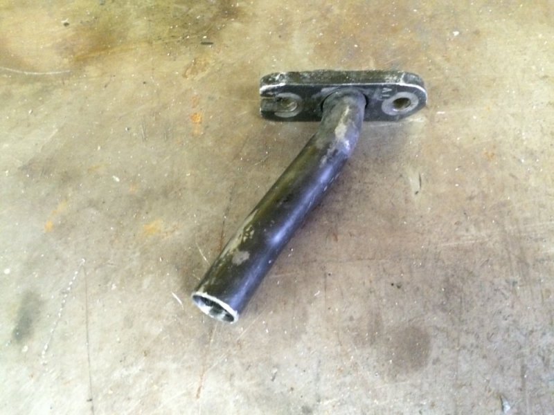

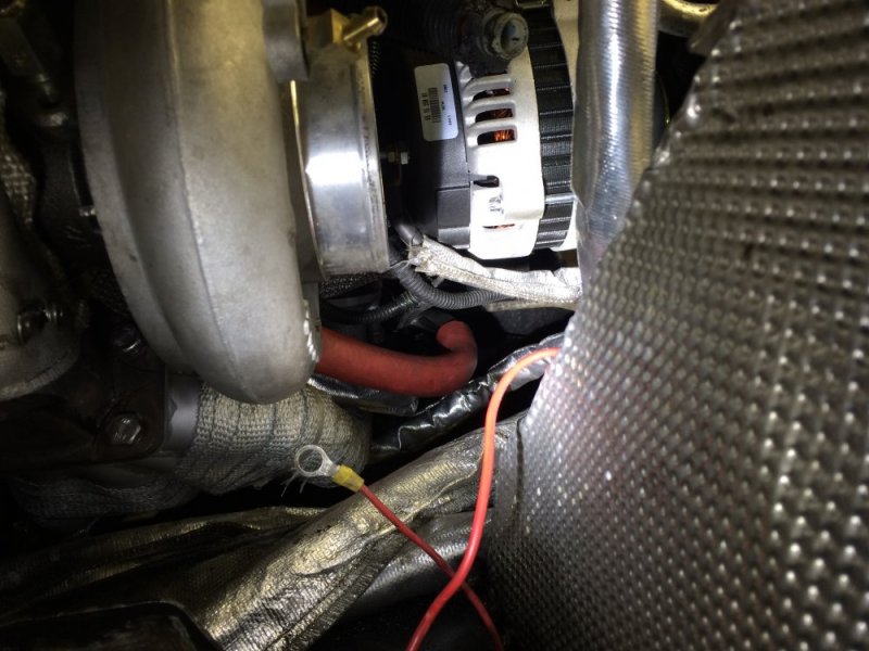

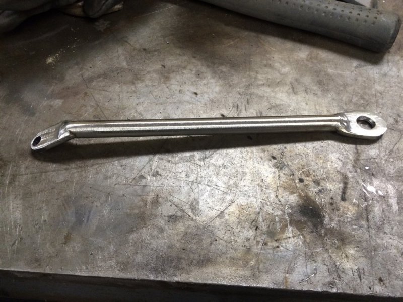

Crossover and downpipe are installed. So the next thing was modifying the oil drain to fit. It didn't go too badly actually-I cut and rotated the pipe at the turbo and shortened the offset pipe at the bottom. Then I only had to make a hose that was about 2" longer and luckily I had some extra Multi-Purpose tube lying around. The parts have paint on them and are drying so they'll be ready for installation tomorrow. All that's left for tomorrow is making a brace to support the turbo and take some stress off the header then install the intake, wastegate actuator and battery. Should be running tomorrow!

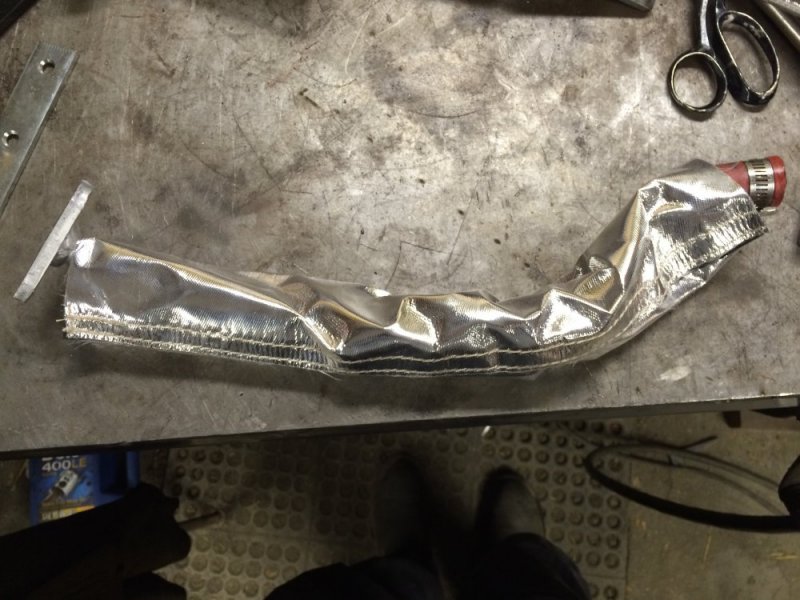

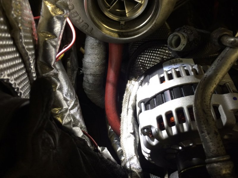

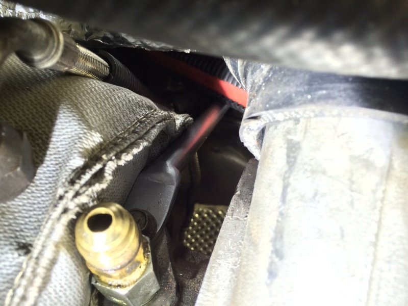

Oh and I got so wrapped up in the results I forgot to post the last details of the build. Here are some pics of the oil return line and the brace between the turbo and the intake.
