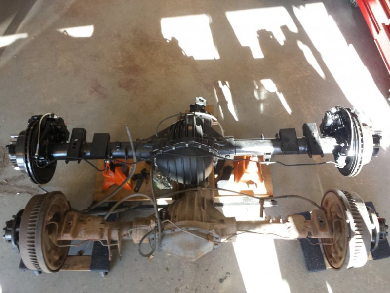

Husker6.5
I second that. Find a 3.42 and you'll have the best of all aspects.IMHO: Dump that rear and go 10.5" FF and never look back.......
I don't hate the idea of a 10.5 FF, but converting one to 6 lug is a bit pricy. Wouldn't you know that Yukon gears have dropped in price since I did gears last summer....![]()
Oh, there's the complication, nope my Tahoe is 4WD. I still have a hard time believing it's not doable, but without a roadmap I'm not super passionate about taking the time to try to figure it out.....at least not right now.2WD, right? The easy and cheap way is just pull the complete knuckles off of a 2500 diesel or 3500 gasser/diesel and swap them. Of course, I would install new ball joints and tie rod ends while I had it apart, new calipers, hardware and pads, but that's just me. Everything bolts in easy-peasey, no reaming, welding, etc.
Which front differential is in your Tahoe? If it's the 9.5", it's still just a complete knuckle swap. If it is the 8.25", let me do a bit of research and get back to you, it is doable, just a question of what needs to be swapped out to do it. GM wasn't stupid, rolling down the assembly line everything was bolt on/in as the vehicle went by. It may be nothing more than a knuckle and CV shaft swap, but I have a feeling it may mean swapping the differential, too. In which case it would mean making sure the front driveshaft front U-joint yoke matches the differential's, ie: a shaft shop cutting off and welding on a new one. Still, pretty much a salvage yard wrenching project.Oh, there's the complication, nope my Tahoe is 4WD. I still have a hard time believing it's not doable, but without a roadmap I'm not super passionate about taking the time to try to figure it out.....at least not right now.

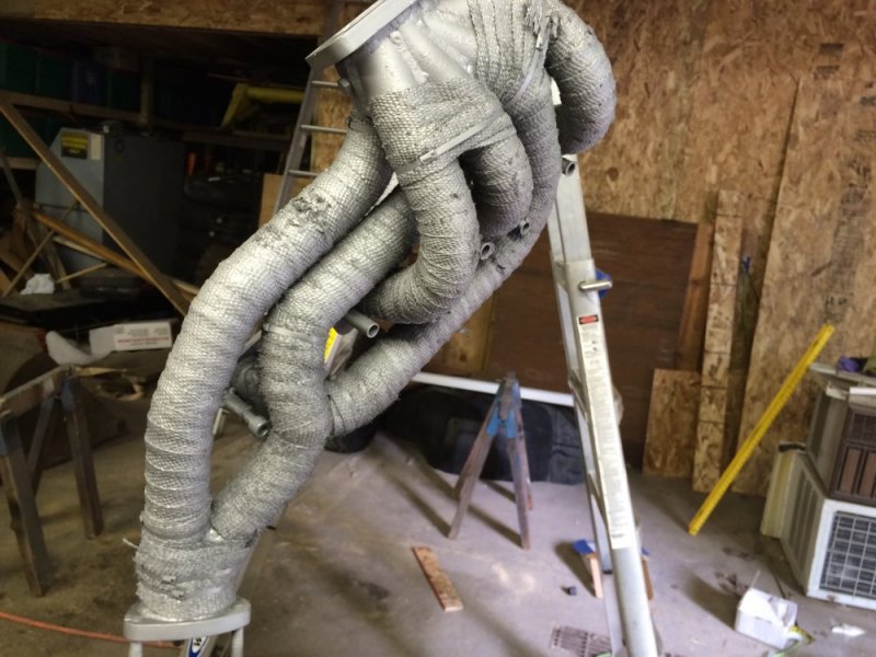

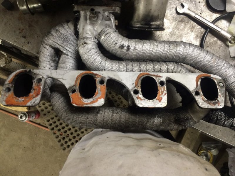

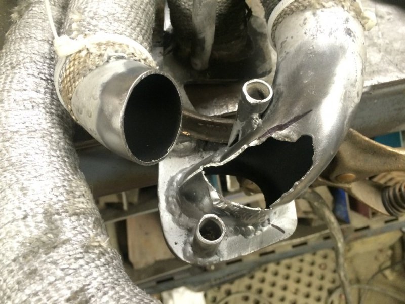

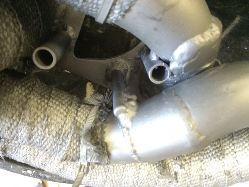

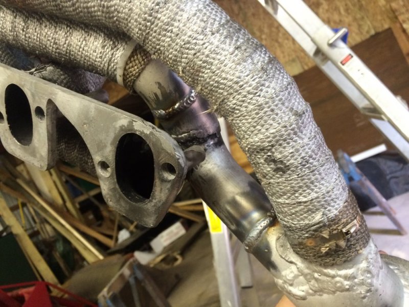

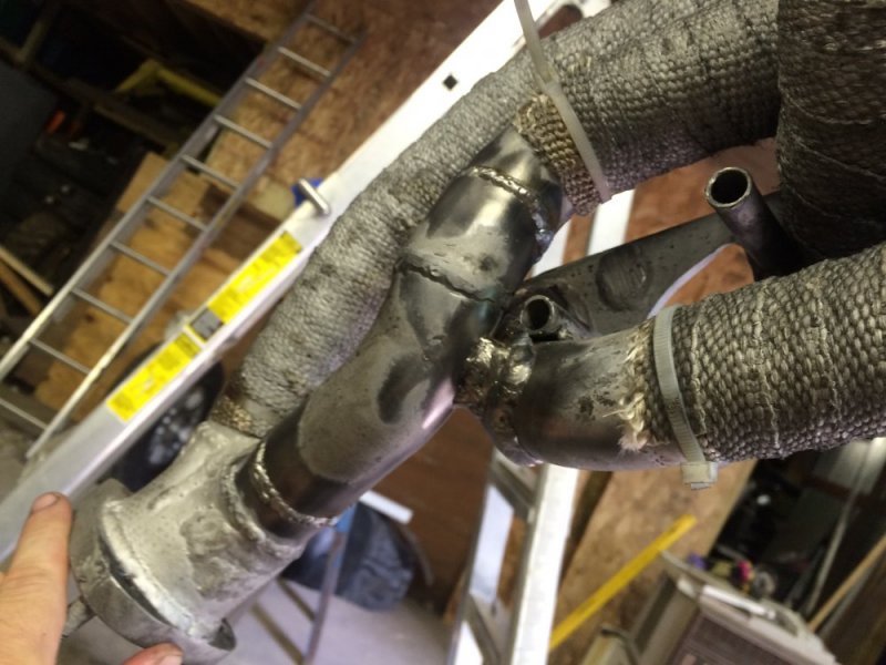

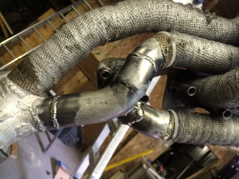

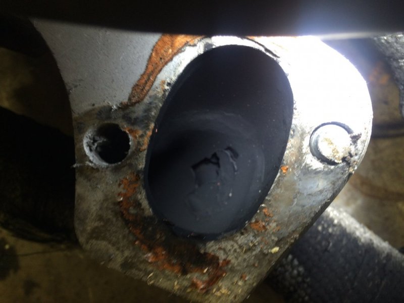

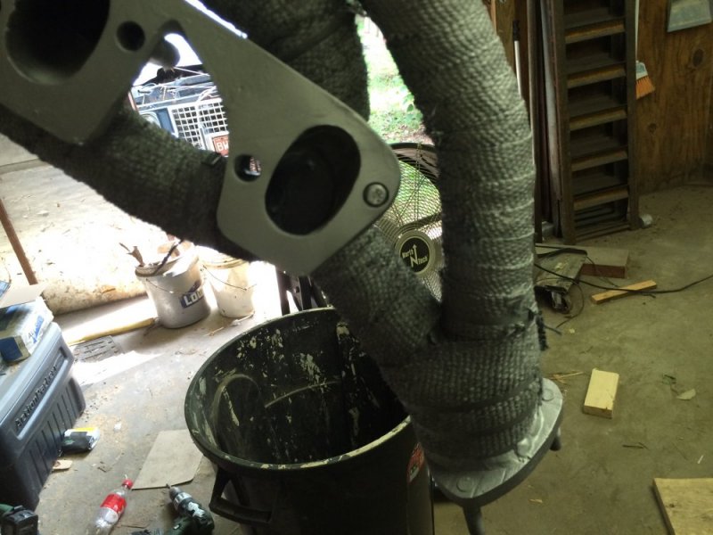

Your stuff is better than factory, no bean counter or congressional compromises.More nasa hose.
The bracket looks factory made.
Good job.
Thanks Dave! It does make it fun to leave the hood open at the gas station while I'm filling up.Your stuff is better than factory, no bean counter or congressional compromises.![]()

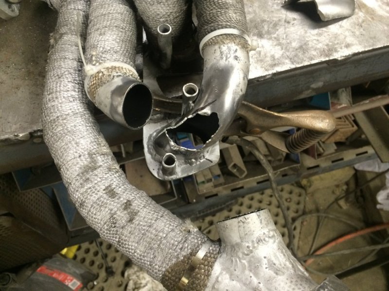

I guess with extreme heat #8 is moving around a lot more than the crossover and they didn't want to move together.
Tubes coming from drivers side would also cool faster than number 8 tube I think.
