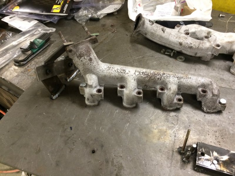

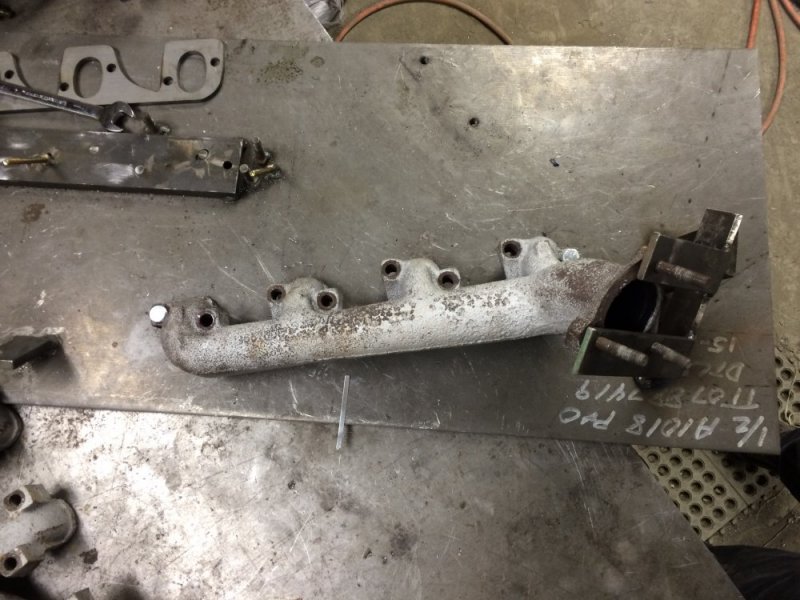

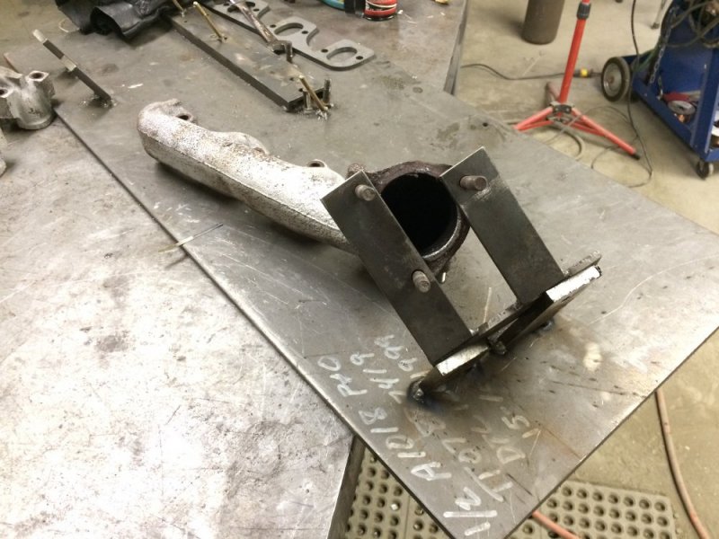

I added the provisions to the fixture for the driver side manifold. That will be a winter project. Time to get back to engine work now so I can get this turd back on the road.

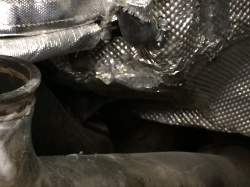

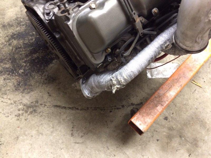

Well boo. Went to put the engine in last night with the header installed and it hits the firewall. So for now the engine is going to go in with the stock manifold and I will rework the header later to make it fit correctly. In hindsight, I hadn't really considered the clearance in that area as much as I should have, but without the engine in the truck while doing the fab it was hard to visualize where some of the potential clearance problems would be. Now I know and when I do the header update I will be able to check it in the engine compartment real-time since the engine will be installed. I guess this will actually be a good thing because I will be able to see and report how much of a difference just the header change makes when I do get it installed later. Also with the delay I may be able to do ceramic coating by then too - either DIY or the White Lighting by Swain Tech I've been wanting.

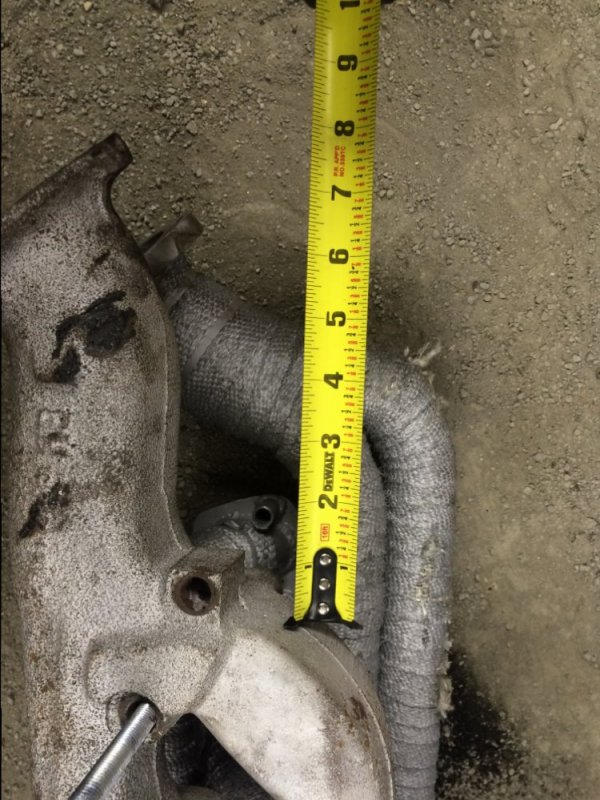

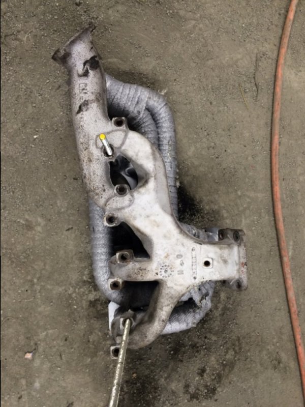

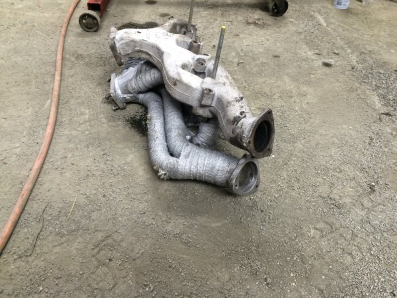

I put the stock manifold on top of the header today and there is a huge difference in how much more space it takes up. It's still manageable, but it looks like I got a little too greedy with space. I'll get it right next time.

That's a bummer Nate. But you will surely be able to make it work. And when you do, give me a price for one :)
Thanks. I don't think it's going to be that bad to make it work...and when I do it will help that the engine is in the truck so I can confirm right away whether it works.
Let's see....I'll use regular shop rate of $80/hour x 25 hours of labor.....that equals $2000. So sure, for $2000 I'd be happy to make you one! :D
j/k, I had originally thought maybe I would make more of them, but it was more of a pain than I expected so I'm not so sure now. Maybe I can figure out how to improve my processes and make it feasible to duplicate.
