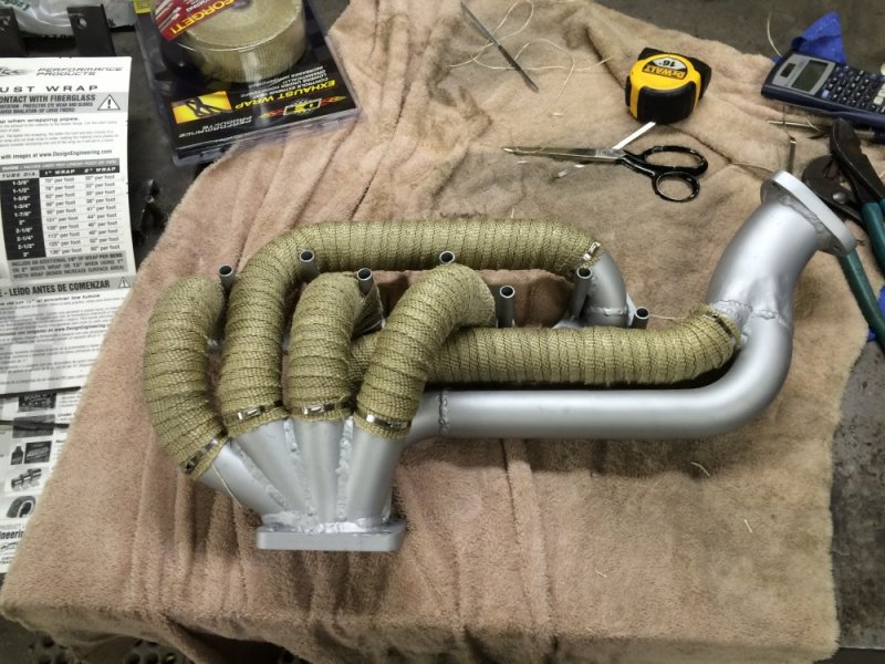

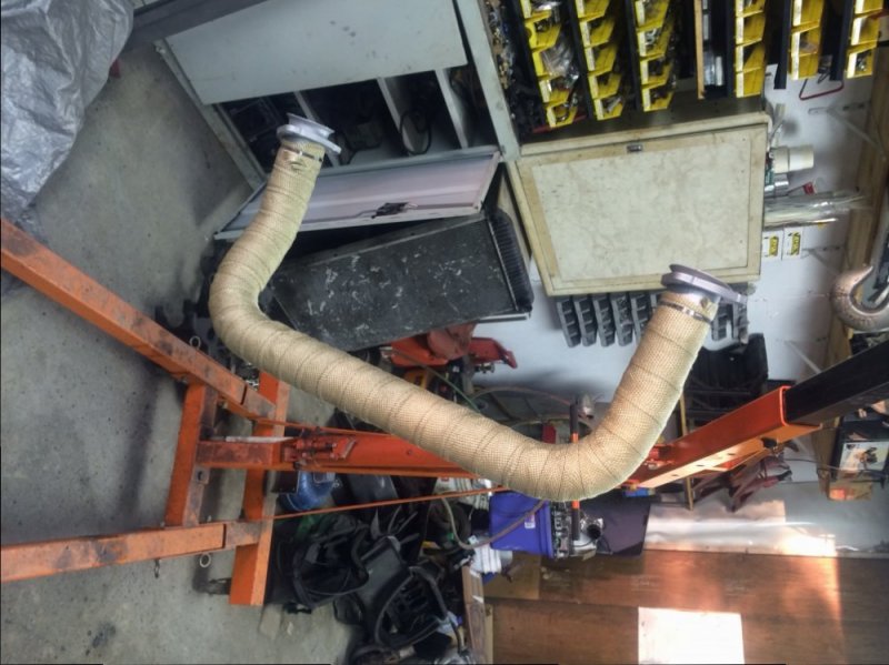

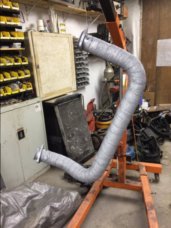

I got the crossover wrapped last night. It was so much easier and quicker than the header!! :rolleyes: I did have more of a problem with the 2" wrap puckering and I couldn't figure out exactly why, but it turned out well enough. I'm going to paint it up tonight and I should also have more 1" wrap by then too so I can finish wrapping the header. For some reason the picture keeps rotating, sorry.

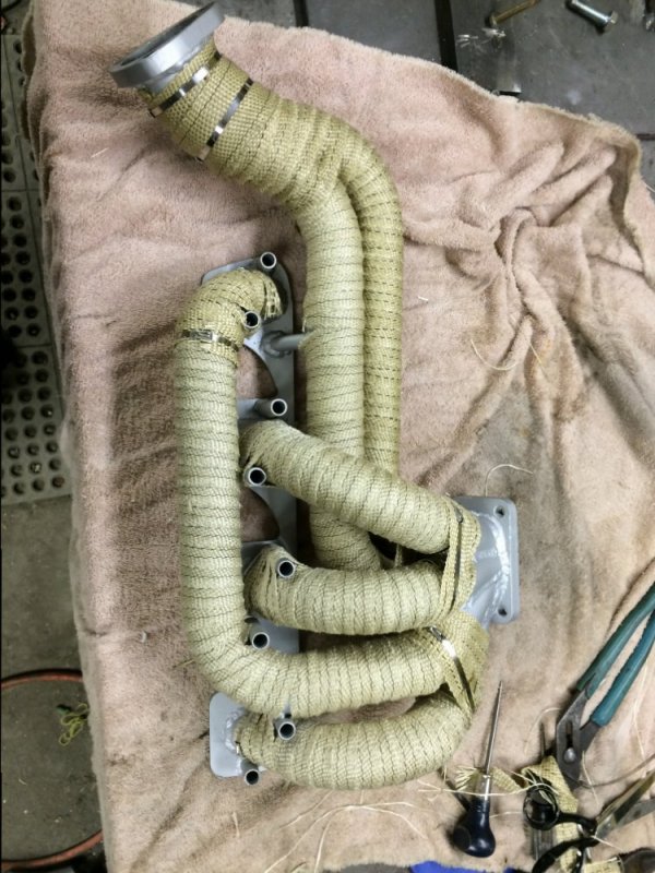

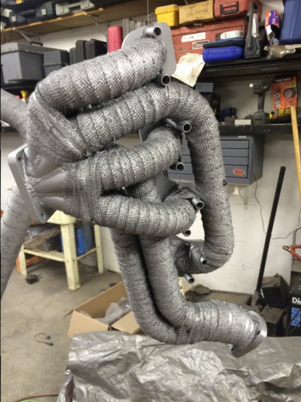

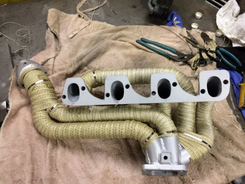

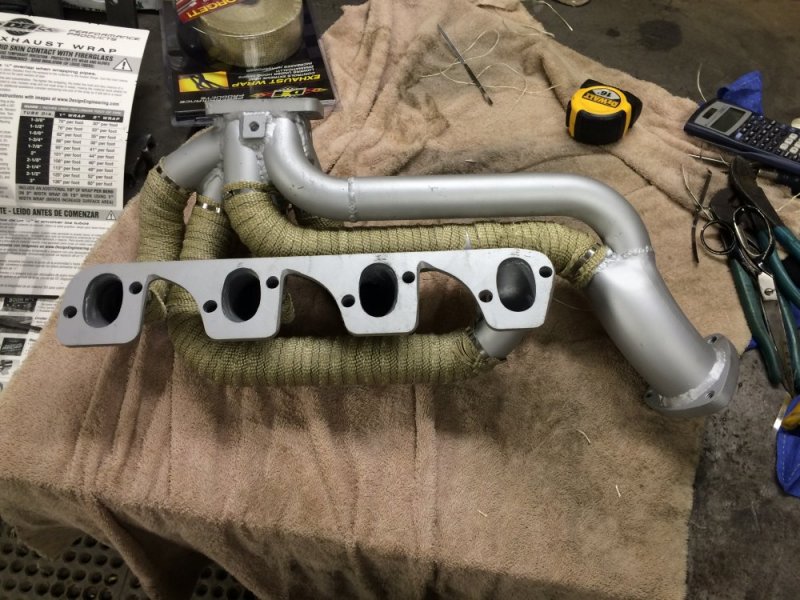

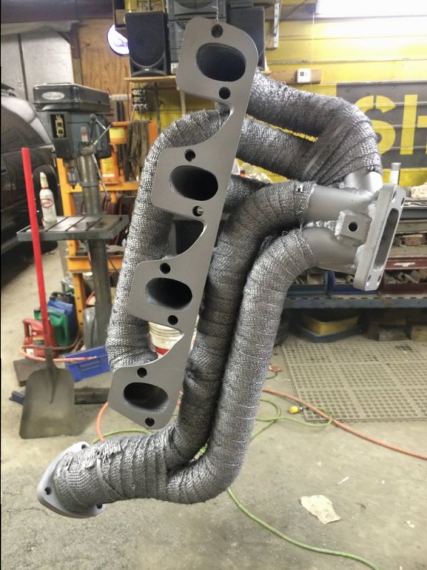

I finished wrapping the header tonight. I tried to cover the very ends but I couldn't get it to turn out as well as the rest. Hopefully it stays in place. I also painted the crossover. I think I'll put another coat on tomorrow night and then I'll put a coat on the header too. image.jpegimage.jpegimage.jpeg
Looking really good Nate. I like the way they turned out. I never realized keeping heat in the headers made that big of a difference with turbo spool.
