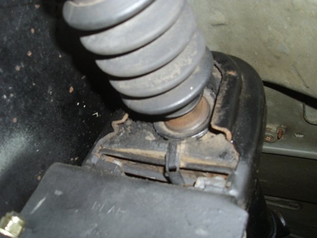

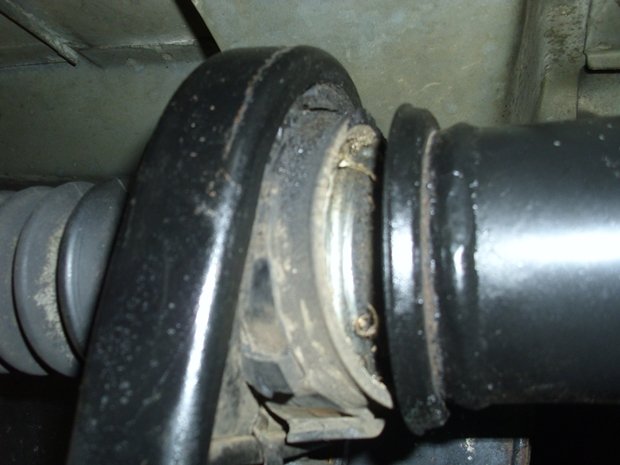

Well, I blew the center bearing out of its bracket I suspect the spline section is binding the rubber was weak time for a ploy unit.
Center bearings are annoying, but thank goodness it is like a built in driveline safety loop.
Depending how many miles and how empty the wallet is, center bearing time is when I like to take entire drive line (s) to a driveline shop, and do a rebuild and balance. The drivline shops usually do enough volume in parts that they sell them same range as parts houses. And having them do all the ujoints at once and balanced at same time tends to get you a discount that offsets most labor of them changing ujoints.
That is, unless your favorite thing to donis carrier bearing replacement. I dont want to take away your fun. Even if you want that done yourself, I still recommend balaning at that point.
A before picture regarding timing connecions is always nice. Some guys will stamp 2 ajoining ujoint ears like you do piston rods...
My shafts are clearly marked so no problems arise, I removed the driveshafts laid them out on a work bench and determined rubber fatigue was part of the problem but the splines section seems to be a bit tight on the slide so I'm going to use nano lube particles mixed into AMSOIL synthetic grease on it and install a new style solid polyurethane body center bearing assembly.
