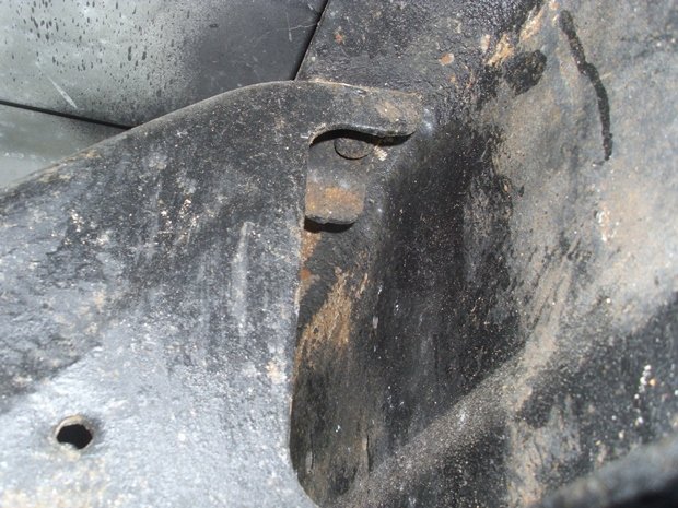

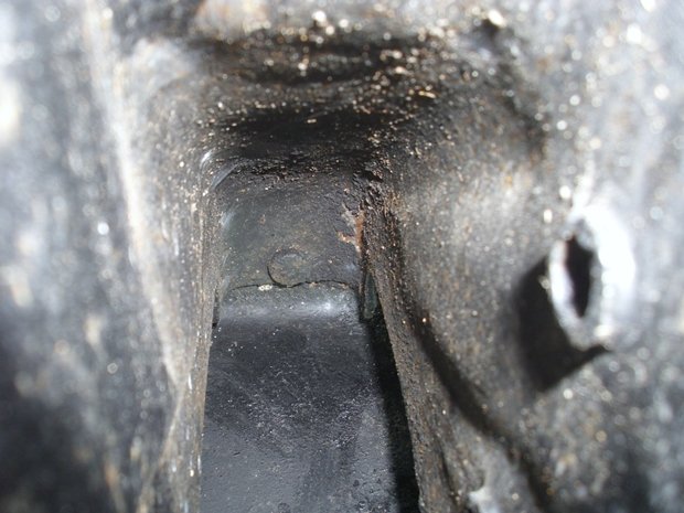

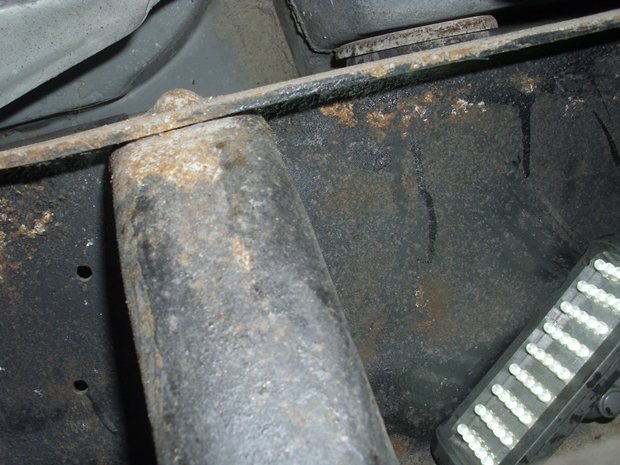

I do have a question for you pros; I have to remove the upper rivets 'one on each side' lowers are not the problem on the x-member that is right after the torsion bar x-member so I can remove the transmission w/t-case as a unit as opposed to installing the transmission w/o the case then fighting to install the t-case. SEE attached images of the tight area I have to work with "I need to somehow remove the bottom of the rivets so I can beat them up and out otherwise I'll need to lift the body off the chassis something I'm not equipped to do.
I like both above answers. Would just add
I have had to heat and slightly bend the long air hammer bits in the past. Remember the longer the bit, and/or the more the bend, both loose hammering power.
if you can’t reach your drill in there you can get a bit extension, drop down from the top through the lower rivet hole, then attatch to drill. Or weld roundstock to the drillbit making it longer, but you’ll have to enlarge the lower hole to clear the welded joint.
I wish mag drills were cheap...
The approach to the lower part of the top 3/8" diameter rivets is angled so I'm thinking a long punch to indent it then have at it w/3/8" cobolt bit then hammer the hell out of it up and out however; the rivets expand in the hole as they are pressed from both ends....so I think it will need to drilled all the way through from bottom which will give an angled hole......man a lift would be handy right about now.
