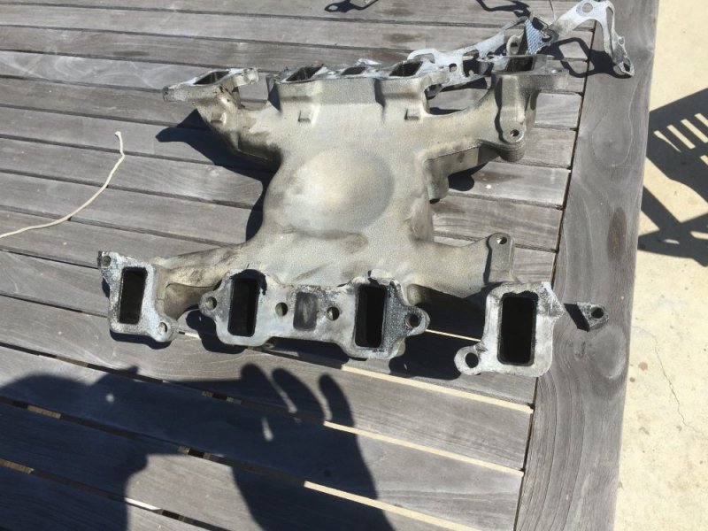

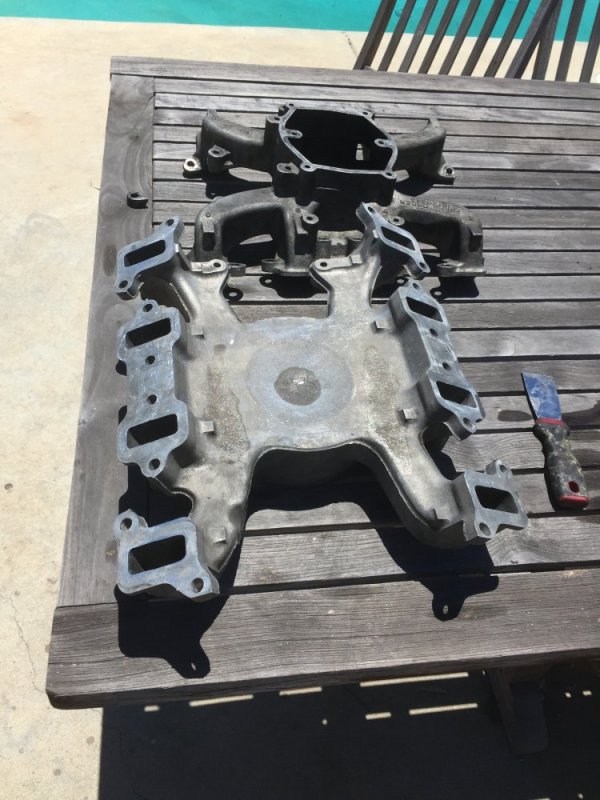

So after a couple trips up to Big Bear, the boost pressure would top out at 11 to 12 psi and I still had the hissing sound. I suspect leak on intake manifold and decided to pull it and install new gaskets. When I pulled it, I discovered that it broke at the front passenger side bolt (see pics).
Is this repairable?
Should I swap in the manifold from the '95 engine?

Yep. And I did it again with the new one at the same spot. Got the manifold pressure wire under it and cracked it as I torqued it down. My near vision is just crap anymore. I went all over it as I was putting it in and still missed it.
Anyone got a manifold they want to sell?
If you can find a good deal, then replace it. Otherwise find a shop near you that can tig weld aluminum. Very fixable to a decent welder. I dont have a tig welder unfortunately.
DO NOT try cleaning with any degreaser or anything. Let the welder use his stuff to clean it.
I hear you, I can TIG anything but AL. Don't have High Frequency or Helium. There should be a shop with one or the other.
I have a guy who can TIG aluminum.
I just test ran it and got rid of the hiss under boost. No more more hissy bitch. Next weekend = fence work on Fullerton property.
