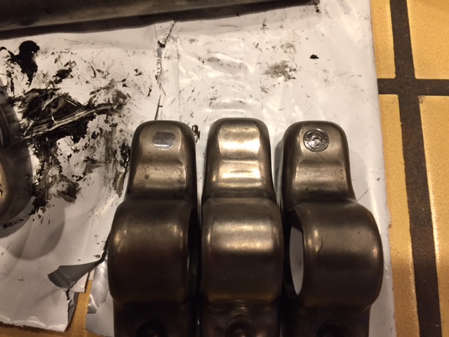

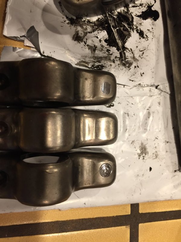

OK the second valve rocker arrived. Attached pic shows the following:
Left = regular wear that leaves a shine spot.
Middle = brand new rocker.
Right = rocker with some abnormal wear. Valve stem punching into rocker.
Engine has 210K miles. That the valve was punching into the rocker leads me to believe that there was too much play or slop there.

I liked the 'normal wear,' new, and 'abnormal wear' picture you sent me today. I'm reposting the picture with the orientation changed to horizontal. Hope you don't mind.
Kinda reminded me of Young Frankenstein with Marty Feldman Brain shopping, Normal, New, A B Normal.... Sorry, long day, no sleep last night.
That really made things obvious. Glad you caught it and the cost was as low as it was, money wise. Sure takes a lot of time waiting on parts now and again.

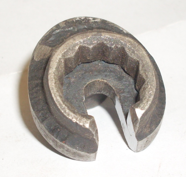

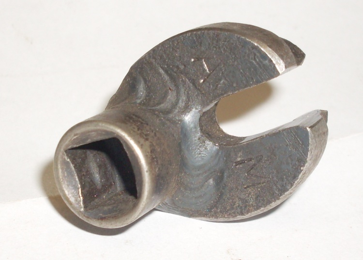

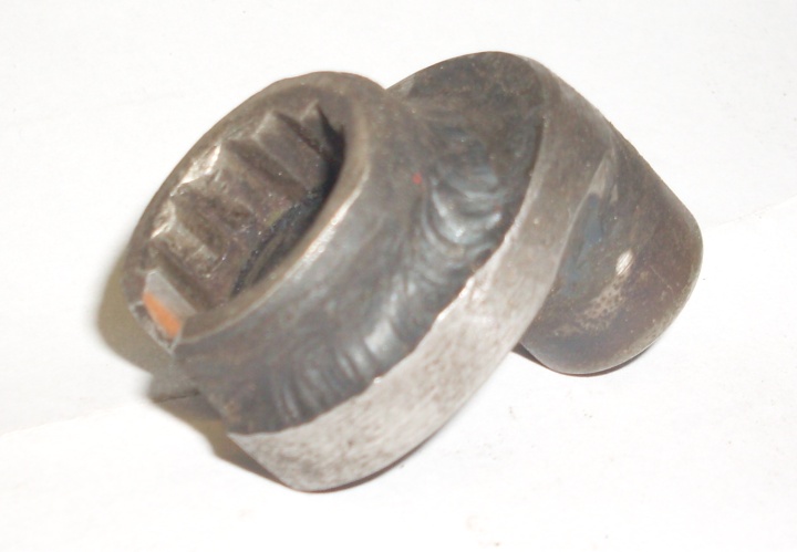

FWIW, To get at the injection lines, I have a sacrificial box end wrench (12pt) with a gap cut out of it to allow it to go over the lines.
I made a special socket for the lower lines:
Use(d) mine on my 6.2 engine, I suppose there's about as much room (or lack of) on 6.5 deez motors, , ,
It works really well, , ,
-corne-
