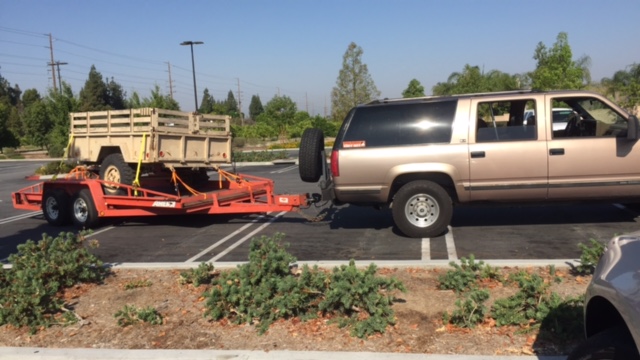

Son and I went to rescue the trailer on Saturday. I asked him how he had cured the turbo noise from his ATT and he said it took gobs of Permatex to seal up the Leroy intake and then the sound went away. After installing and removing the intake 3x, plus getting some coolant on the drivers side gasket and having piece of paper fall off the metal portion of the gasket, I am pretty certain that there's a leak on the driver's side lower intake manifold. So I'm ordering new gaskets.
