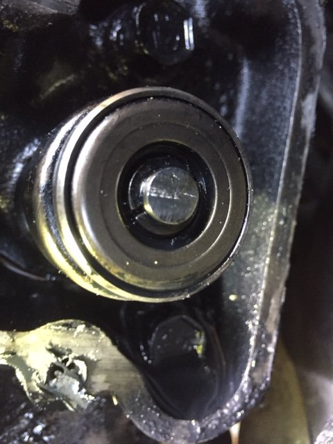

Can you do a pic more from the side to show height of valve stem from retainers?
From the 1st pic the valve seems ok to run.
3rd option hit me- sticking valve. Was it popping or missing? I know, once I post this I'll go back and read about it on 2nd post, huh?
Here's a close up of the specific valve from the top. I'll go out and get one from the side. Doing this out back, so it's a bit of a hike. I did get the button out of the exhaust. It went past the joint from the down pipe to the exhaust.

Lay a straight edge across the top of the valve stems. If it doesn't seem to have much wear then I'd just do rockers. Might be a good time to upgrade to the HS rockers as they would help with wear
The right side in the pic looks flared over a little. I would just clean it up with a file and run the valve. It hasn't worn enough to loose much throw, or to allow a rocker arm to strike the retainers releasing the valve.

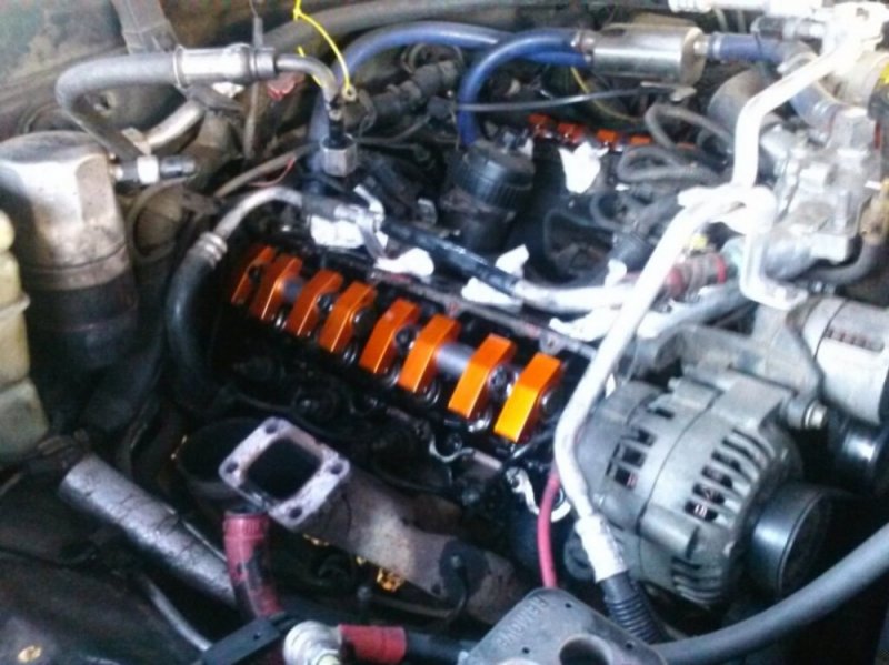

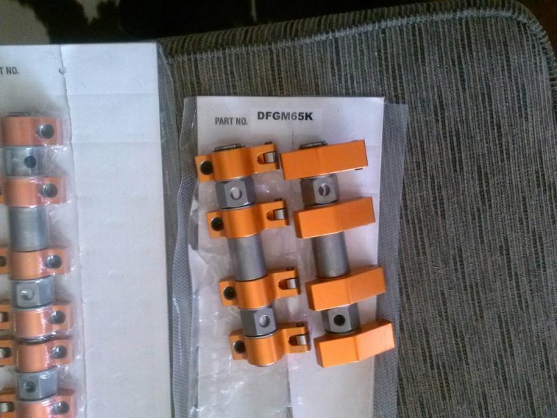

Ya know, Leroy has those fancy Harland Sharp rollers... Then I'm still waiting for somebody to use them and add these:
I don't see any oil in that show.
$600 for a set of HS rollers is a bit spendy for this engine with 210K miles on it. I could justify that on a new P400. I will see if NAPA has a the rocker. If not, then it's RA.

It looks like a little of lack of oil, valve chatter, and maybe too tight... but the valve is harder than the rocker also..

My suggestion, use a diamond hone stick like you use for sharpening knives with to take that burr off the side of the valve stem tip and to put a slight chamfer around the edge.

I ordered the Rocker from RA yesterday and it arrived today via standard USPS. Unfortunately, I left the rocker arm on cylinders 5 and 6 because I did not want to mix them. When I pulled it, the same right valve on #6 had similar wear. So I had to order another. Had I pulled it yesterday, I'd have both and it would already be back together. Valve cover on passenger side is already on.
