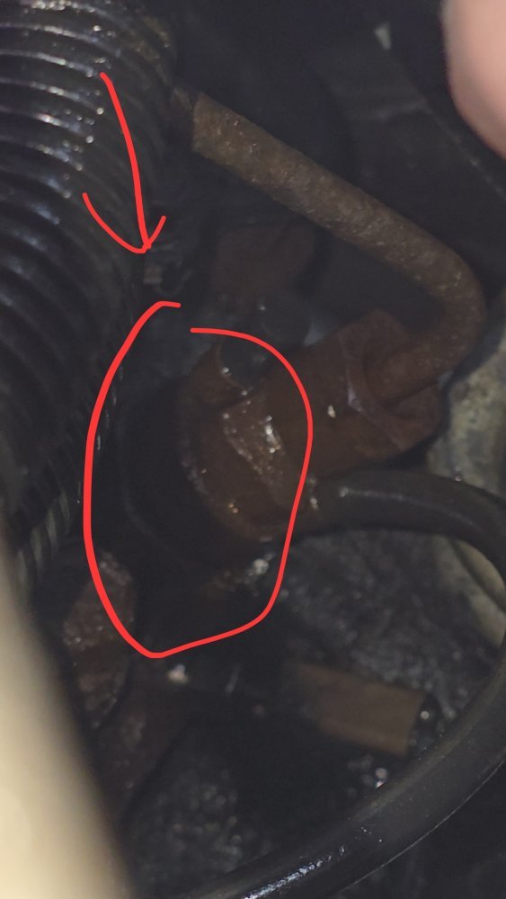

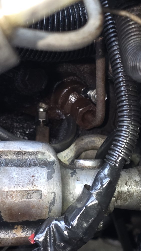

I believe that the BW kits is the push on types of hoses.
If it is a return line, if there is enough length and the hose is broke next to the injector nipple, possible to snip it at the nipple, pull the piece from the nipple and shove the connecting piece over the nipple.
Risk involved, if it splits it could leeeeek worse.
If You can find an open parts store very possible they will have an injector installation kit in stock and them new return connector hoses is in the kit.
Be sure to ask if the hoses are the shove on types or if they have to have the clamps.
Either way, If clamps required, or not, they will be with the kit.
Just a real PIA to get the clamps over the hoses after getting the hoses pushed over the nipples.
Thank you so muchHere is the factory style kit off the jungle site. you won't need the gaskets but the hose and plugs are all pre-cut to length.

Finally made it back, didnt leak as much as I stated, but its great to let it sit overnight as I figure this outWOW! I haven't been on here in a few days and look at all the excitement I missed!!
in a pinch, go to home depot and get the small orangish color clear tubing I forget what size it is but it's in the plumbing section. it will push on without clamps and work for a while.
iirc that much flow from an injector return is saying too much fuel is bypassing one or more of the injectors. you might need a replacement set. when I looked at the smoking on startup that looked just like an injector had leaked down and flooded one of the cylinders overnight, not enough to cause hydro-lock, but enough to foul it out on warm-up. how cold was it out there? the outside temp has a lot to do with hard starts and GP run time before cranking.

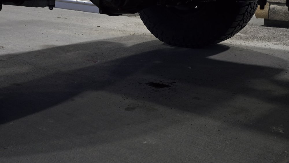

on the oil leak, you need to pull the fan shroud out and inspect everything good. clean it all up and run it without the shroud for a bit (not on the road as it could overheat) and look for any signs of a leak. it might not be the line but the built in oil cooler leaking from an external source like where a weld is or maybe the radiator is under stress in the mounts that could cause a crack over time.

You got the clear hose on the return pipe, off the injection pump ?
