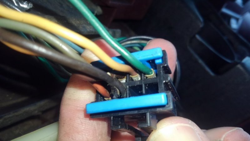

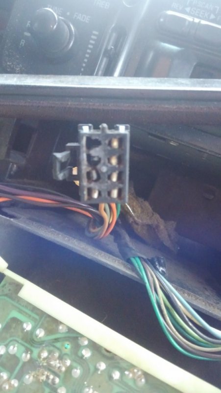

does that connector plug directly to the blower switch or into another plug harness going to the ac controls. mine has a harness with two connectors similar to that inline and then another on the blower switch.

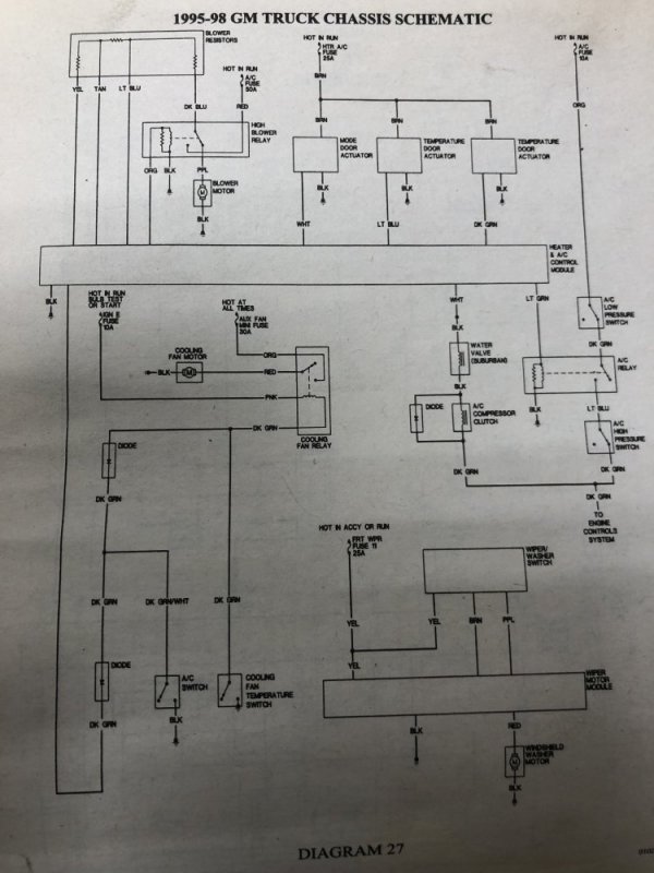

here is a diagram @Stoney for the 1995 model I have in my archive collection. I had to compress it to a zip file in order the post it here. I also sent it to your email in a normal pdf if it will help you in any way. I think for the most part it should be the same for your truck other than some of the PCM stuff. the body wiring should be the same.
