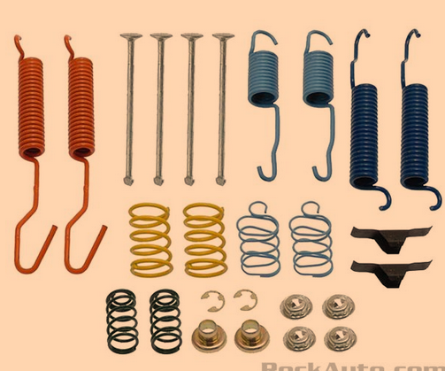

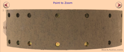

on the shoes, your's is most likely the 3 1/2" wide ones. if you drive to Carquest, try to get the riveted ones not the glued shoes. you'll also need to pickup a spring kit for the rear
